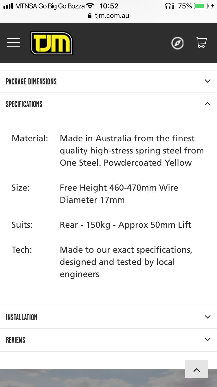

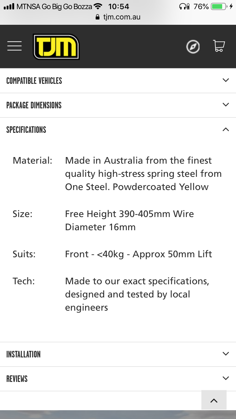

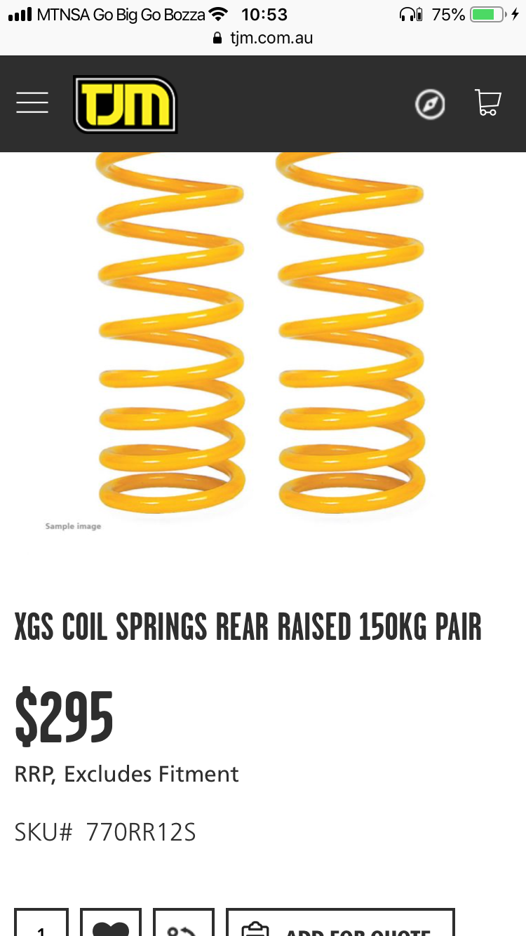

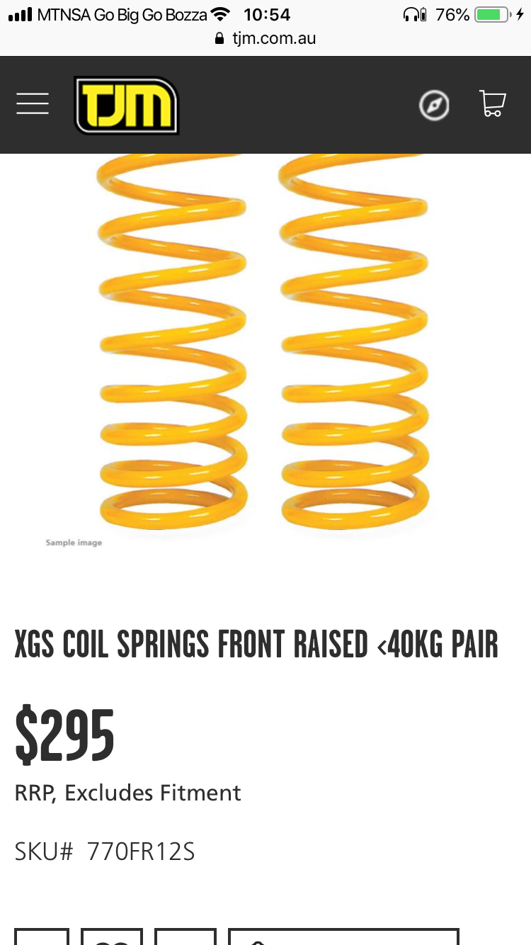

I see my suspension (tjm gold) is suppose to be 50m lift.
So then 33x12.5r15 would fit comfortably?
(Would prefer 33x10.5r15 not much options available though).
Still got the invoice for the suspension which was installed 40 something k kms ago...googled the part numbers....
