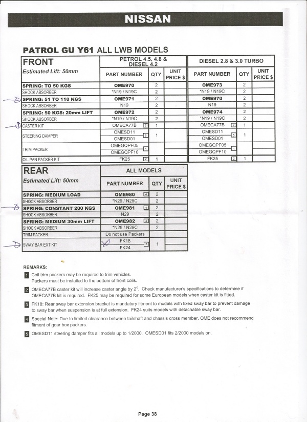

Hier's die tabel met al die specs op die OME kits :DJohnBoyZA wrote:I think the only downside of the heavy duty is, if I remember correctly, that the lift is then considerably less than 2in. :?by ChristoSlang » Thu Apr 09, 2009 6:32 am
My Patrol has the "heavy duty" OME set (971 and 981). The rear set is rated for a constant additional 200kg and the front for 51-110kg. Even so, they are very compliant and the ride is not hard at all...

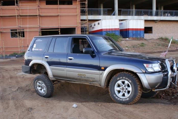

OME is bullet proof and unbeatable!!
Go and have a look at what the guides and operators use on their 4x4's. OME. all the guys that go for serious off roading use OME. The Ironman kit is just not up to it. I am very impressed by my OME. Absolutely brilliant and the ride is unbeatable. IT goes where other suspensions really battle and the level of comfort is way more than anything else I've experienced.

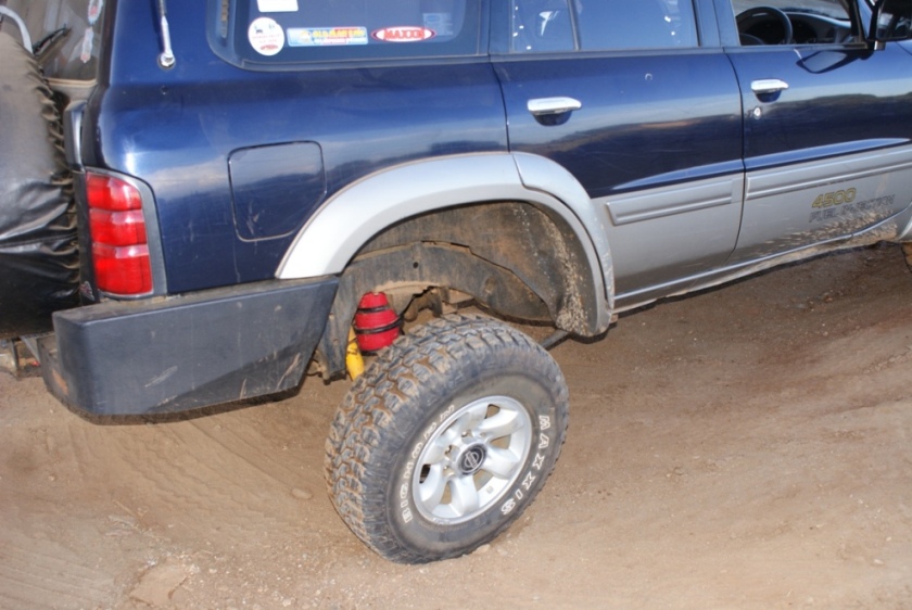

- Airlift.01.JPG (177.96 KiB) Viewed 13667 times
- Airlift.03.JPG (199.5 KiB) Viewed 13666 times

Nice flex, Tjaart
Are your anti-roll bars still connected or have you fitted disconnects/removed them?
Oh and by the way. It looks like you need rock sliders

Two more questions, Tjaart:
What size are those Bighorns?
Are your air helper springs cross-linked or isolated from one another?

Dankie manne
Ja Rock sliders is op die wish list, maar ek sukkel om iemand te kry wat sterk genoeg sliders kan bou. Die patrol is swaar, soos julle weet. Die wat ek op gehad het, het onder die deur ingebuig, en die ander duike is rotse waar ek oor is in die Olifants rivier. Was nie baie snaaks nie, maar dis dit of verdrink!!
My Airlift is independant gekoppel, elkeen op sy eie. Deon by Canyon Ridge in Pietersburg het my verduidelik dat: As die twee saam gekoppel was en jou 4x4 swaar gelaai was en jou om 'n draai gaan of baie articulate, die lug van een na die ander sak gedruk sou word. Dit sou veroorsaak dat jy die "lift" in die een sak sou verloor, wat die doel van die sak nul maak. Die verduideliking maak sin, en ek is baie tevrede met die installasie. Dit werk baie goed,
en dit afekteer nie my artikulasie nie, en verhoog my dra vermoe. Die kar voel baie meer stewig en vas op sy voete onder vrag in die veld.Rerig die geld werd....
Ek het nog steeds my anti roll bar aan / in. Wat kan mens maak? Is dit veilig om hom te verwyder? kan mens hom so modify dat jy hom kan afhaal en aansit soos jy wil? Wat is die gevare/ voordele om die anti roll bar te verwyder? Sy naam klink nogal baei belangrik, ne?
Ek is mal oor my Maxxis Bighorns. Hulle verskriklik taai en kklou ongelooflik goed. Hulle is absoluut modder se baas. Hulle skop verskriklik gat in modder. Ook baie goed op klip, en hanteer sand ook baie goed. Hulle het moer hard gewerk die afgelope jaar. 20K km waarvan 60% off road en baie erge roetes was. Hulle is ook nie bang vir dorings nie. Ek het een snytjie op die side wall gekry toe ek om 'n draai kom en 'n moerse klip in die pad tref,
. As ek sou uitswaai, was ek in die kloof in....
Die band grootte is 275/70/R16. Ek kyk om een groter te gaan, 285/75/R16. Hulle is egter redelik duur. Ten spyte van die feit dat ek mal is oor Bighorns, sal ek volgende keer eerder 'n meer pad ge-orienteerde band oorweeg, aangesien ons terug trek Pretoria toe aaan die einde van die jaar. Ek is tans betrokke by die Wereld Beker Sokker Stadion in Pietersburg, en sal daarna huis toe kom. Die bandman se vir my dat mens brandstof verbruik verswak met 'n groter band. Is dit waar en hoeveel? Ek kry nou so 5.6km/L. Ek het dit gemeet met bietjie ooppad, grond en off road gekombineer en ek is heel tevrede. Hoe sal 'n 285/75/R16 dit beinvloed.
Ja kyk, die Patrol het al gewerk en ons was plekke waar bitter mense ooit kom. Hier is baie mooi plekke in berge hier naby Pietersburg. Gaan dit baie mis. Maar ek sien uit om aan te sluit by die Nissan 4x4 klub, en al die events by te woon in en om Gauteng.
Daar is eintlik net een 4x4....

Hi Tjaart
Thanks for all the info!
Some more clarification please:
1. What make are your air helper springs?
2. What pressure do you run them when not loaded? Can I assume that the car was unladen in the photograph where you stated that the articulation is not effected .
3. And how is the articulation affected when loaded and the airhelpers under pressure? BTW,what is the max pressure that one can inflate them to?
4. Who made that rear bumper? If commercial, please reveal manufacturer!
5. How do the Bighorns perform on wet tar roads, particularly how do they stop ? BFG A/T's are notorious in the wet ......
6. And finally, noise wise when on tar roads - would you fit them again?
Ja, jy kan disconnects op jou anti-roll bar se vasmaak punte sit, wat beteken jy ontkoppel hulle wanneeer jy pad-af voeter om jou beter artikulasie te gee en jy koppel hulle weer op wanneer jy teerpad slaan sodat hulle hulle naam gestand kan doen om te sorg dat jy by die huis kom ! Gaan kyk wat die Aussies doen op die Patrol forum ...

In antwoord op jou vrae:
1: Die Airlift is Firestones. Ek weet nie wie nog maak nie. Hulle werk baie goed. Sonder vrag 0.5bar. Gelaai pomp ek hulle 1.2 - 1.4bar. Dis meer as genoeg en dan is hulle voldoende om die vrag te dra. Maksimum druk is 4.0bar, maar ek dink dan voel jy of jy met 'n roller ry. BAIE HARD. Die foto is geneem is geneem sonder vrag. Van my ondervinding bly die artikulasie daar, en sal bietjie verswak soos mens swaarder laai en die Airlift stywer pomp. Ek was net verbaas oor hoe goed die voertuig voel off road toe ek die Airlift in gesit het. Baie meer "composed" en ''steady". As ek nou deur 'n dip gaan teen 70km/h+ op 'n grondpad, is daar geen meer geswaai en gewieg nie. Baie vas op sy voete. Ek hoop dit help bietjie. Ek sal dit aanraai vir enige iemand wat ver ry en lang grond pad / trails / off road ry. Dit spaar ook jou shocks en coils. Ek het al so lank L4 gery by 'n berg af, toe ek onder kom en aan die OME shock voel, brand hy my 'n blaas. Swaar gewerk. Met die Airlift werk hulle nie so hard nie. Baie happy met dit. Oorweeg nog om voor ook in te sit...maar die $$$$$$, eish, hy es ta min....
2: Die replacement bumper het ek laat maak by E&o Welding in Louis Trichardt, oppad Messina toe. 100km van Pietersburg af. Hulle maak om te pas. Dit is baie netjies en baie sterk. Ek het al van klip afgeval en op die bumper geland, net 'n klein skrapie gekry. As dit plastiek was, het ek nou nog stukke opgetel! Hulle maak egter nie kommersieel nie. Mens moet jou kar daar los, en dan bou hulle hom daar. Ek vind net dit werk soveel beter. Hulle het my R6500 gevra. Ek dink dis baie billik, want Megaworld se prys was R13700.
Hulle kwoteer my R8500 vir die voorste een!!
!! Maar mamma wil NIKS weet nie.
. Ek moet se, ek het van hulle bumpers voor gesien en dis puik!! BAIE PROFESSIONEEL.
3: My ondervinding met die Bighorns is 110% Hulle sit nie 'n voet verkeerd nie. Dit is rerig outstanding in die veld, sand en modder. Klippe klim is hulle kos. Die Patrol is baie swaar. EK het op die weegbrug by die werk 2800kg geweeg, met 50% toerusting op en 1/2 tenk petrol. So die bande vat houe op die teerpad. Hulle gons lekker op 130km/h, maar dit laat die kindertjies SO lekker slaap. Ek dink egter dat ek nie 60 000km met hulle gaan kry nie, weens die extreme off road wat ek doen nie. Maar, as ek dit nie so hard gery het off road nie, sou hulle beslis langer gehou het. Ek het na 20 000km, sleg 5mm van die tread gebruik. Die nuwe band het 16mm diep tread.
. So as ek myself gedra, wie weet. Maar dan weer: Waar ek ry en wat ek doen, sou bitter min bande kon by hou. Hulle doen baie goed op nat teerpaaie. Dit reen nie baie in die Noorde nie, so as dit reen, gaan soek ons modder en ek is gelukkig met die hantering op teer. Die geraas is daar, maar tit for tat.
