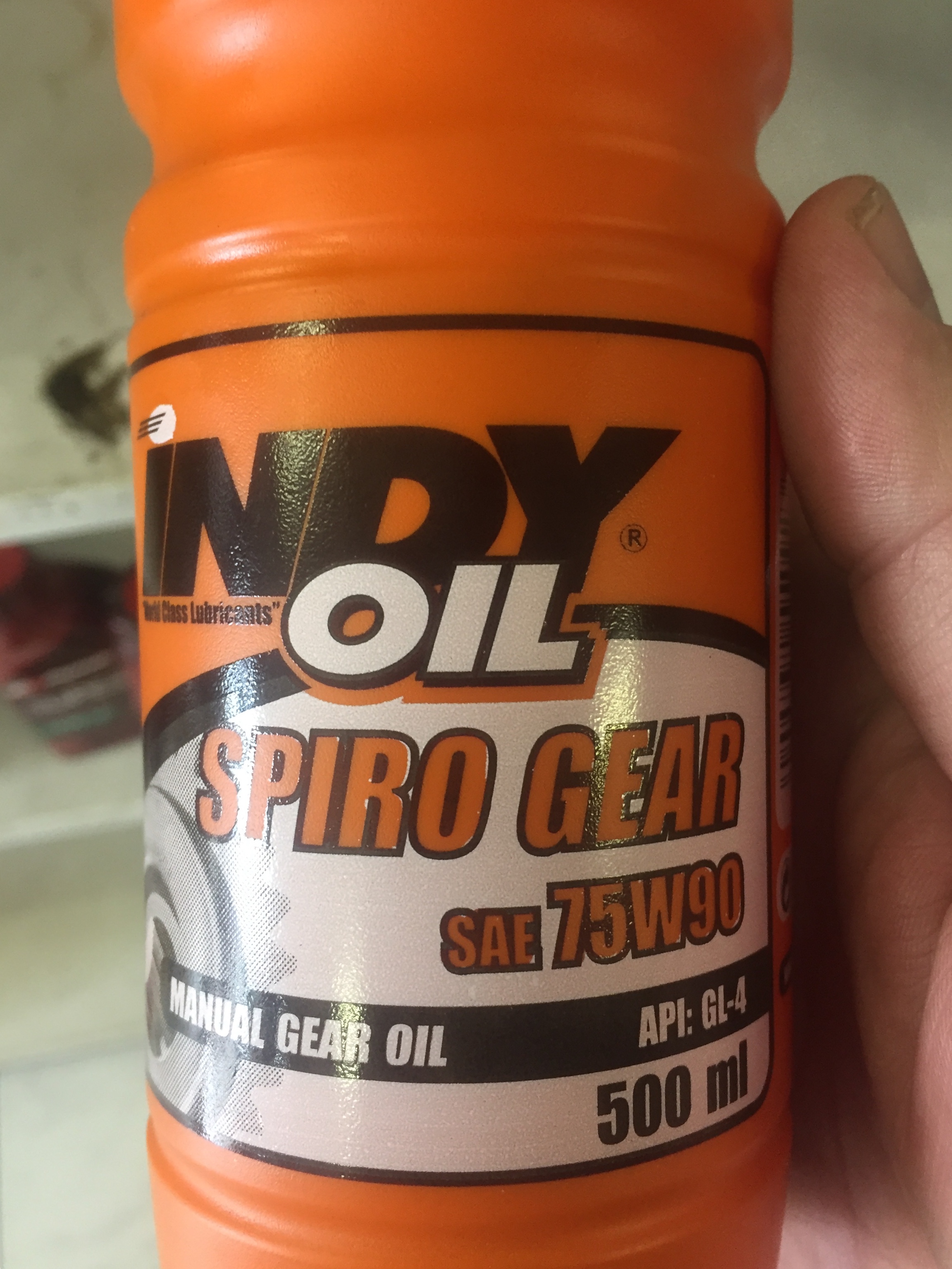

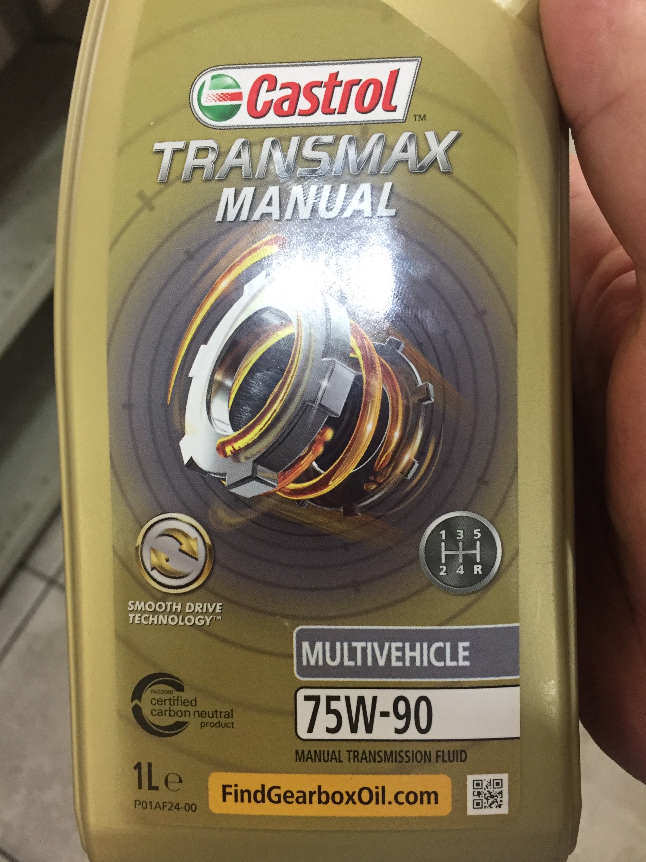

- Posts: 3363
- Full Name: Fanus
- Has thanked: 246 times
- Been thanked: 219 times
Re: Gearbox Oil change
R40 per 500ml - indy oil.
R186 per 1l - castrol transmax
Both 75w90 gl4
Think the castrol must be the better option?
Both 75w90 gl4
