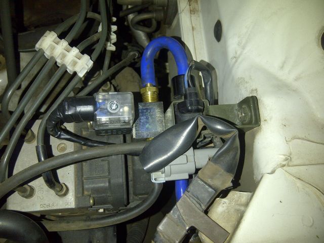

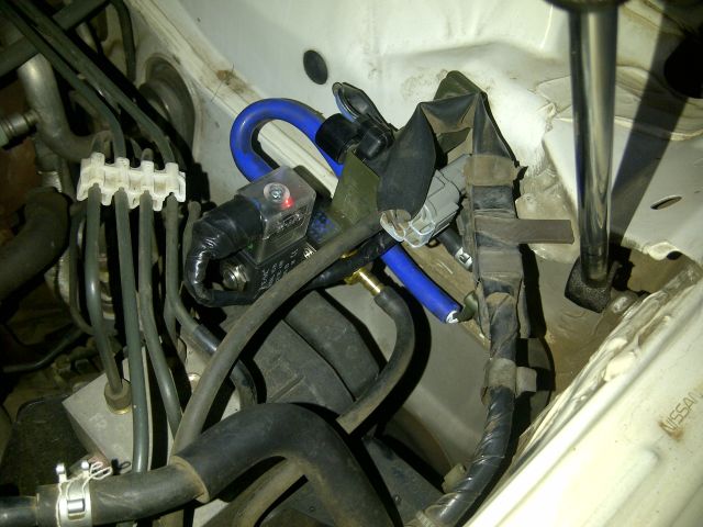

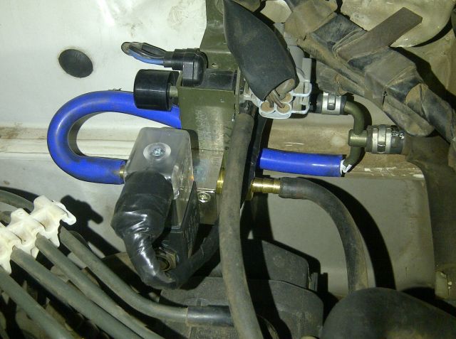

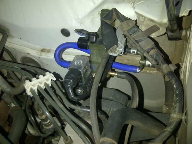

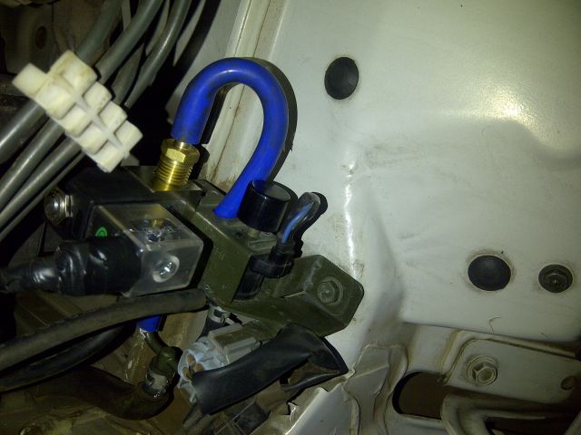

I've done some surfing on the internet and found a place in Alberton that supply solenoids at a reasonable price.
The fittings that they supply is the type where you press the vacuum pipe inside of it.
I took 6mm fittings but it is too small, you need 8mm fittings (outside diameter of the vacuum pipe).
I then got fittings from Media Hydraulics in Pta where the pipe fits over the fitting.
I took the faulty solenoid out of the original holder and fitted the new solenoid with 2 screws on the outside of the holder.
I replaced one of the short vacuum pipes between the solenoid and the Y-junction on the vacuum supply side with a longer pipe.
The pipe from the diff was long enough to reuse.
I paid just under R350.00 for the solenoid and fittings and another R28.00 for Media's fittings.
So far the difflock is working well.
Details for solenoid and supplier:
2/2 way brass solenoid valve ¼” connection with 2mm orifice.
Normally closed 12V. The valve would open if solenoid is activated.
Sonica
Umoya Automation cc
Cell 082 958 1872
Sonica
Umoya Automation cc
Cell 082 958 1872

EISH, dat die man my nie glo sonder fotos nie.
Daar is selfs 'n rooi LED wat wys wanneer dit aan is.
