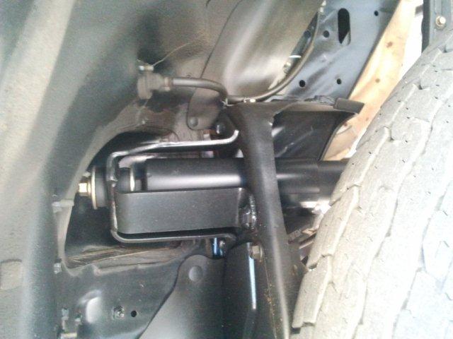

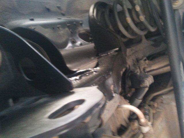

So I had to have a look at another, this time I actually took a test drive. the car did just come back from the panel beaters they said just a scratch on back right wheel arch?
It's an 08 with 77k for 350k. It's service history is not complete. Has 15k, 45k and 60k. Carpets have stains and boot carpet has a missing patch?! One owner. I STRUGGLED to get it into low range. After the 4th attempt it went in and out easier. Discs have barely 0.3mm ridge.

- Front shock is painted

- Why paint this?
