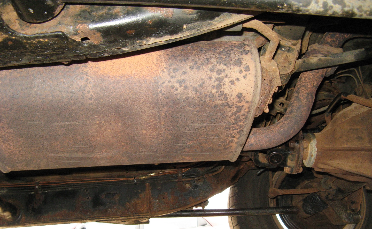

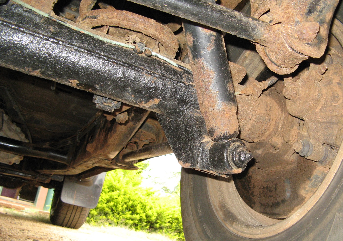

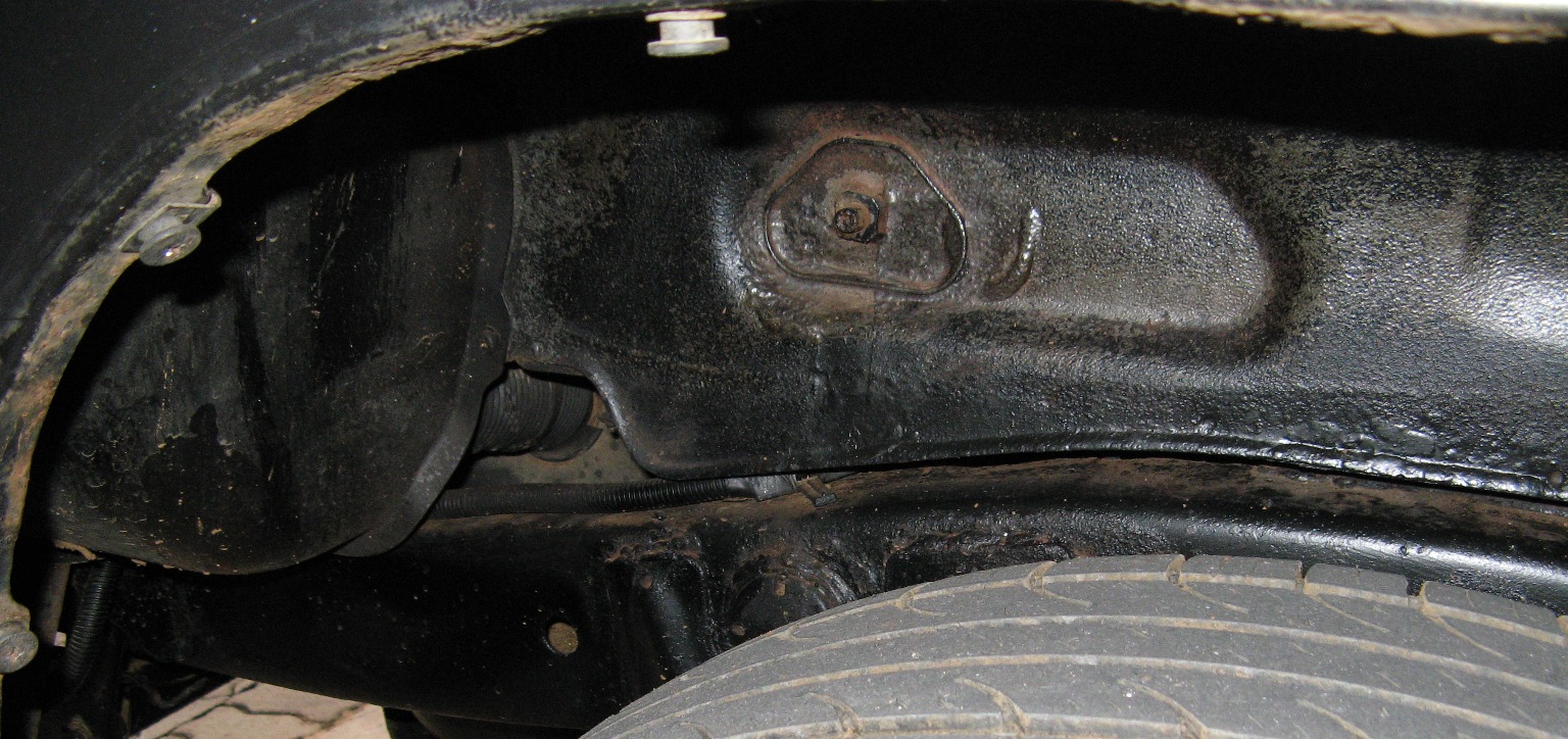

Hi All
Just an update on the rust handling.

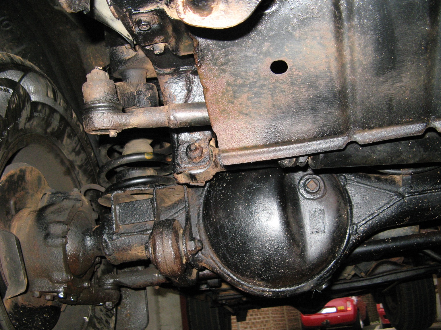

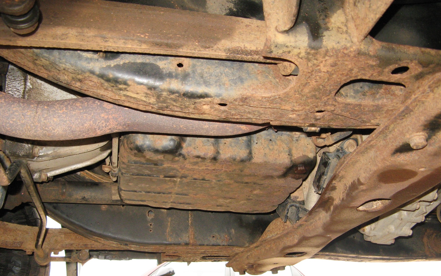

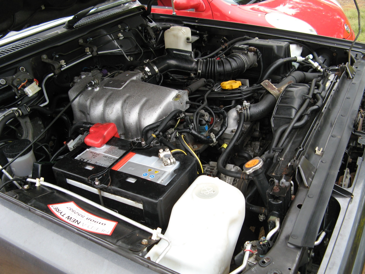

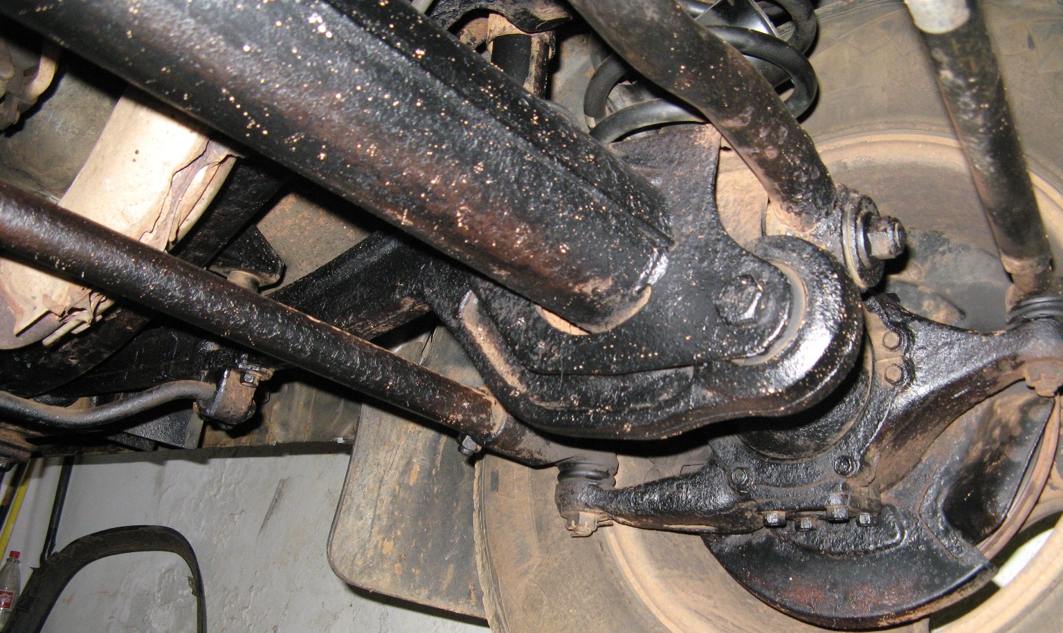

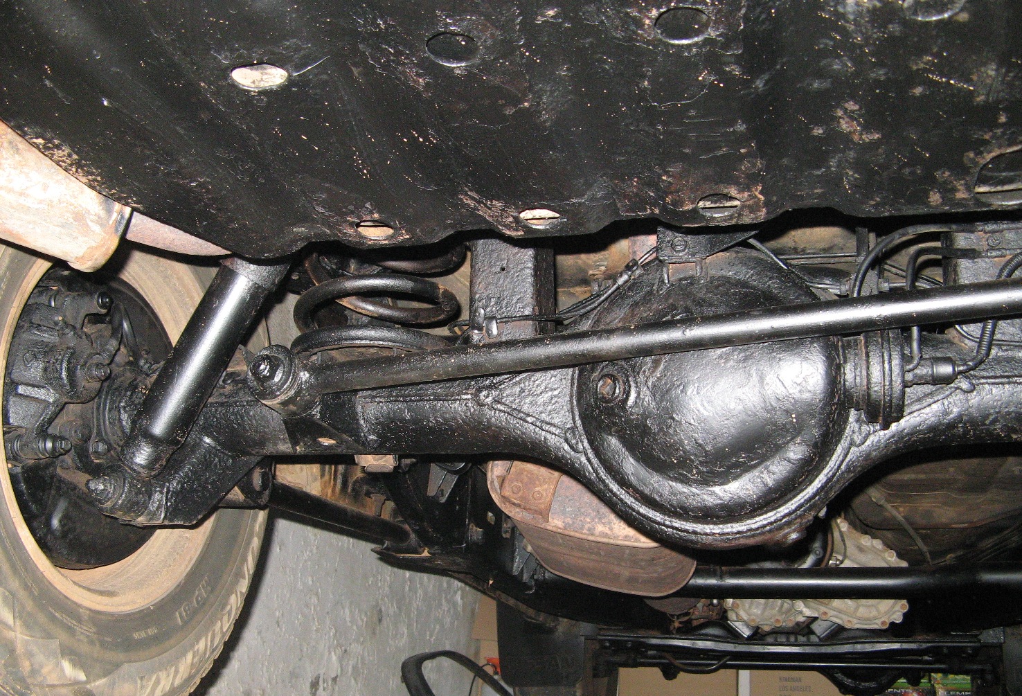

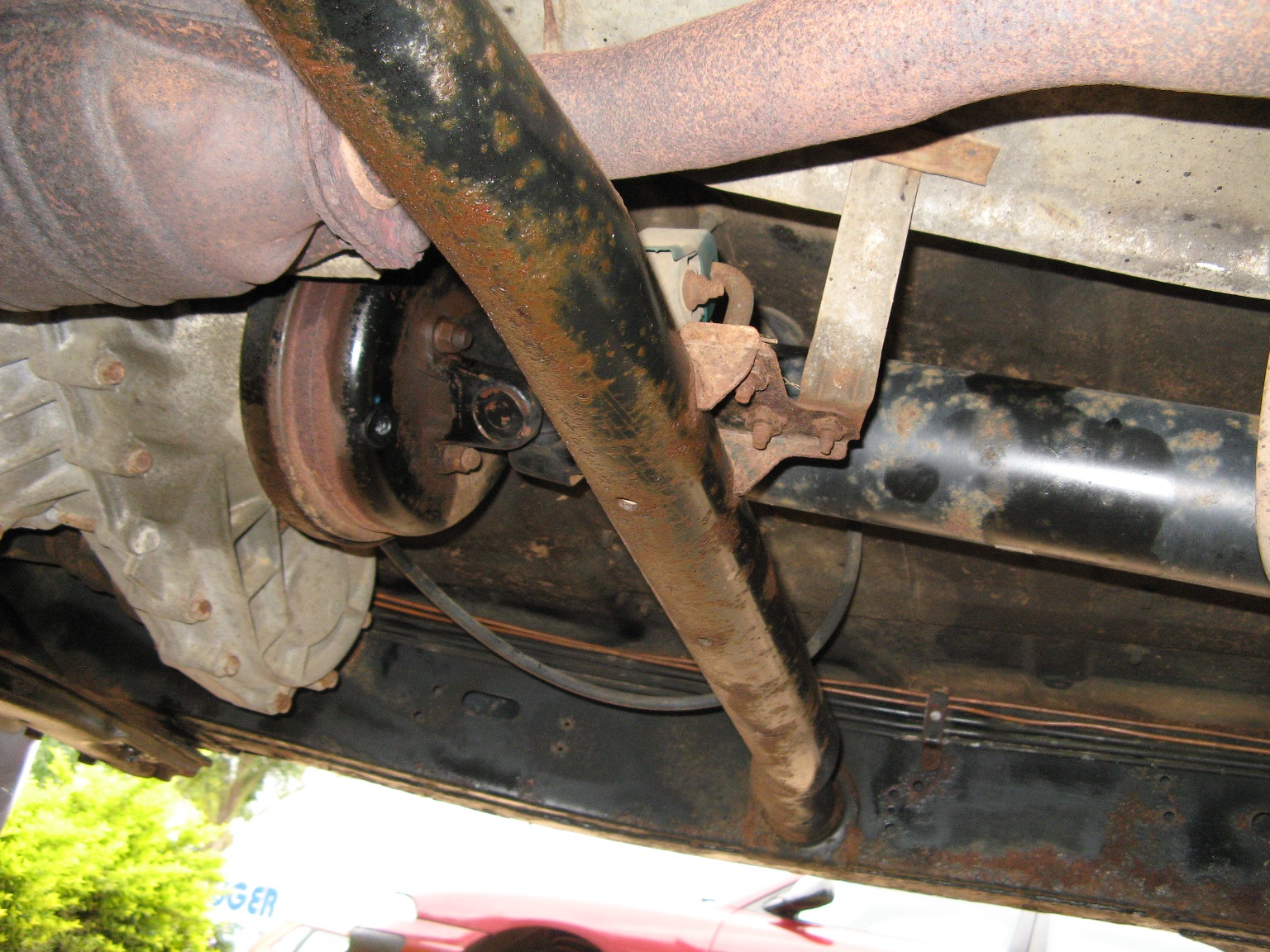

To start, let me first show the engine - the rust is not affecting the engine. Now, the chassis. First the photos BEFORE Pro Tec: Now, after Pro Tec did some work: Not perfect, but a massive improvement I think - especially at R1,300.
Brent (from Pro Tec) recommended that if I have the time to spare and the money, I should do the calvinising later. It is not just surface rust, but the damage is not such that something will break at any time. We'll see how everything holds up with some hectic off-roading.
In the meantime I have fixed the cd shuttle (also rust and a piece of plastic that broke off inside). Next step is are the little steel pipes that go from the front to the back - this I'll have done by some guys in Silverton as well (apparently they are very good with this sort of thing.
Piece-by-piece, it is all coming together.
aDios
Ernst

I am under cars all day, your's looks fine in comparison to most vehicles down here.
Sucks Gas and Hauls Ass!
