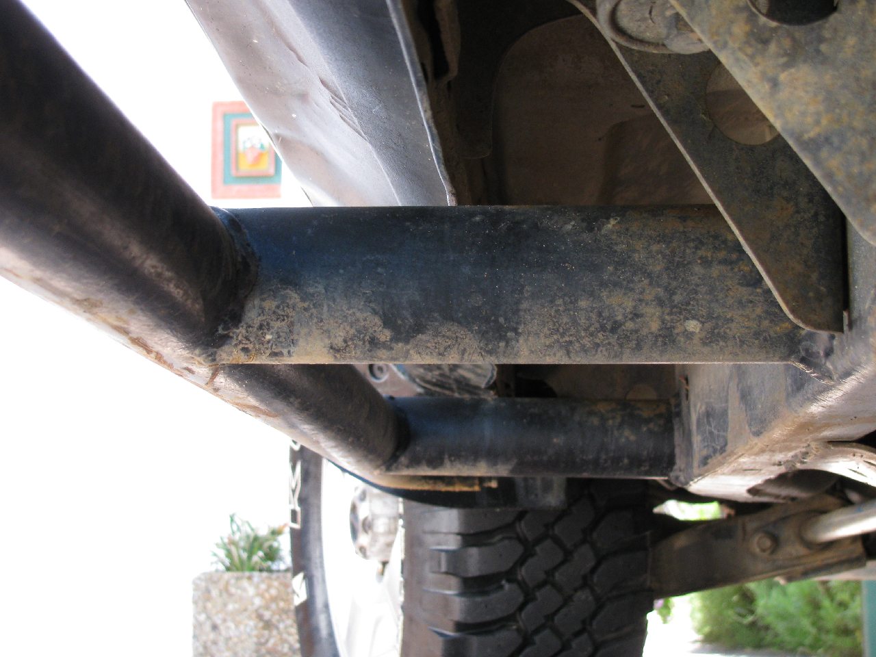

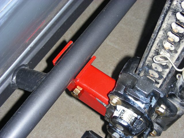

Stefan, not entirely correct. If you look at my hardbody virtually everything is welded onto the chassis. It depends how its welded and where on the chassisStefan wrote:Welding changes the metalurgical structure of the chassis.
is the key here. My offroad bumper is bolted on but the recovery points are welded onto the bumper. The welding is V shaped for extra strength.
I wouldnt consider welding on a R500000 vehicle but on mine, well my rocksliders and rear bumper is welded according to to specs, and i am happy
with that. It is strong, i can lift my vehicle with hi lift on the rockslders. No problems. Remember my engine mountings , leafspring brackets, mountings for torsion bars, all welded onto the chassis.

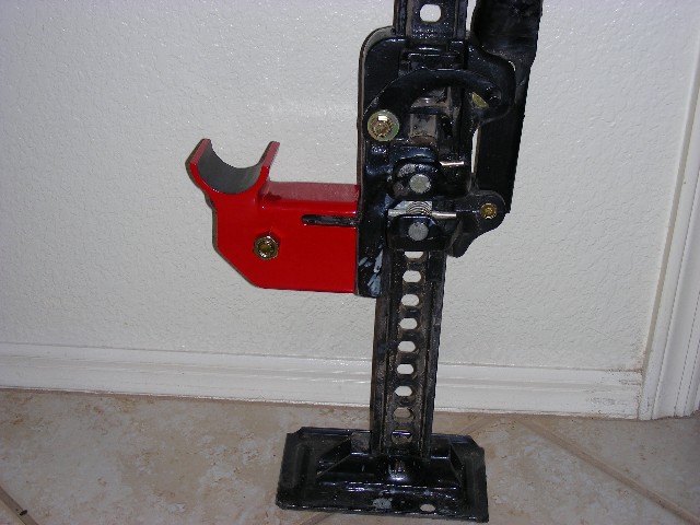

The adaptor like this one was stolen during a service. I only realised a few months later, but you get the picture
