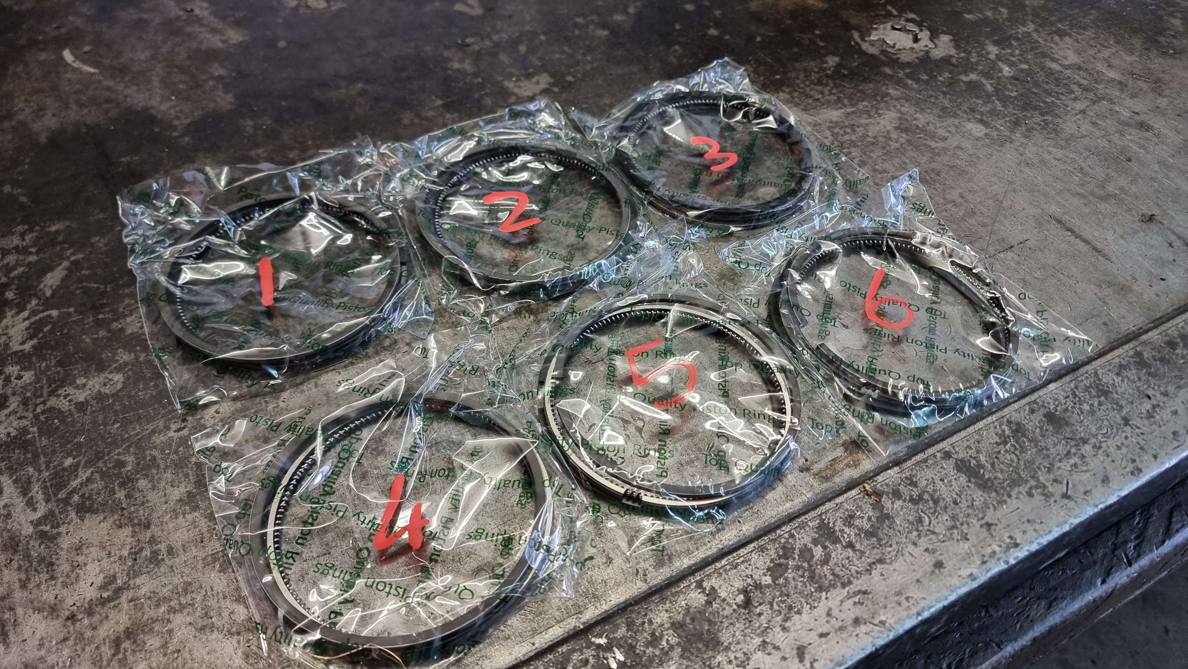

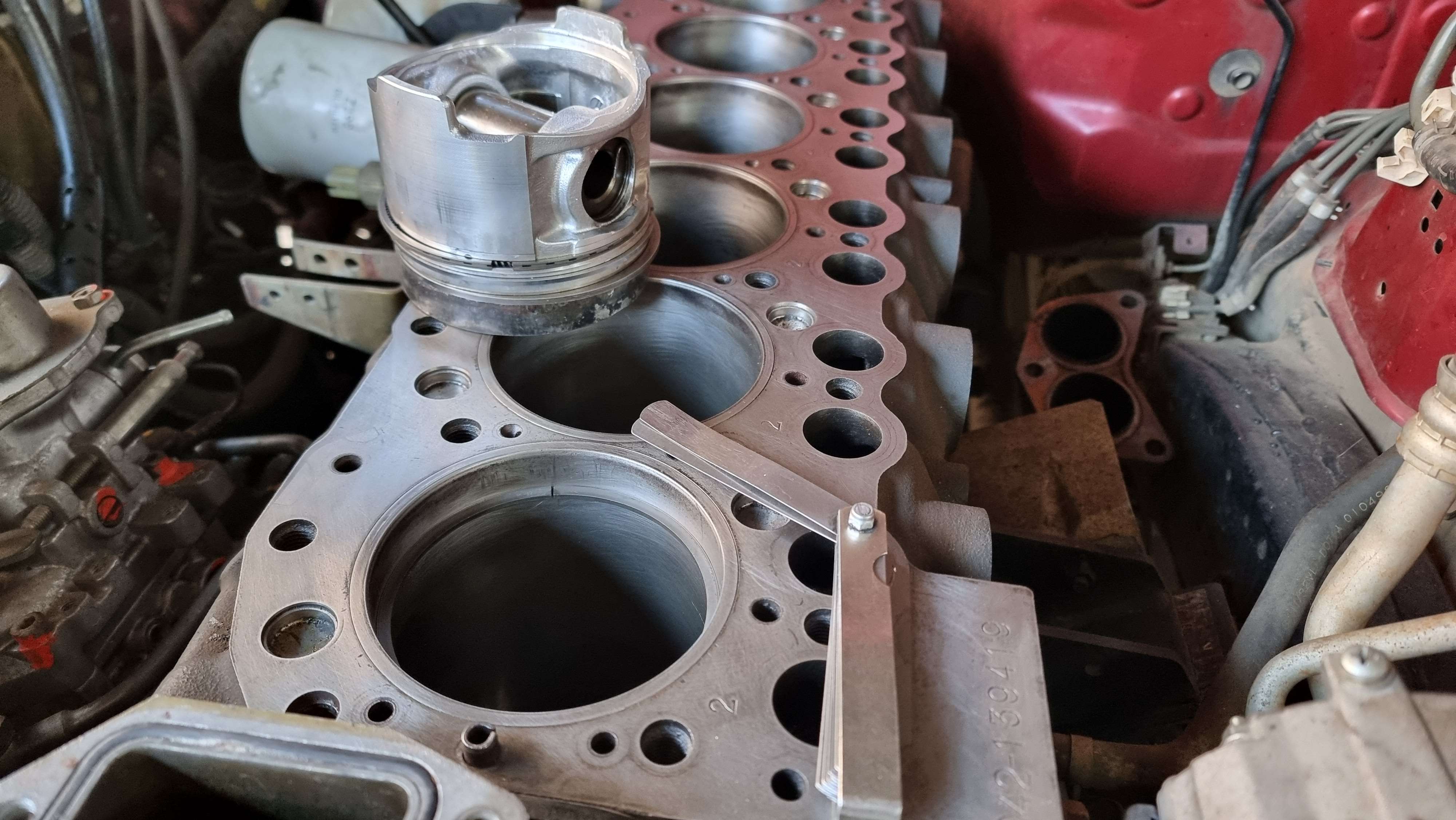

Ok so today is piston and rings day.
Its quite a timely process, but every ring is placed inside the sleeve and the ring end gap is filled to the specification we have found to work best over the years.
The factory spec is too small and we have ran into some problems in the past. We also run the engine with more than double the factory power and for that you have to account for a bit of extra expansion from the rings.
Here I am just using an old piston with rings to press down a ring and measure the end gap.
Finally all the rings done and ready to be installed

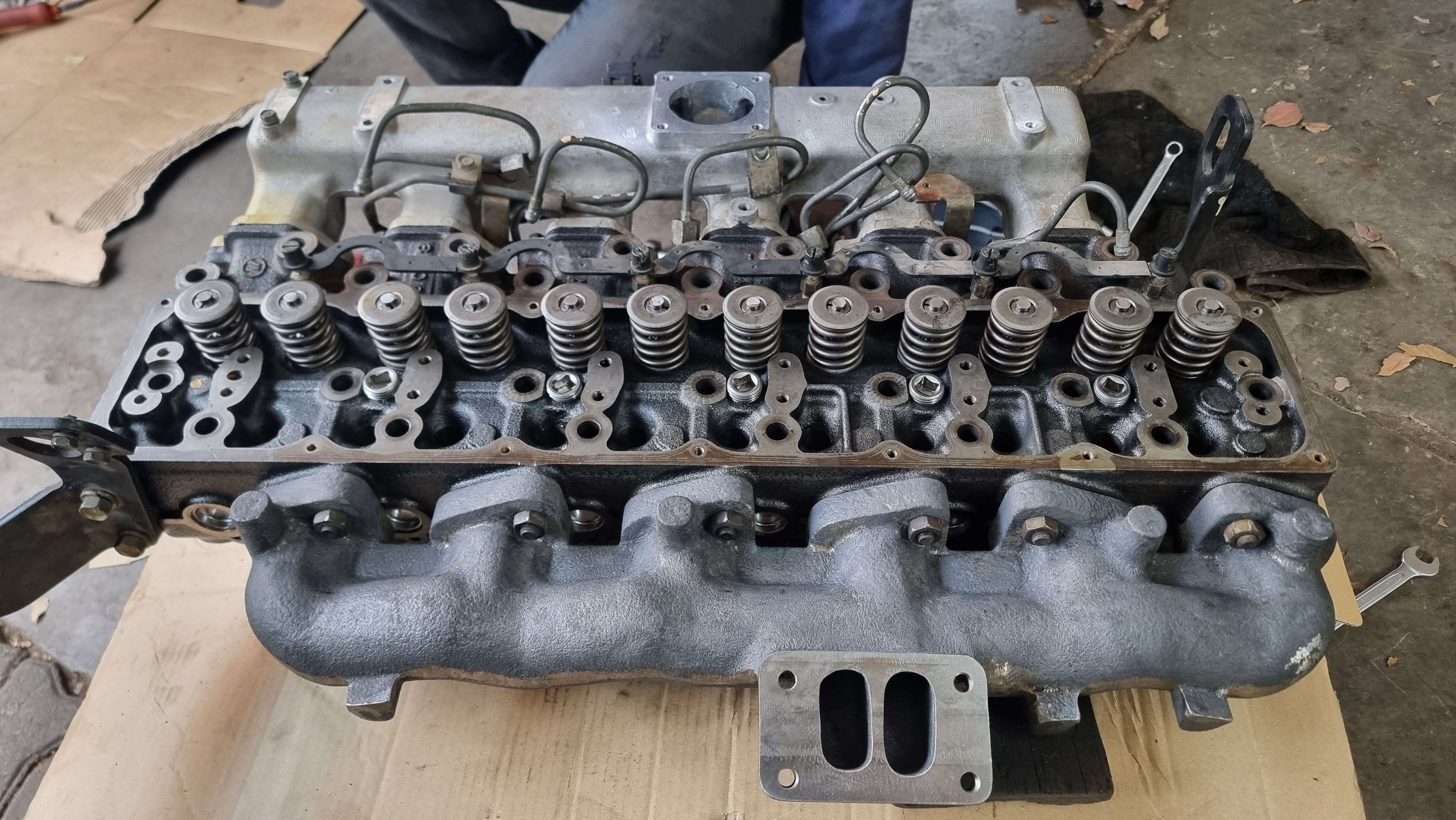

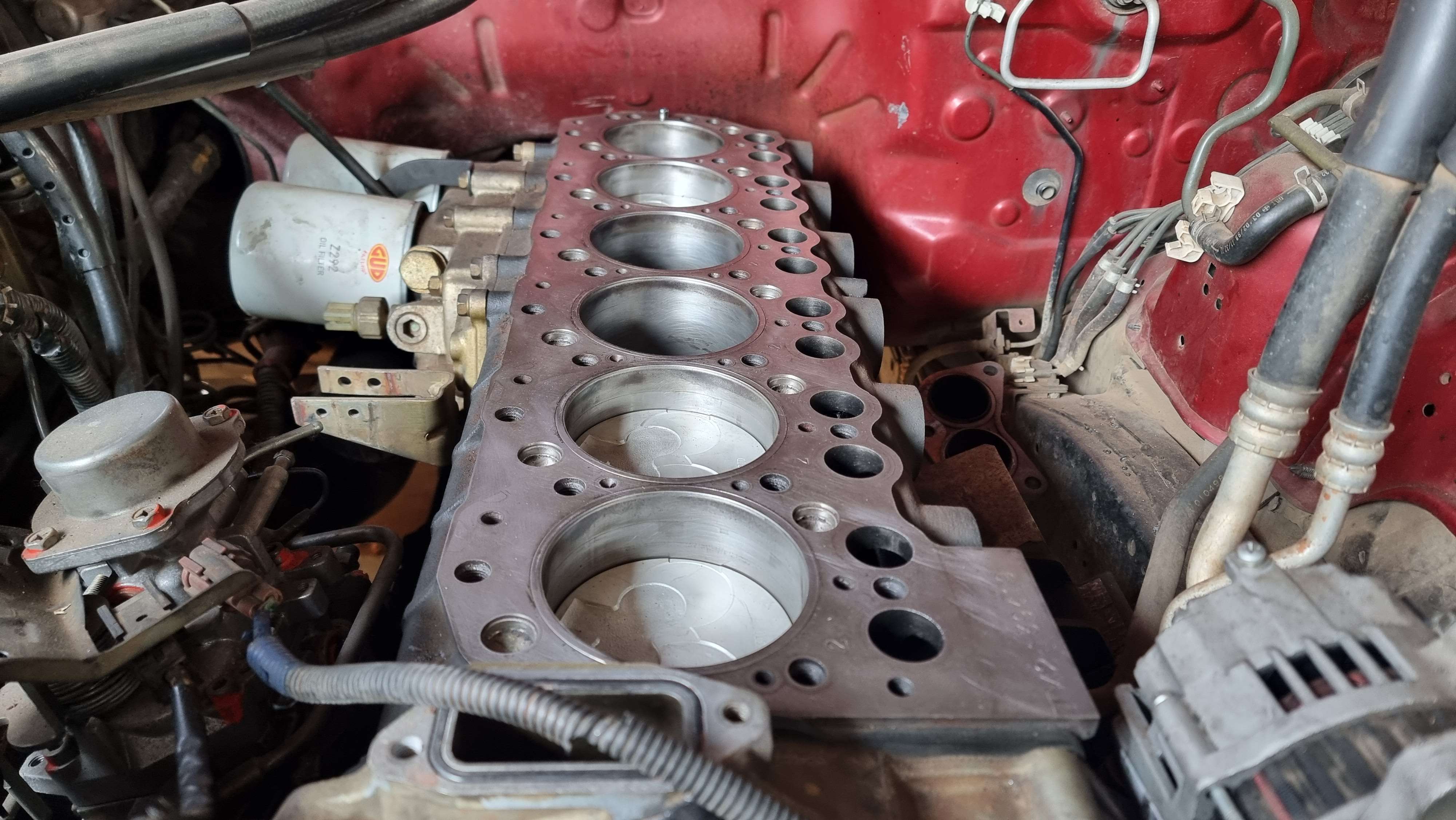

So there has been some other projects that needed a bit of attention, so could not work on this build full time over the last few weeks.
But here is what happened. We have installed the new turbo pistons and everything measures up to spec.
The cylinder head was crack tested and serviced where the valves were again faced and seated and they also received new valve stem seals.
Sump was modified so the turbo oil return pipe could connect to the sump.
We use Nissan gaskets only for the cylinder head gasket and the sump gasket.
Pistons are now in their new home
Head assembled with a top mount turbo manifold

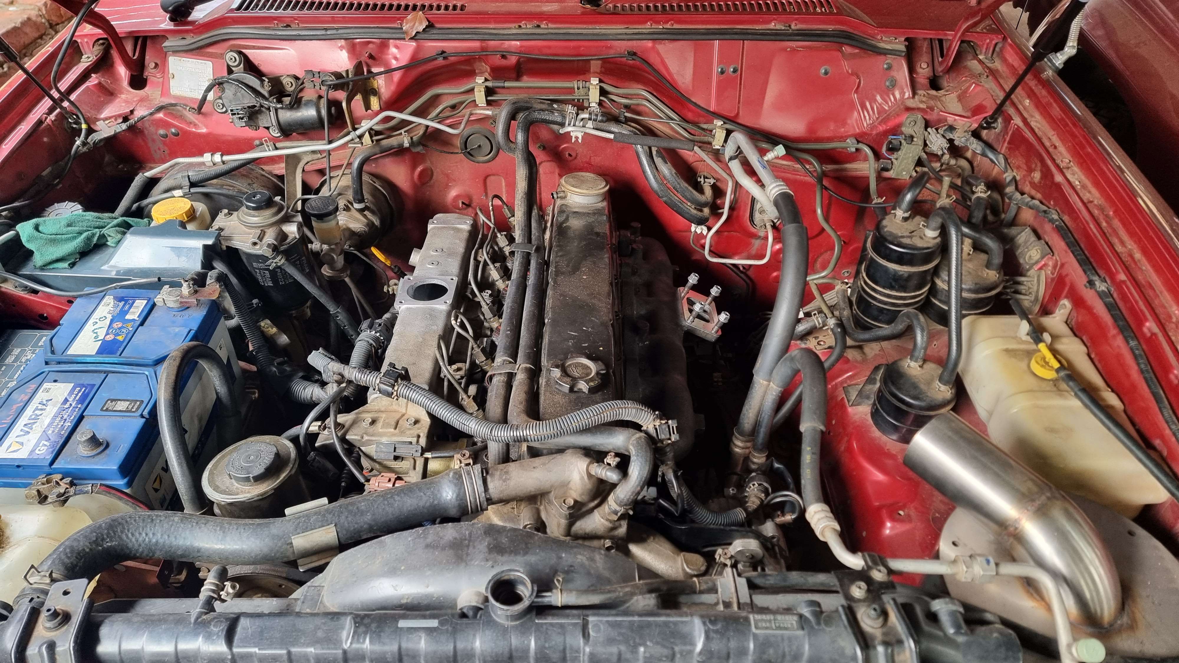

So now all the internal work of the engine has been completed and we can now start with the work on the outside.
Last couple of things to mention. We have tested and calibrated the injectors to 130 bar (factory spec is 118 bar) to help a bit with better atomazation.
Injector pump static timing was done and the boost compensator will follow soon.
Here is just a pic of how the engine bay looks before we get started..........
