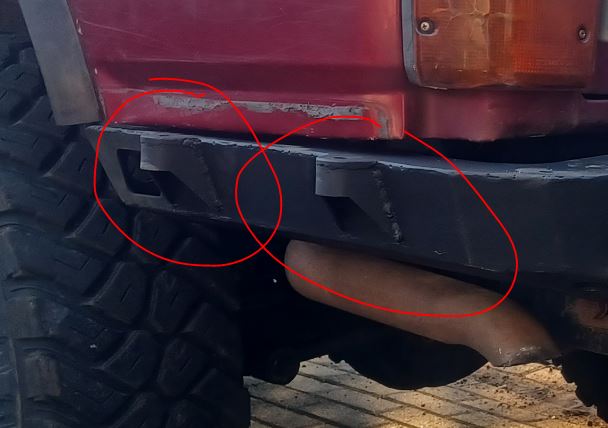

wat is die doel van hierdie?

Fanus dit gaan dalk uiteindelik die monteerpunte vir 'n spaarwiel-swaaiarm wees, maar dit kan dalk ook "barwork" dra wat bo om die spaarwiel na die rock-slider gaan (amper soos Tyler Thompson op Youtube se GQ).
Of dalk soos Des voorgestel het, montering vir die toilet-stoel!
Die gat voor die agterwiel (wat ook binne jou sirkel is) is bedoel as 'n hi-lift jack punt. Nog nie seker of hy sterk genoeg is nie. Gaan nie nou al die vars nuwe verf opneuk om uit te vind nie.

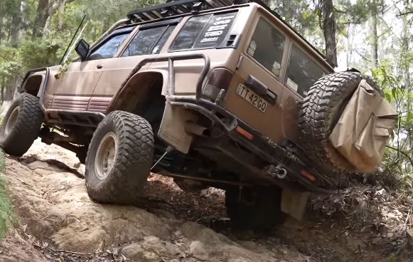

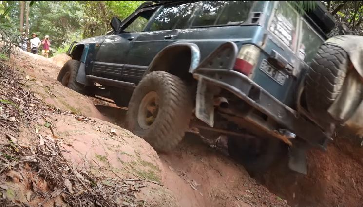

Looks at this guy's rear bumper...
Piet ek dink joune is netjieser gedoen..

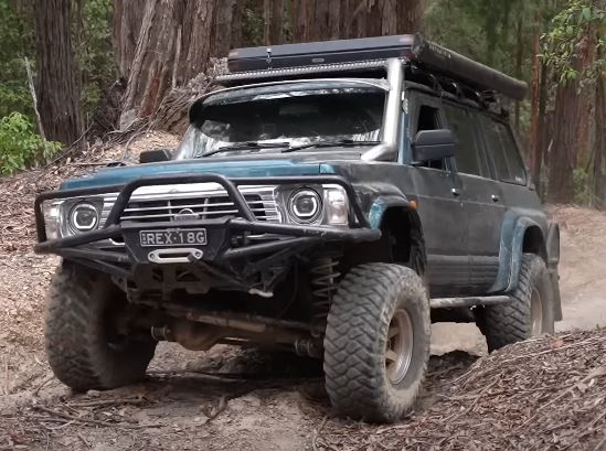

same GQ from the front...
( screenshots from this video:

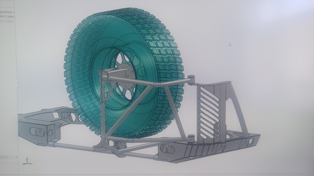

A teaser for the swing arm:
However, note that only one spare can be carried, as there isn't really room in the bumper for lights. There isn't enough room between the body-mounted lights for two spares.
The main reason I am putting the carrier around the back of the wheel is to get the wheel as close to the body as possible, to keep the weight as close to the axle as possible.
