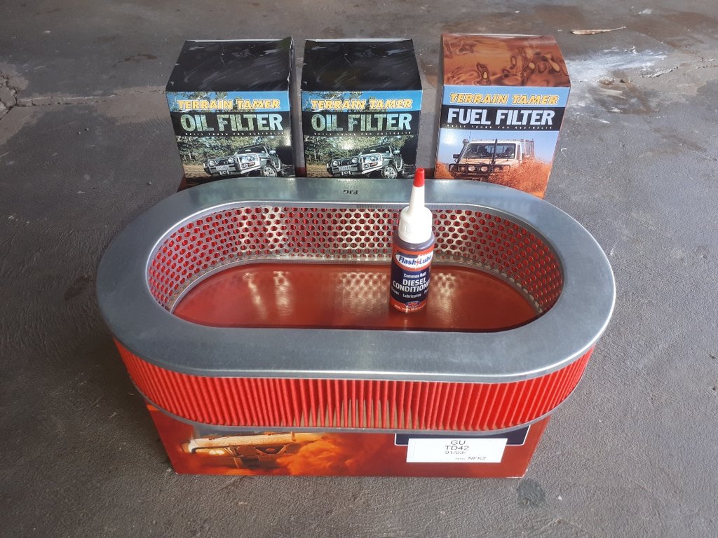

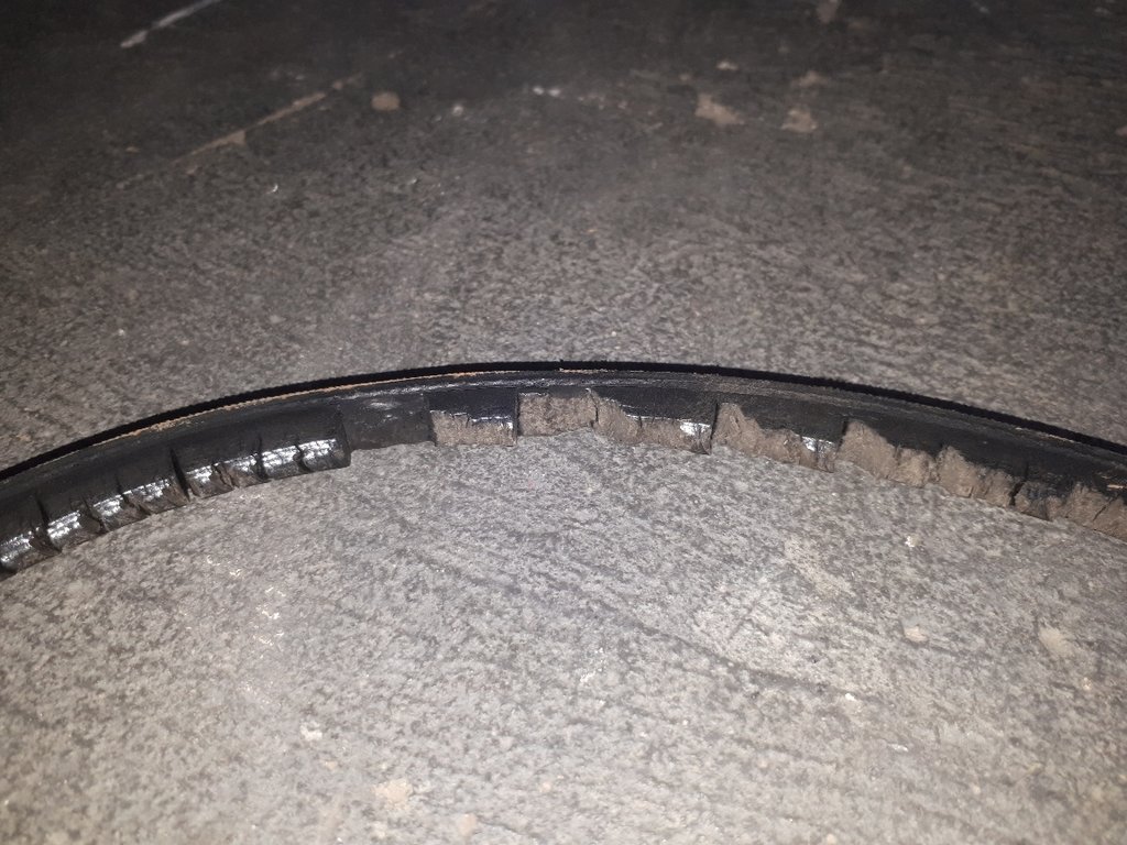

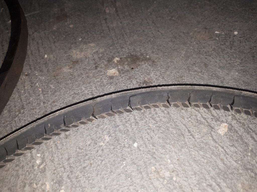

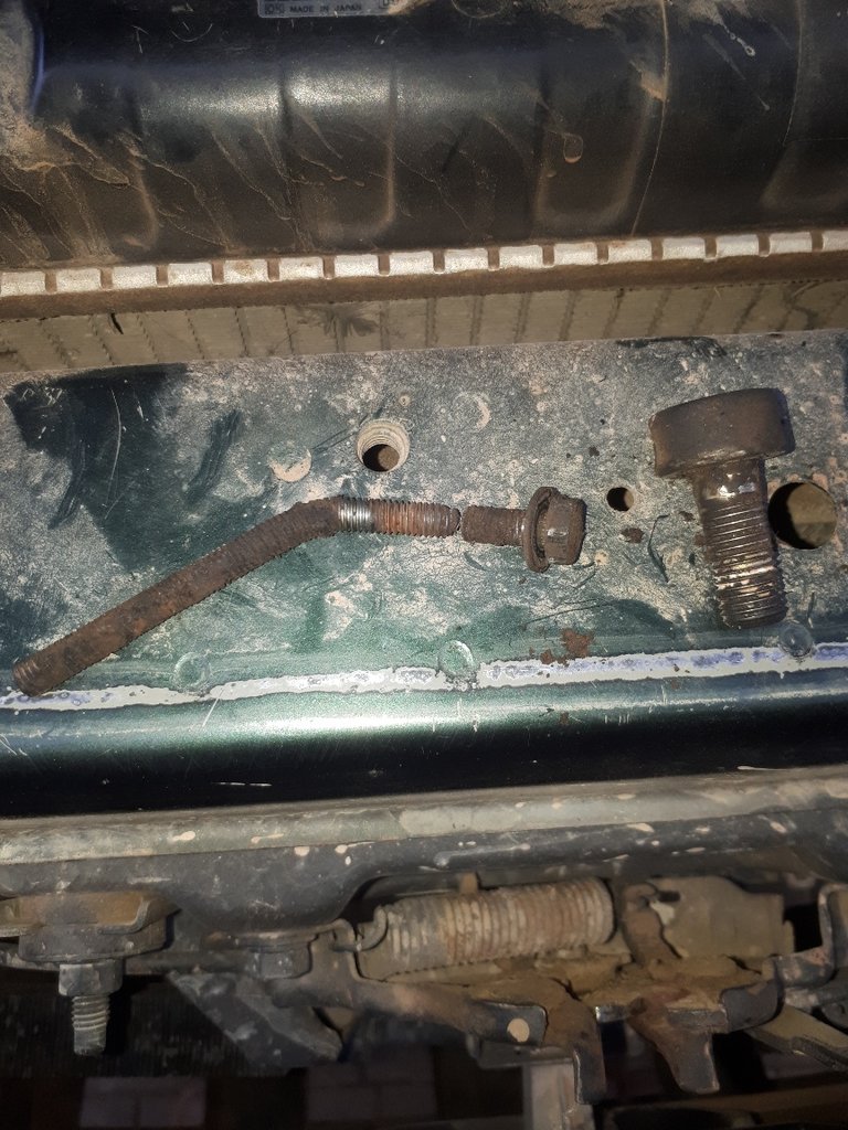

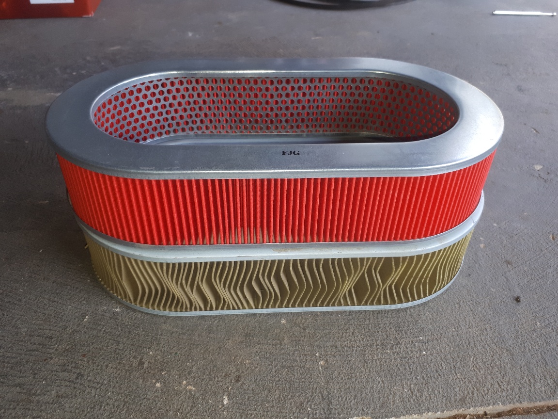

Over the weekend I serviced the vehicle. The fan belts was in a desperate shape. I had to change the tensioner bolt on the power steering pump side due to it being damaged. I used a bolt that I got from the local hardware store.
I used one of the Terrain Tamer kits to service the vehicle. In the kit all the filters are provided as well as a diesel conditioner to clean the system and the copper washer for the sump plug.
The air filter is colored to assist with judging how dirty it is. The red color is ideal for this. Here are the old filter and the new filter.
The next step will be to change the panhard rod bushes and suspension bushes.

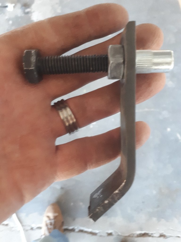

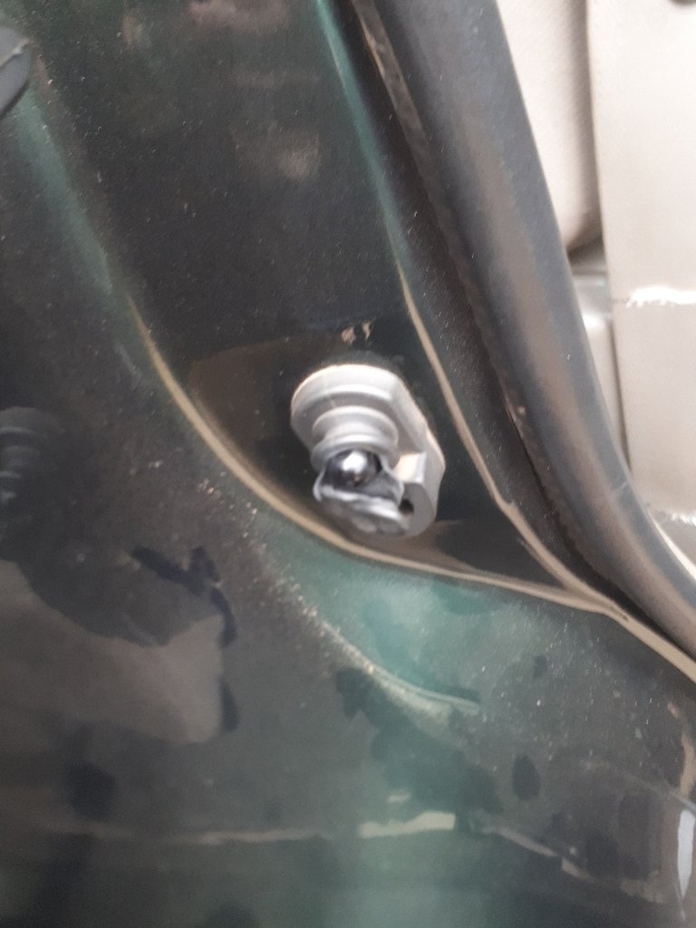

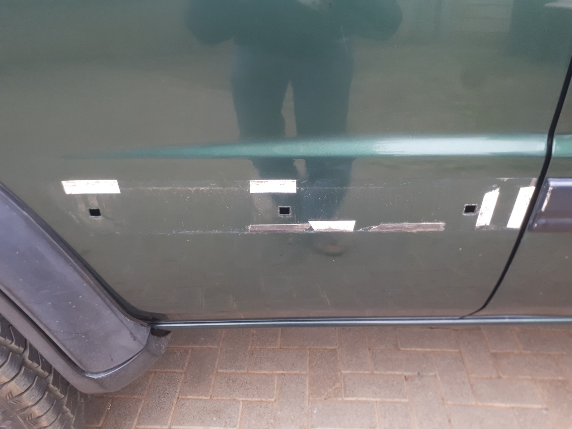

Over the past weekend I did some cosmetic stuff on the Patrol.
First the rubbers on the door switches was in a bad state, so I ordered some with parts I had to order a client. The door trimming was also double sided taped to the door and was coming loos as can be seen in a previous picture. When I removed these I realized that the clips are broken and that I had to make another plan. These trimmings are R2500 new a side, so that was not an option. At the end I decided to use rivnuts or rivet nuts to fix the trimmings to the door. I also used button head bolts for aesthetics. A rivnut tool is crazy expensive, thus I made my own using a bolt, flat bar and a nut.

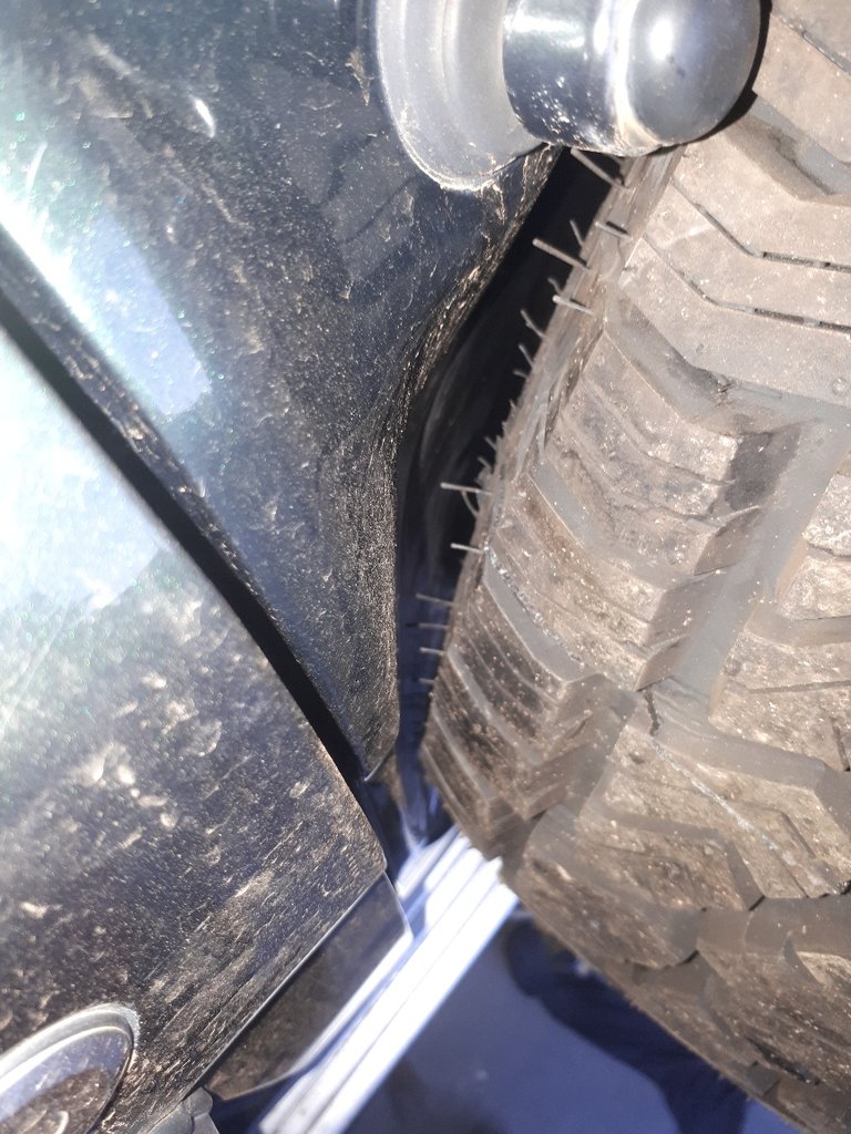

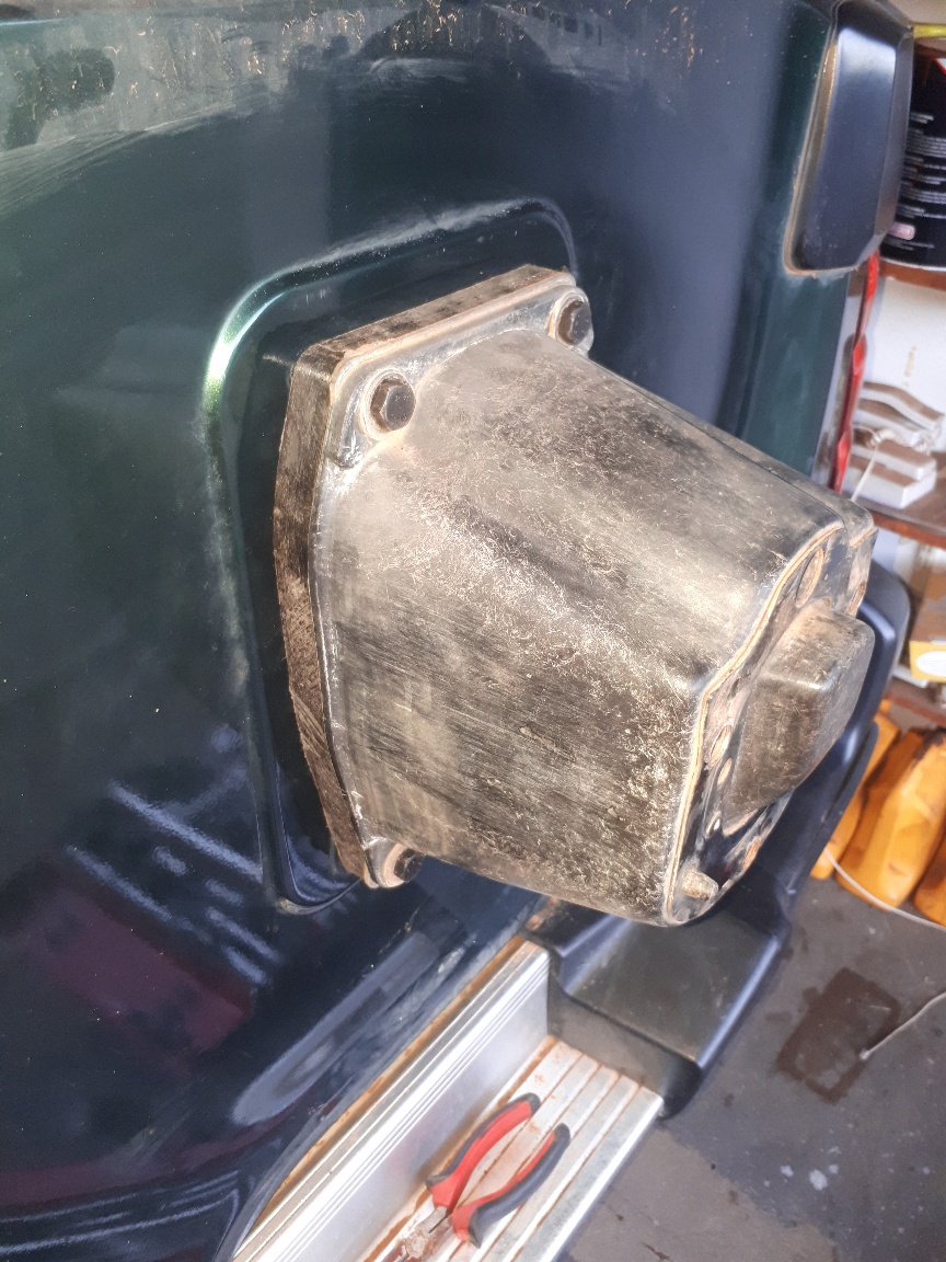

The next step on my patrol rebuild was to make a spacer in order to fit the spare wheel on the back. With the 285/75 16 tires the standard mound does not work.

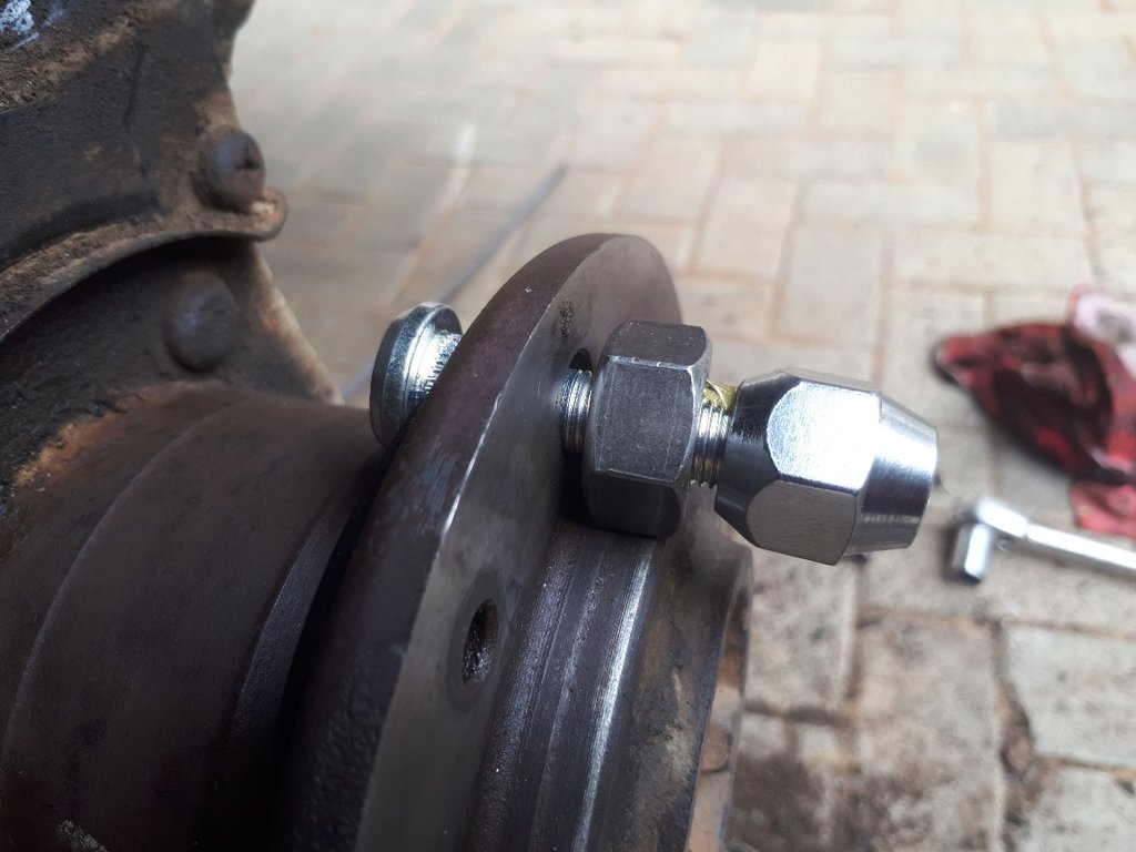

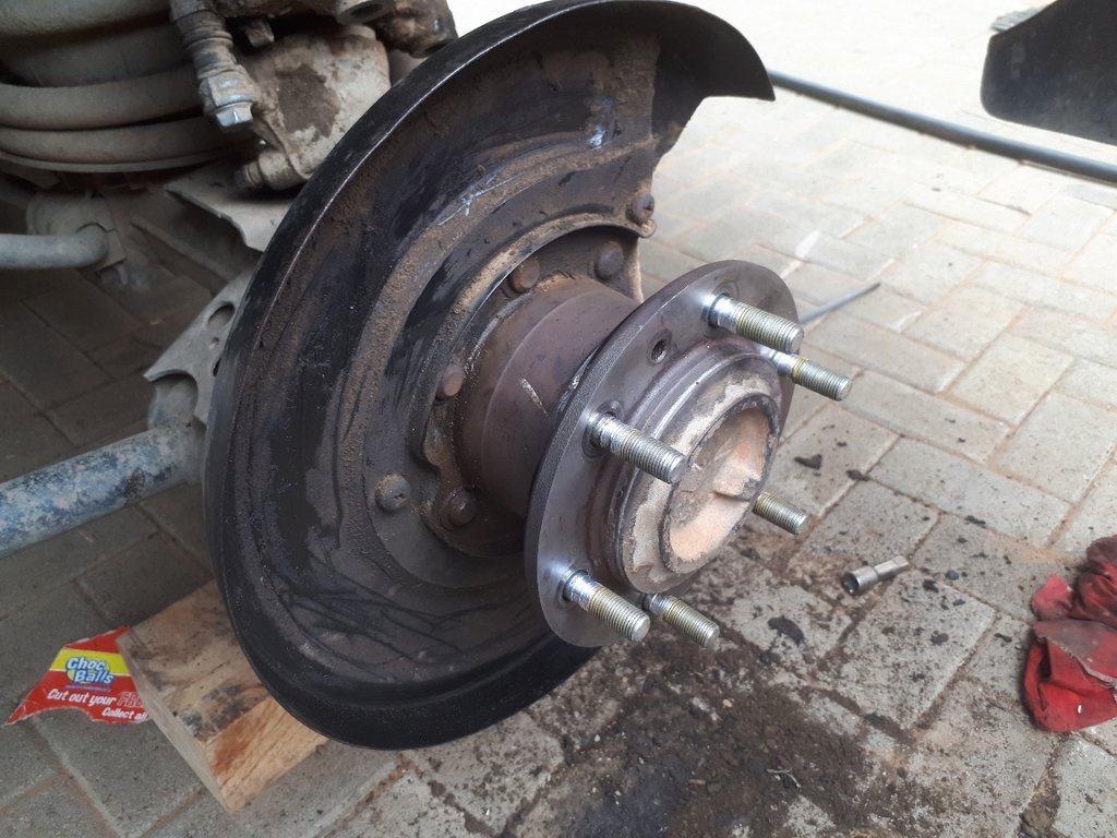

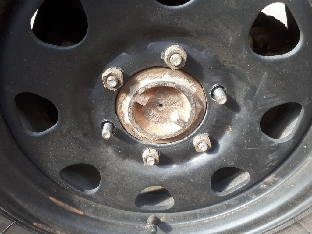

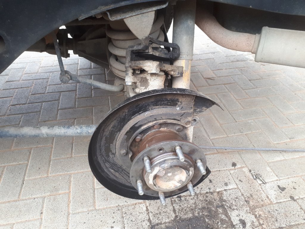

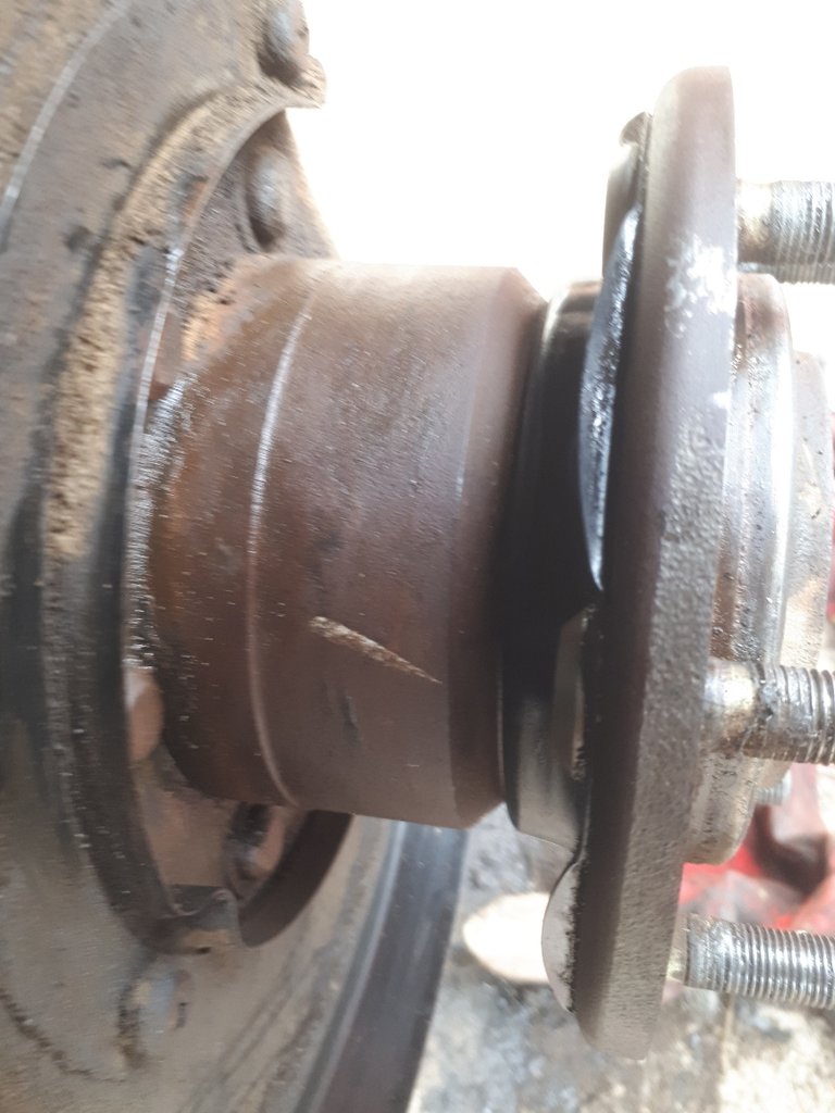

I also replaced the wheel studs on the rear wheels. The front will be changed on the coming weekend. Some of the thread on the studs was stripped.
After taking everything of I realized that there is an oil leak on the seal. This will need replacement as soon as I have time to strip the back.
Installing the studs you need a nut and a spacer. I also put some copper grease on the thread to ensure that the new thread does not get damaged.
The final product
The final product
