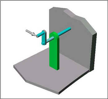

An engine produces POWER by providing a ROTATING SHAFT which can exert a given amount of TORQUE on a load at a given RPM. The amount of TORQUE the engine can exert usually varies with RPM.
So using the sketch below with respect to an engine
The simplest explanation is thus
Torque is the tangential force to turn the shaft
That shafts ability to drive something else is the power
And that’s why the dyno measure the power rather than anything else.
