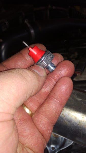

The oil pressure sender was broken and needed replacing

the new Oil pressure Switch
1. New Oil Press Sender.jpg (23.71 KiB) Viewed 9225 times
Oil pressure switch fitted
2. New oil sender fitted.jpg (58.5 KiB) Viewed 9225 times

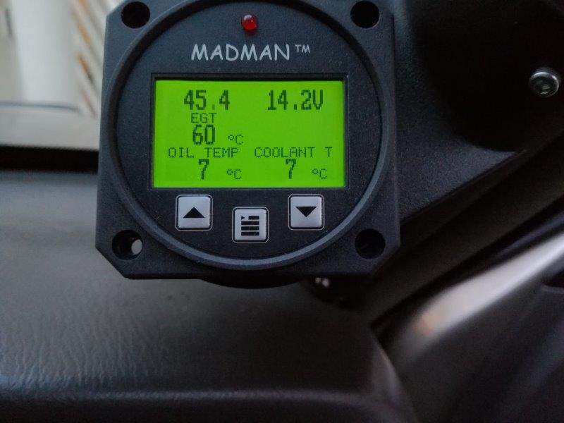

3. new EGT Probe fitted.jpg (40.12 KiB) Viewed 9225 times
New EGT Probe fitted
4. new EGT Probe works!.jpg (46.77 KiB) Viewed 9225 times
Yaayyy EGT Probe works!

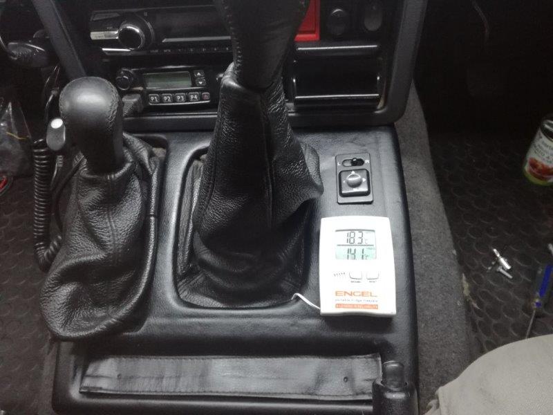

5. Between the seats before.jpg (35.11 KiB) Viewed 9225 times

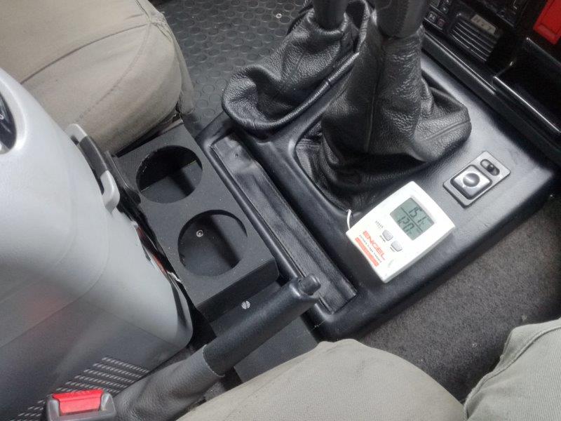

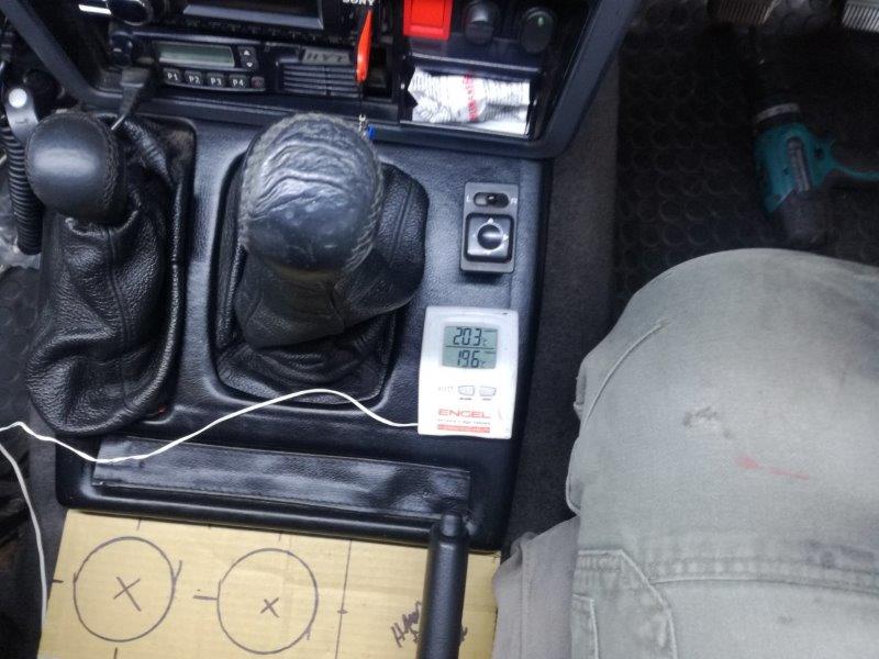

Now to deal with the "situation" between the seats. I notice there's space next to the gear lever to fit the wing mirror switch and the fridge controller. I also notice the distinct absence of cup holders!. So I decided to use the gap between the fridge and the consol as a spot for a cup holder.
6. The concept.jpg (70.87 KiB) Viewed 9225 times

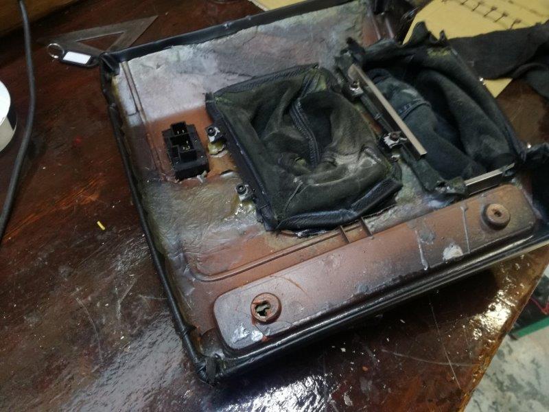

I removed the cover and cut a slot for the switch. Quite tricky because the material the cover is made of is thin and brittle. it has already been repaired with fiberglass.
7. Wing mirror switch cutout and test fitted.jpg (81.79 KiB) Viewed 9225 times
the switch is in and I used velcro to hold the fridge monitor in place. It couldn't be permanently mounted because it runs on batteries and the panel to remove them is on the back of the monitor.
8. Switch mounted and Fridge monitor velcro.jpg (62.61 KiB) Viewed 9225 times

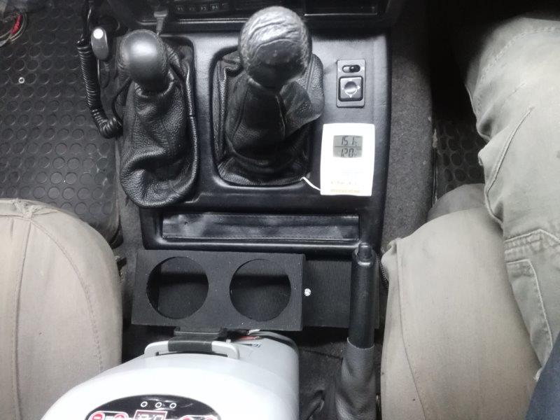

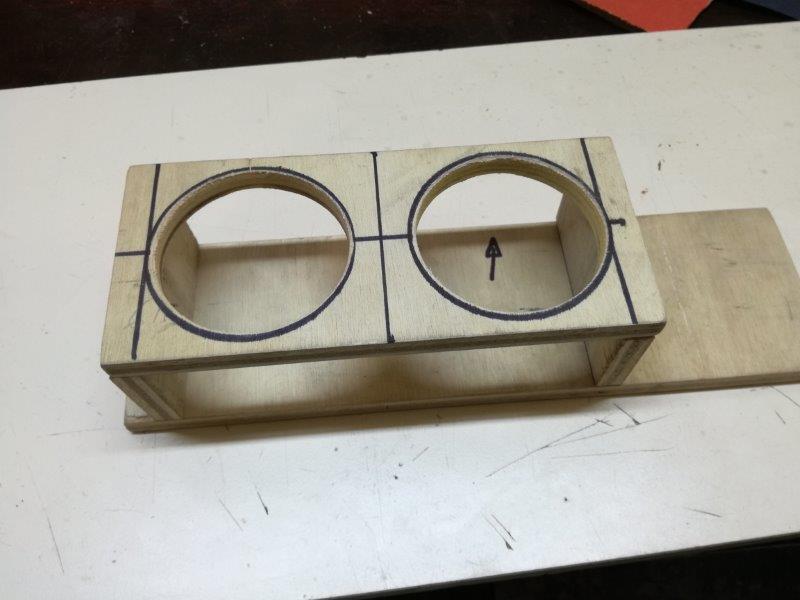

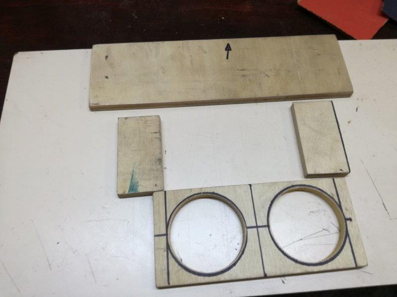

Now to build the cup holder. 12mm Marine ply was used. a basic design leaving space for the handbrake lever was mocked up.
9. Cup holder mock up.jpg (44.32 KiB) Viewed 9225 times
parts cut and drilled
10. cup holder parts cut and drilled.jpg (44.76 KiB) Viewed 9225 times
test fitting the new assembly
11. cup holder mock assembly.jpg (46.67 KiB) Viewed 9225 times
I gave it a few layers of spray paint and clear lacquer then glued down some rubber which will be durable, washable and wont rattle when theres a cup/tin in the holder
12. cup holder painted and rubber lined.jpg (63.02 KiB) Viewed 9225 times
and its done
13. New layout complete 1.jpg (62.31 KiB) Viewed 9225 times
14. New layout complete 2.jpg (70.14 KiB) Viewed 9225 times

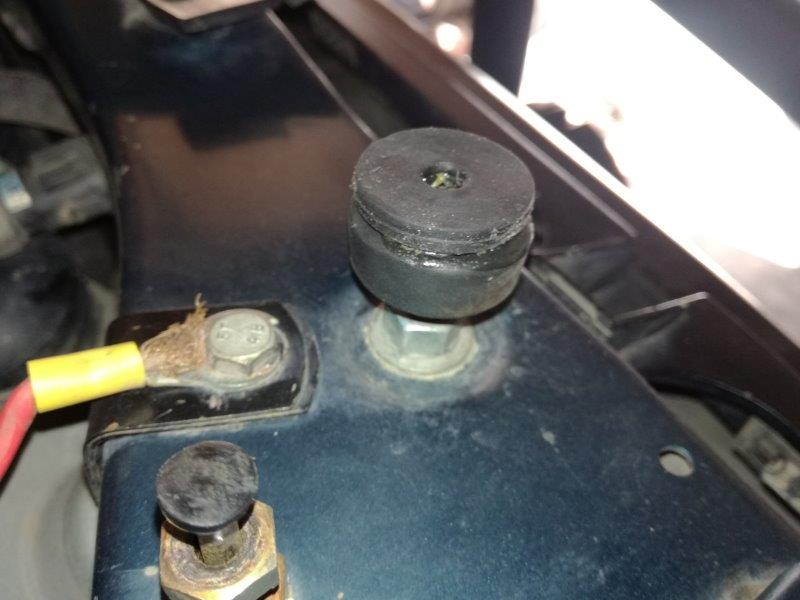

Dirk was annoyed with his bonnet moving enough to be annoying so I glued rubber washers onto the worn bonnet stops.
15. Rubber washers glued to perising bonnet stops.jpg (51.8 KiB) Viewed 9225 times

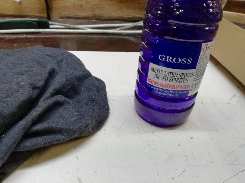

the surfaces must be cleaned before the material is applied. Enter cloth and methylated spirits. No Tinus, the cloth is not to filter the meths for drinking! :naughty:
17. Prep kit for Damping the doors.jpg (62.67 KiB) Viewed 9220 times

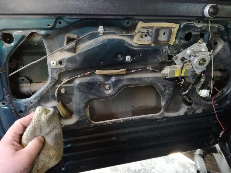

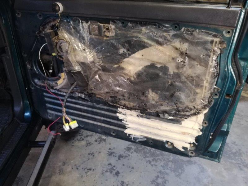

Then the really dirty job of cleaning the surfaces. Inside and out. My fat hands struggled with this part. GU doors are easier because there's more space.
18. Cleaning surfaces with meths.jpg (71.02 KiB) Viewed 9220 times
this is the driver's door before I start
19. drivers door before treatment.jpg (73.55 KiB) Viewed 9220 times

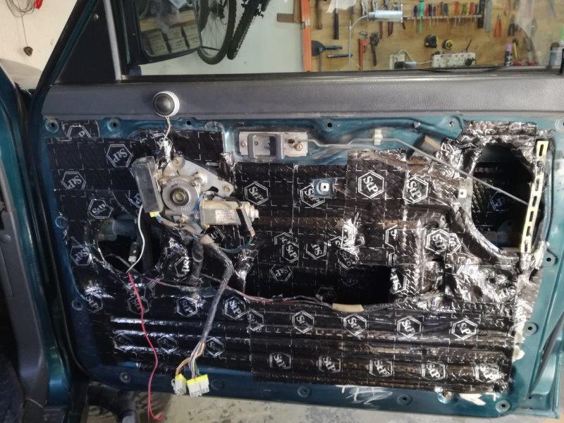

The Damping is stuck onto the surfaces and pressed down with my high tech applicator (aka. my own range of shaped pieces of wood). Driver's door done. 100% coverage isn't necessary, however, if you are applying a noise blocker, 100% coverage would be essential.
20. Drivers door treated.jpg (104.46 KiB) Viewed 9220 times

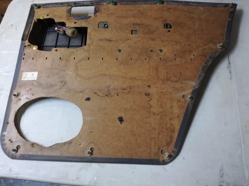

Now the Low density foam application to the door cards. First clean the surfaces.
22. Door cards wiped frre of dust.jpg (57.19 KiB) Viewed 9220 times

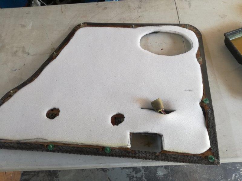

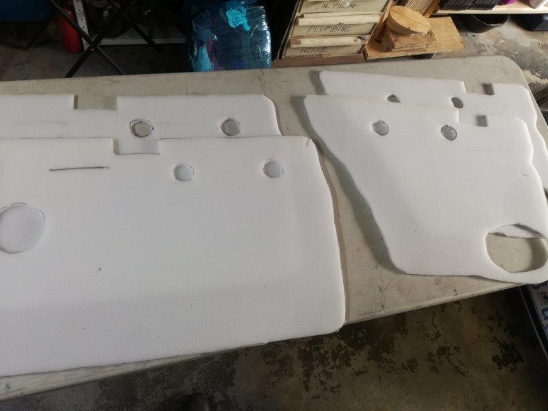

Cut foam to size
23. 12mm low density foam cut to fit doors.jpg (44.73 KiB) Viewed 9220 times
Apply a layer of contact adhesive to the door card
24. contact adhesive applied to door card.jpg (71.04 KiB) Viewed 9220 times
Lay the foam on the glue and press down. Then put the panel back
25. foam laid on card.jpg (56.73 KiB) Viewed 9220 times

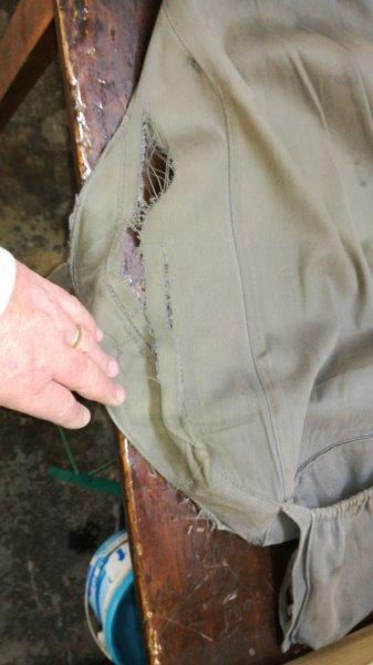

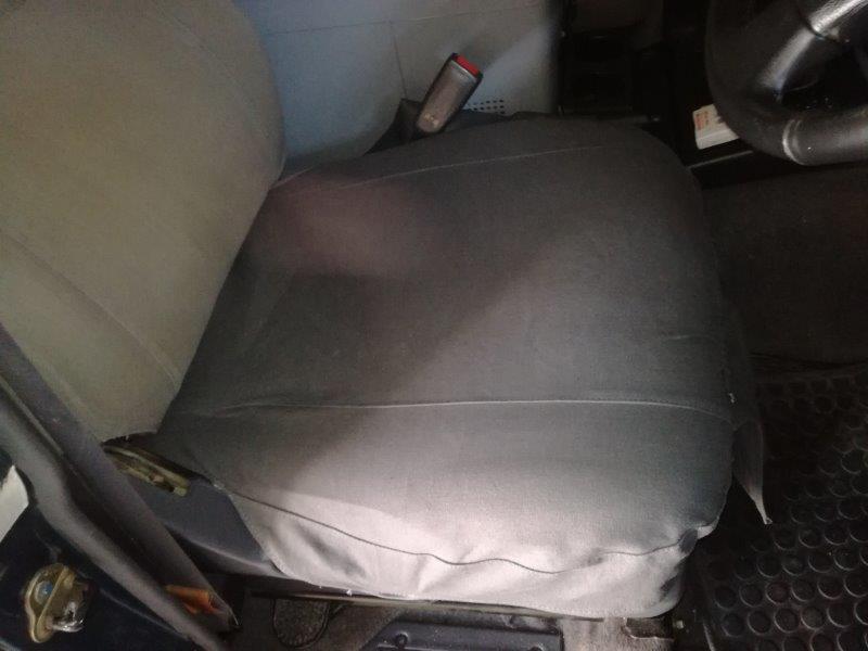

the seat cover on the drivers side had shifted towards the center so I pulled on it to shift it. Oops! I tore it. Badly. :imsorry: Have to replace it.
26. torn seat cover.jpg (29.28 KiB) Viewed 9220 times
I had another one made and fitted it :woo:
27. new seat cover.jpg (44.36 KiB) Viewed 9220 times

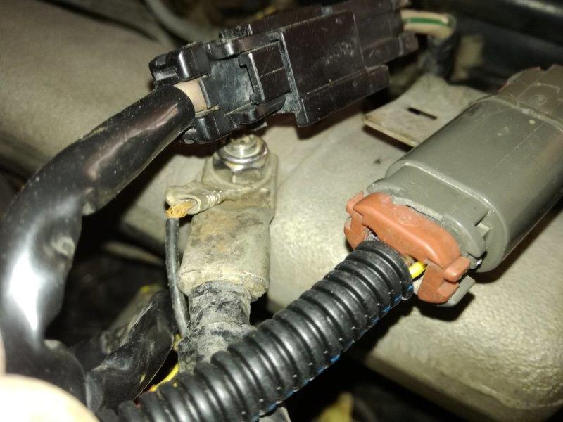

The rev counter was not working and that is just wrong. so I traced the fault to some badly repaired wires near the plug above the intake manifold. I took the plug apart and soldered new wires in place
28. Tachometer wires replaced.jpg (67.74 KiB) Viewed 9220 times

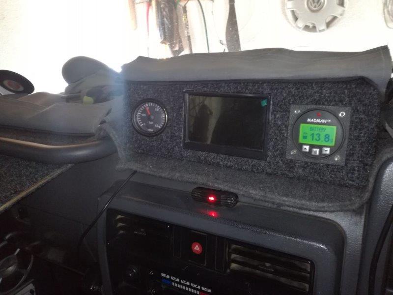

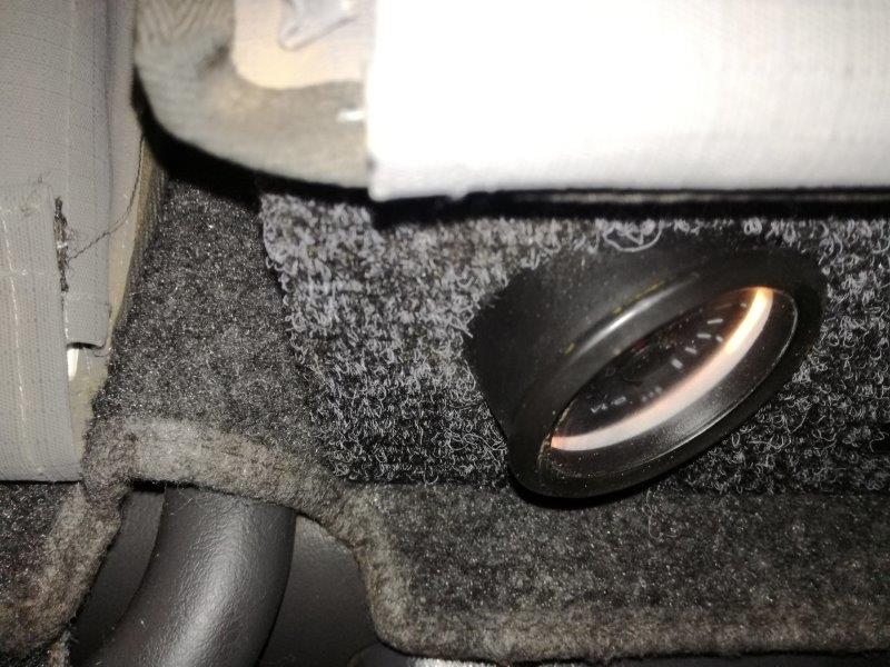

The boost gauge display is set back quite far in the gauge and from the drivers seat you couldn't see it nicely so Dirk asked me if I could angle it towards the driver a bit
29. boost guage angled towards driver 1.jpg (89.56 KiB) Viewed 9220 times
Done
30. boost guage angled towards driver 2.jpg (51.32 KiB) Viewed 9220 times
