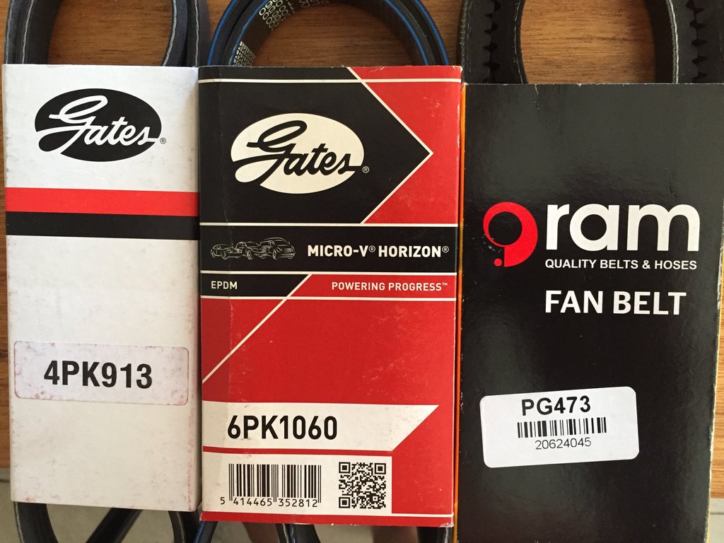

I changed all my belts about 5000km ago with the belts below, all from Midas. Total of R520 for all three. No problems so far...

Thanks Jonathan. Added to shopping basket
