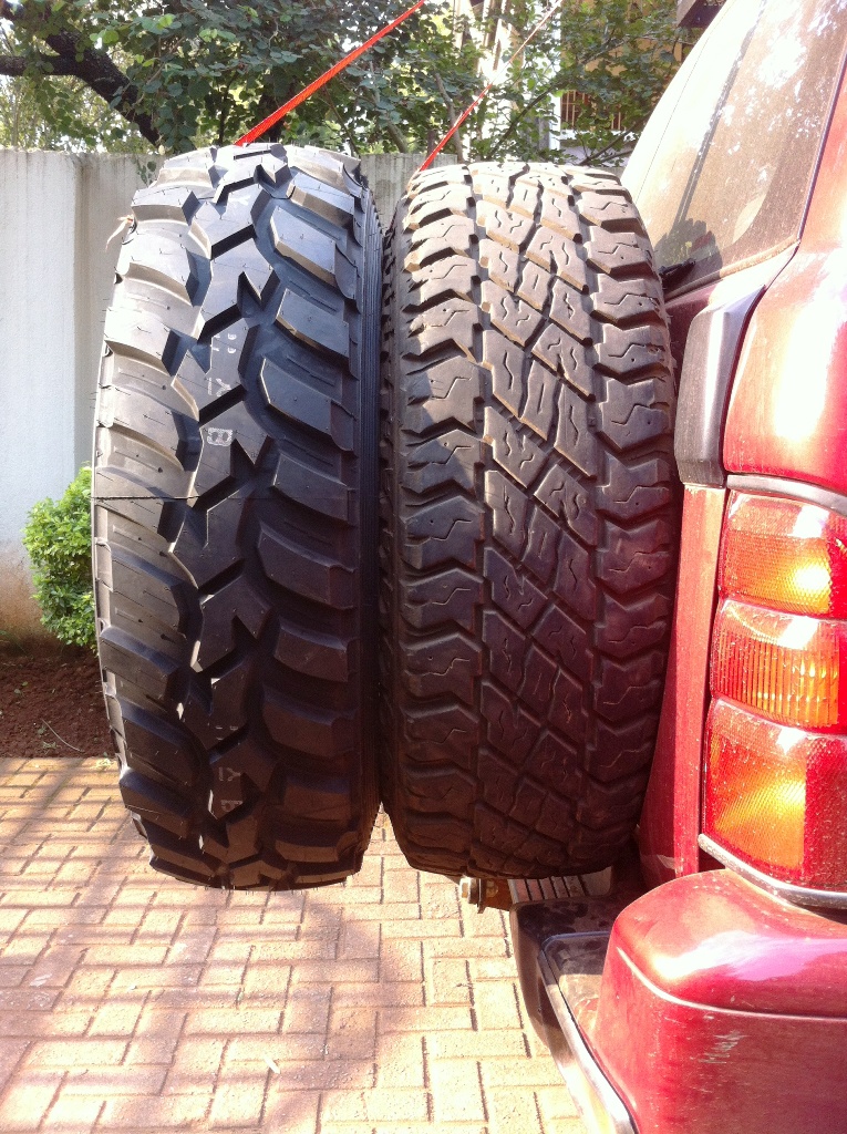

Ok guys, here's an interesting one regarding all the hype about tyre width and HT / AT / MT's and their related fuel consumption.
So ..... Wider uses more fuel - correct?? AND MT's use more than AT's, which in turn use more than HT's - this is a fact .... right??
Ok, here's what I have found out on my last two runs down to the W/Cape. You guys all know my GU - it came with BFG 305 65 17 KM2 muddies. I drove down in December on these tyres and had a blowout on my return trip and promptly replaced all 5 tyres with Cooper STMaxx's these are classified as AT's and I went a little narrower i.e. 285 70 17. Last month I drove down again on the new ones, both trips were towing a trailer. In December we were 4 up inside with a number of light items on the roofrack as well as a bicycle lying on top of the trailer. Last months trip we were 2 up inside and nothing on top.
Here are my findings:
Jhb to Hanover (BFG MT 305's) ODO = 669.10 GPS = 712.10 Litres = 134.72
Jhb to Hanover (Cooper AT 285's) ODO = 672.10 GPS = 715.15 Litres = 133.24
Is this a "busted myth" or what!!

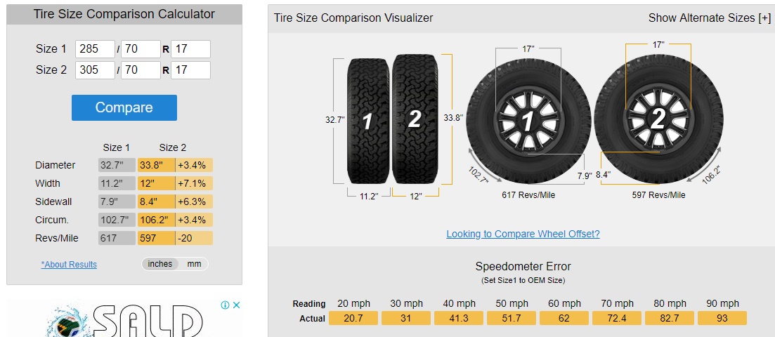

The OP compared 285/70 x 17 with 305/65 x 17
when comparing the two, the OD size for each size is:
305/65 - 828.30mm or 32.61"
285/70 - 830.80mm or 32.71"
So the size is very similar, the 285/70 is 2,5mm (or 1/10th on an inch) taller than the 305/65. I bet you if you fit new tyres, after just 5000km, that will be the OD difference between your front and rear tyres. It is really insignificant.....
