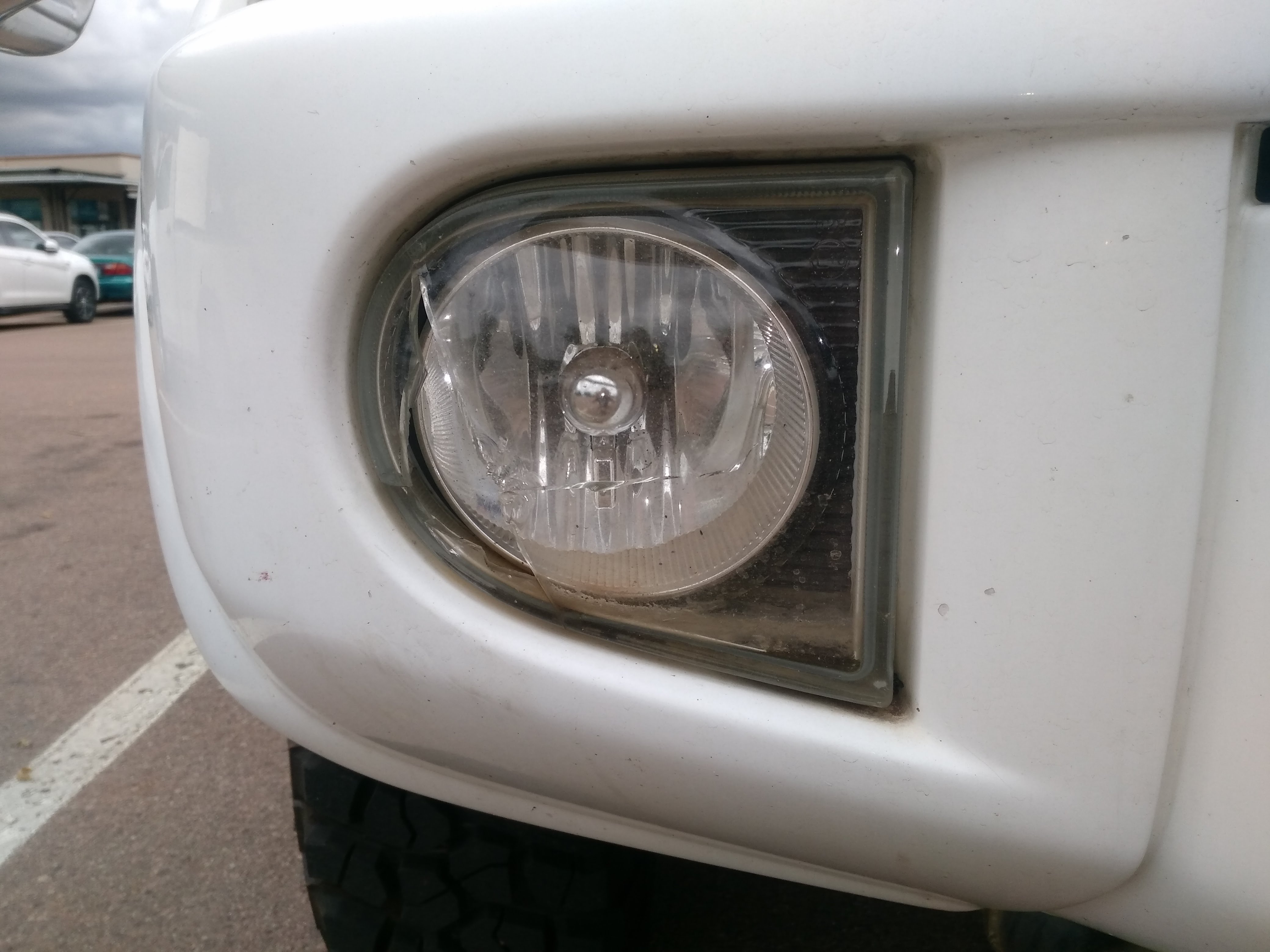

My right fog light is broken (no I did not do this...)
If you know where I can find one or have one lying around please do let me know.
2004 Patrol 4.8 fog light

Hopefully someone has one lying around for you... the stealers will be expensive for sure.
Maybe a scrapyard ?
Maybe a scrapyard ?

I'm hoping for one from a scrap yard, or perhaps one from someone that upgraded to an off road bumper.
I really like the stock look of the Patrol, but I suspect I will need to change the bumpers front and back at some point.

have a look here.....

Buy 6mm Poly Carbon [small sheet]
Take light out, remove the glass from the lamp [apply heat from SWAMBO's hair dryer or some such]
IF it breaks up, patch it onto masking tape. Martk the shape on the poly carb, cut out with figure saw .. Stick on with good glue
and VOILA .. a light lens that wont' ever break again

Oom Mac, ek sal daai liggie uithaal en bestudeer. Dit klink nogal na 'n idee.

Contact me if you want some Polycarbonate
