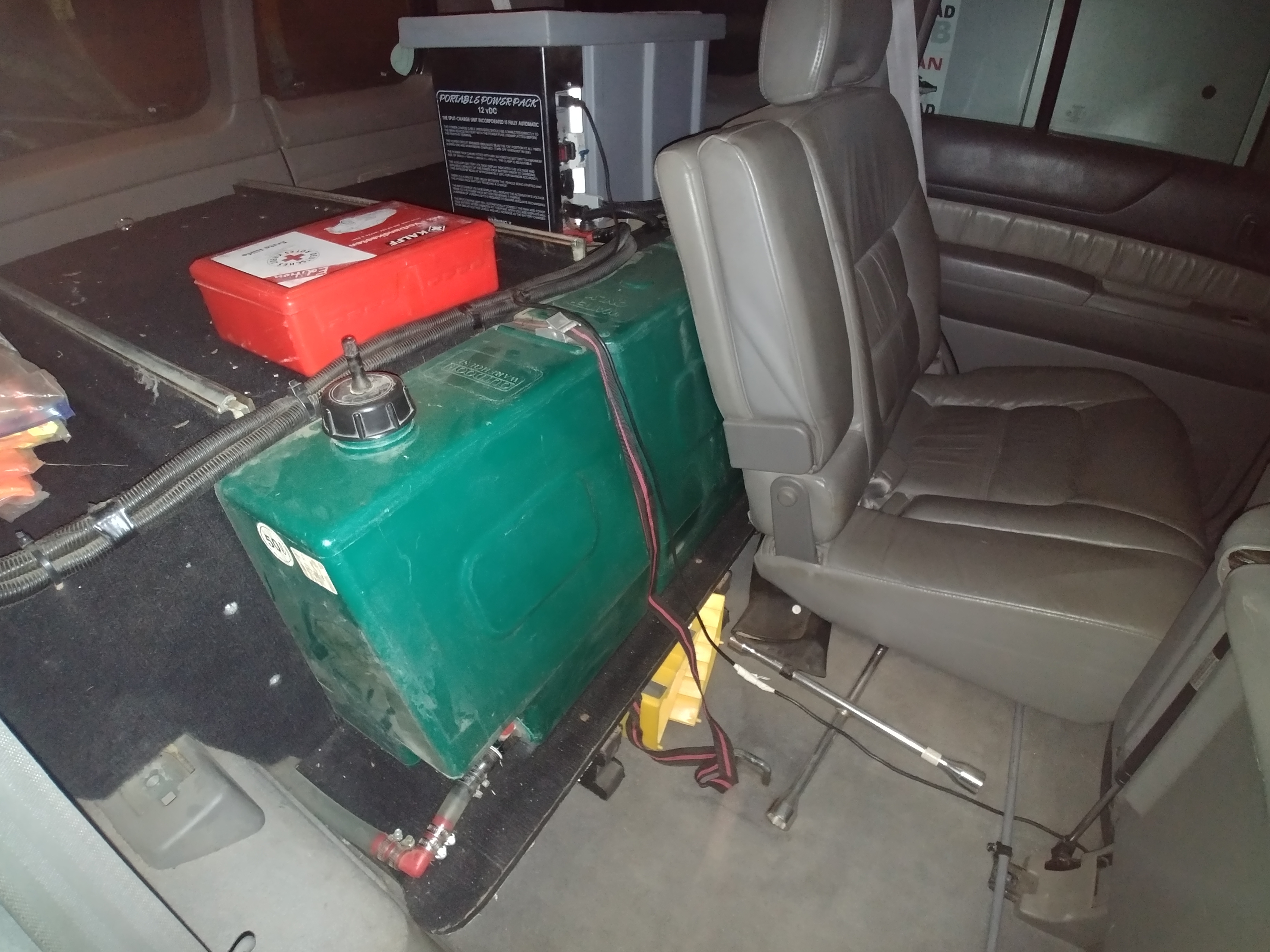

Re: Front Runner Water Tank behind Rear Seats - GU
Here is a pic showing the 50lt tank fitted
behind the middle row seats.

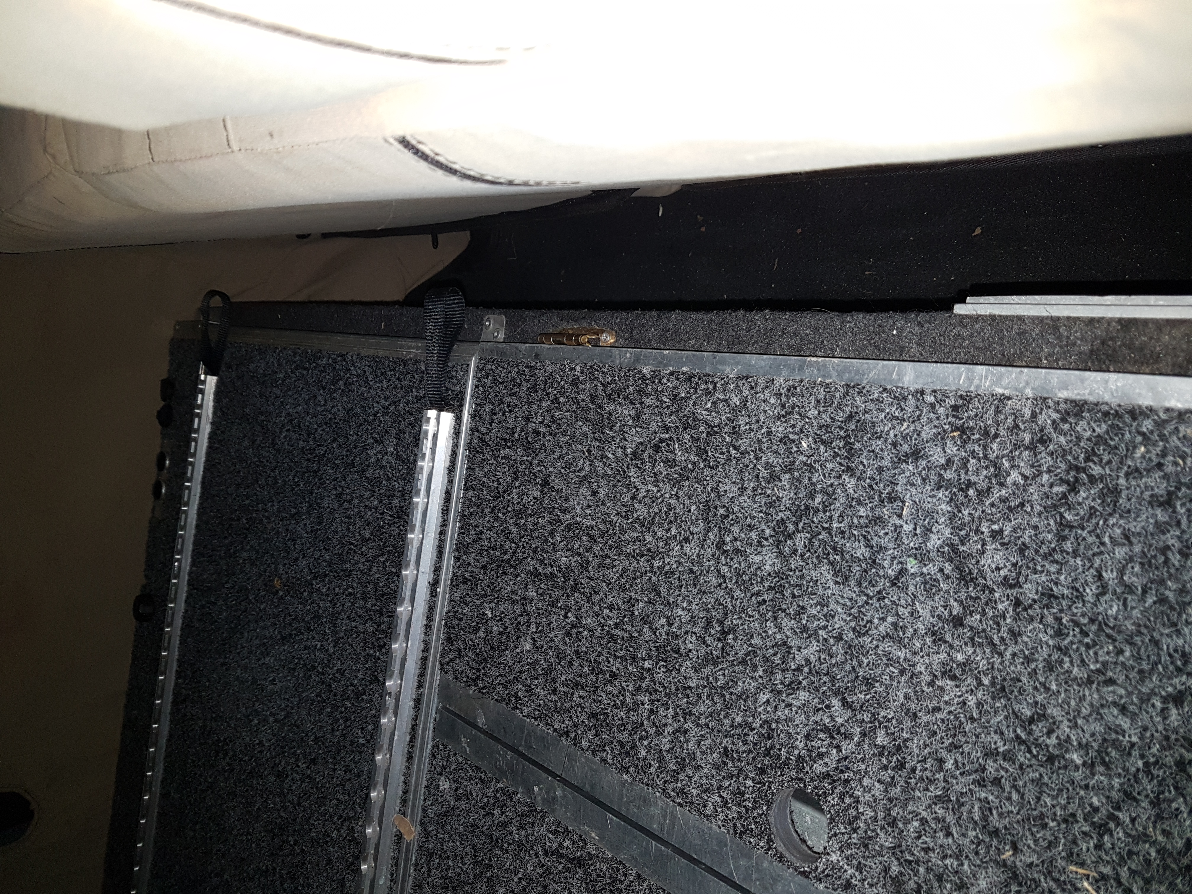

Many, many thanks for the picture Jorrie. I can see from the picture that that tank won't fit in my car. My drawer system comes further forward and leaves a smaller gap between it and the back of the seats. See the picture below - it's quite narrow, especially towards the top. I did measure up and based on that it looks like the Front Runner 40l unit will fit although pretty much only just. I guess I will have to take a drive to Front Runner and test fit a unit quickly there. 40L is darem nie heeltemal niks nie but I would be very happy if I was able to add another 40L in a water bladder on the left side of the vehicle as per the other thread.
