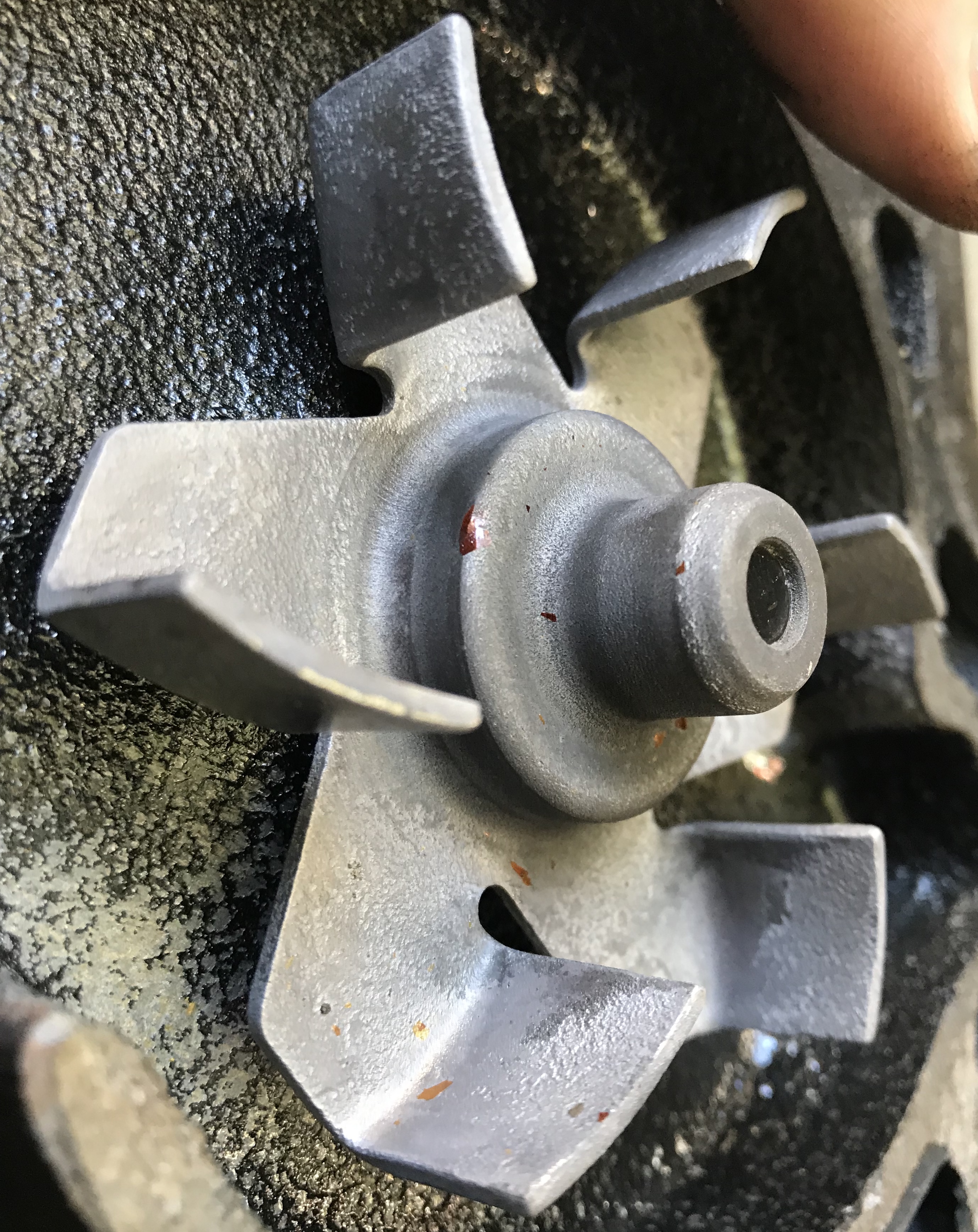

I took off the waterpump and there does not seem to be much wrong with it, the impellers are slightly worn. I think I might have wasted money buying a new one.
Or will the corroded impellers make a big difference?
Re: Waterpump
That looks fine to me all the blades are there
Re: Waterpump
I have seen way worse, but actually still looks fine. That being said the piece of mind will be in the new pump.
The corrosion on that impeller would not make a difference IMHO, but any pitting on the surface of an impeller will increase cavitation.
Use the new one...

Re: Waterpump
Post by Pieter B »
The problem usually lies with the bearing/seal. And then the inconvenience of having to drain and replace expensive antifreeze, removing the radiator and fanbelts. Rather just buy a good quality new pump.
Re: Waterpump
I see you bought a new pump & you pulled the old one out so best idea is to fit the new one...

Re: Waterpump
Post by Dungbeetle »
Note sure why you opted to pull the old one - now that you have done so best is to put a new one back.

Re: Waterpump
Post by Jules »
Maybee Dungbeetle’s Patrol is aircooled and not watercooled :rolling:

Re: Waterpump
Doubt it .... but definitively time for a good flush of the entire cooling system and replacement of the antifreeze..... BUT PLEASE USE QUALITY ANTIFREEZE, and NOT the cheap stuff. This is the ONLY time other than Head Gaskets on a TD42 where I would recommend Nissan Original.
Or you can use aftermarket, but don't buy cheap, and mix 100% to the correct ratios. Cooling fluids should be changed probably every 100 000Km, but would have to check the manuals.
I do mine every 50 000 odd Km
