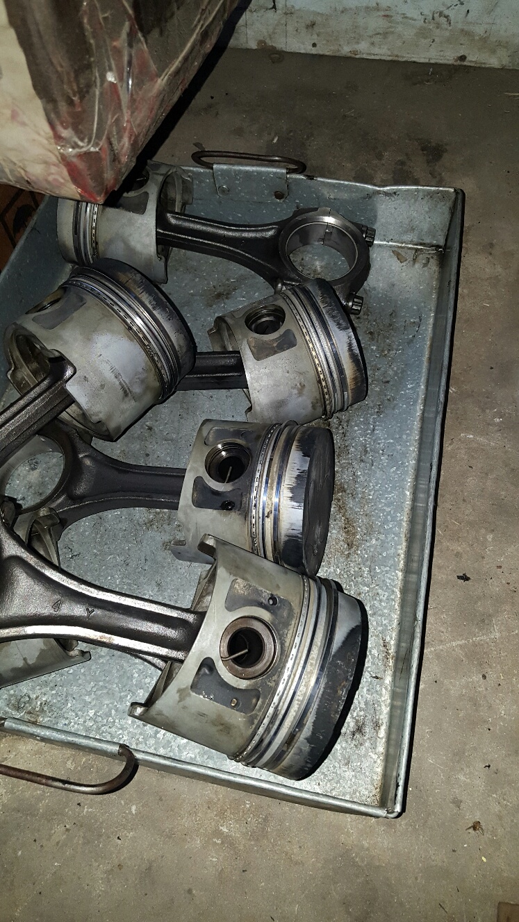

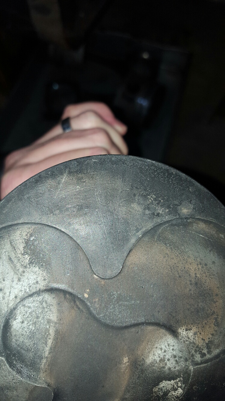

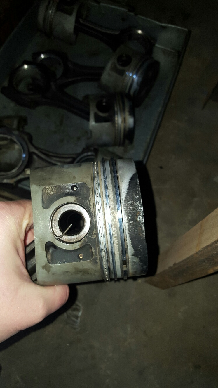

Here is pictures of the pistons that I took out of my TD42. Looks the same as the piston second from right on Michael's post.

- Been thanked: 432 times
Re: Td42 Silvertop engines
I fit the pistons on the right hand. These are the strongest pistons available and have the cooling ports in the piston head to ensure the piston does not over heat.offroadbiker wrote:So..... if you now re-build an engine what is it that you are going to fit to ensure it is the best/strongest?
The pistons second from left I also use as they are also turbo pistons with alfin incerts, but obviously first prize are the ones on the right
Rudolph, ja daai kyk net soos die silvertop pistons wat ek hier het
En die conrods .moet 30 toe gaan want mens kry nie reg 28mm td42 pistons nieMichael wrote:I fit the pistons on the right hand. These are the strongest pistons available and have the cooling ports in the piston head to ensure the piston does not over heat.offroadbiker wrote:So..... if you now re-build an engine what is it that you are going to fit to ensure it is the best/strongest?

Did some more measuring today and the silvertop piston as well as the TD42TI pistons have 15,5mm thick piston heads where the NA pistons only sport 10mm piston heads

Just laughing to myself though when looking at Michael's photo comparing the pistons. It's obvious what the difference is between the silver and black tops. It's the pistons. Black tops are old pistons and silver tops are new pistons.
So if you add a turbo you need to add silver top pistons ... upgraded pistons
lol
