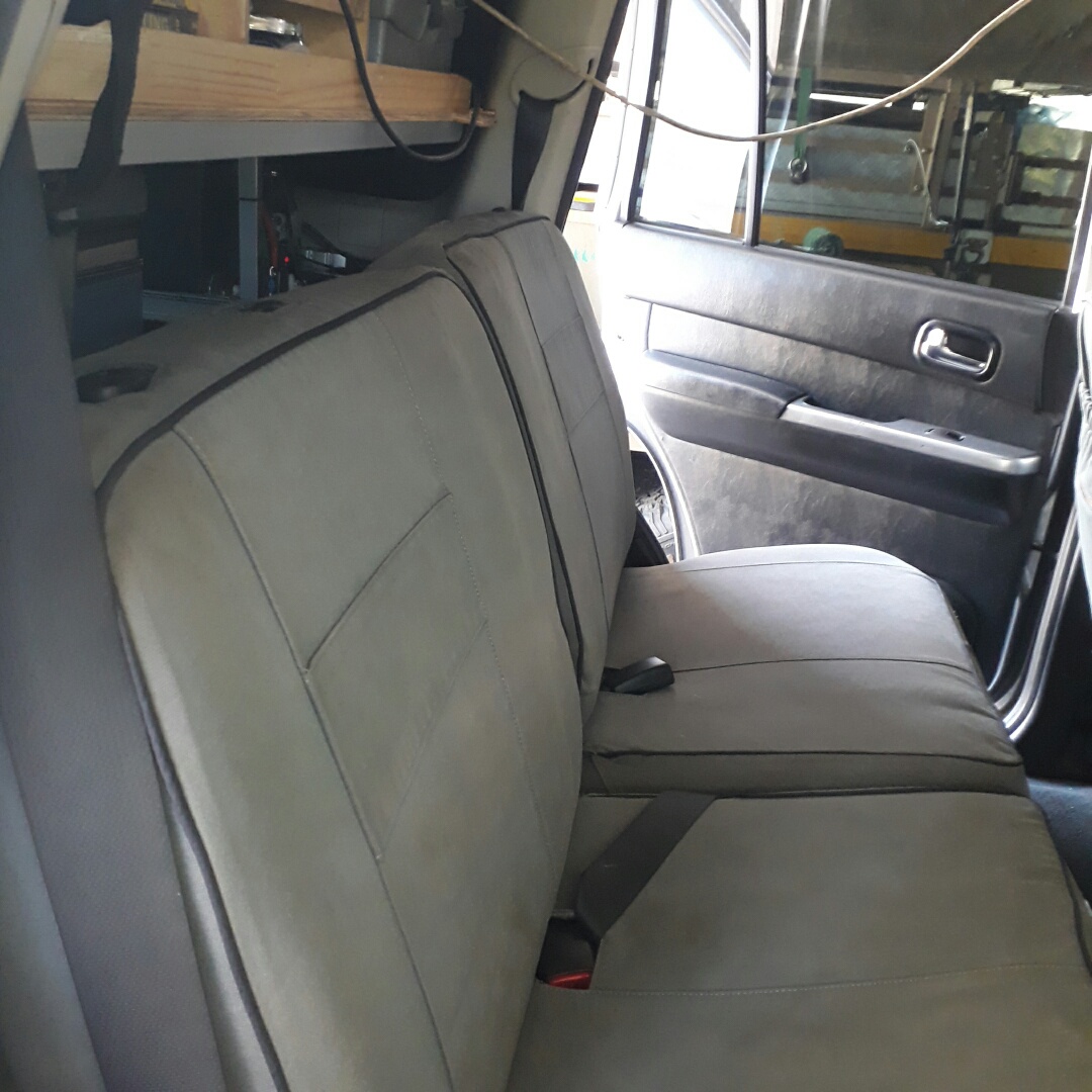

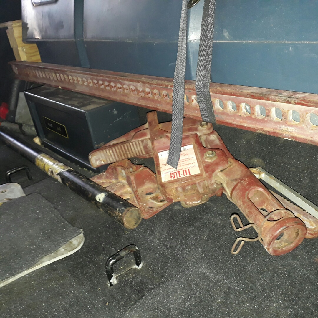

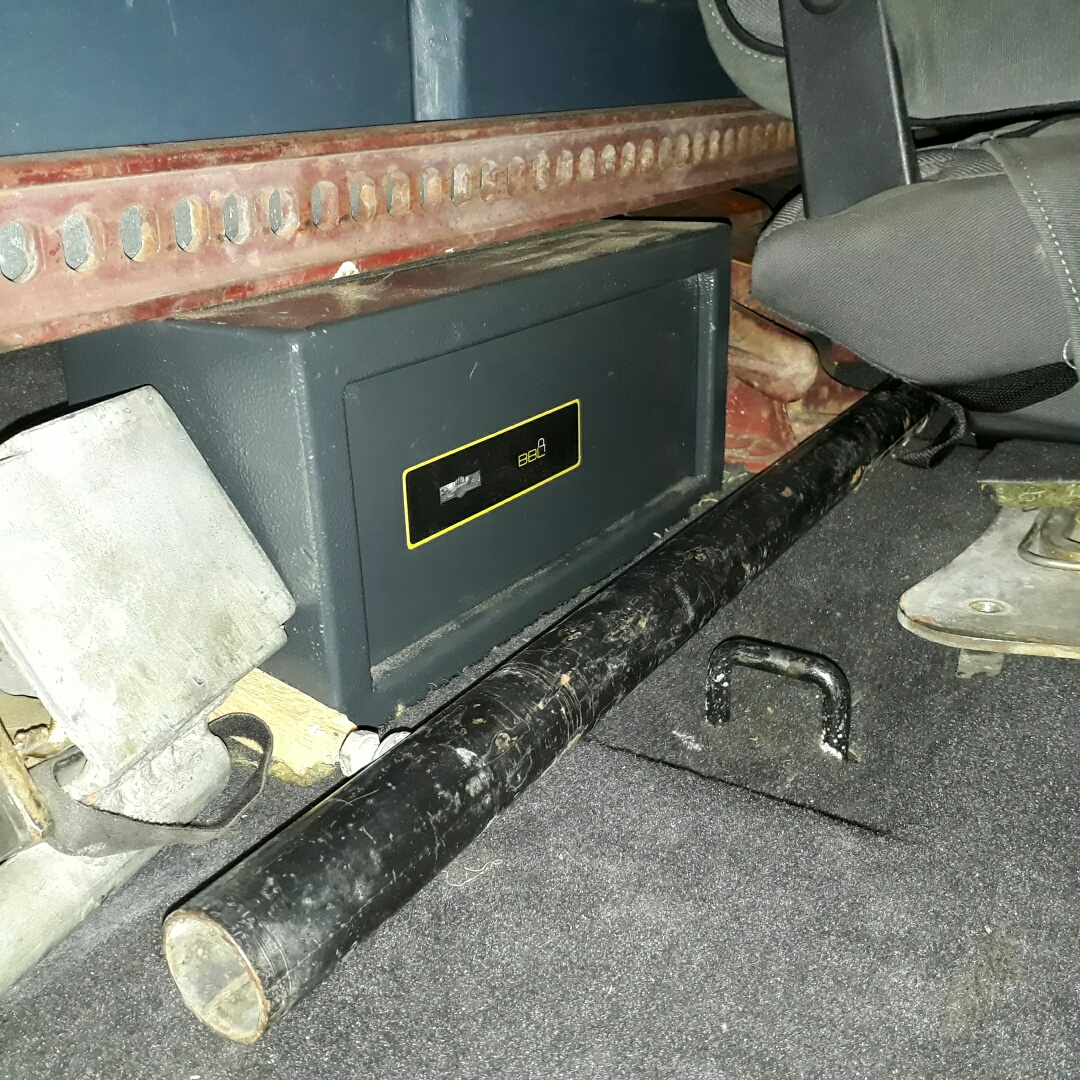

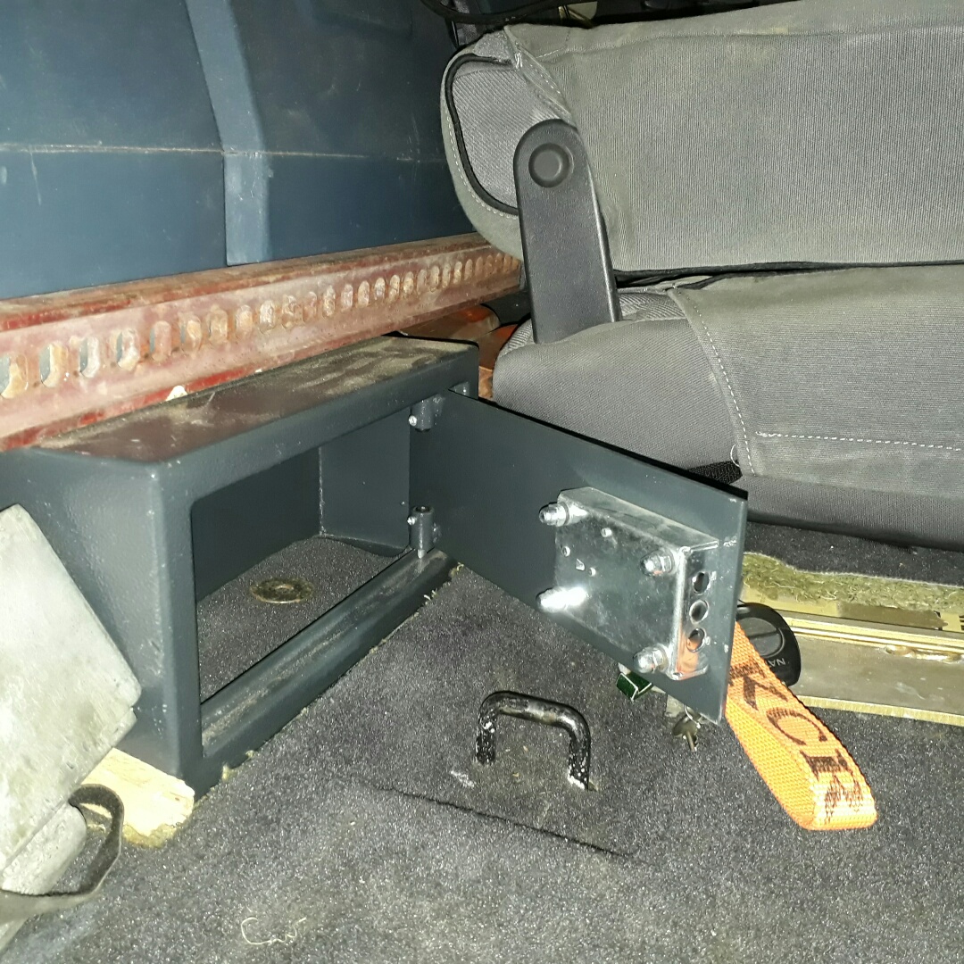

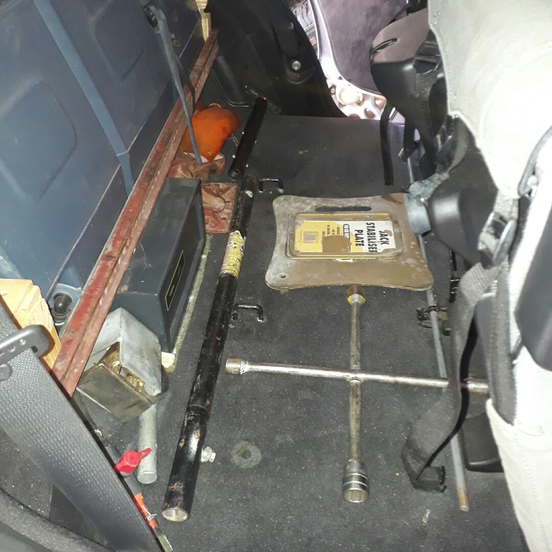

I managed to fit mine under the rear seats. :eureka:
When I fitted my ammo box slide and fridge/freezer slide (90lt NL) rack system to the Patrol, it left enough space between the rack system and the rear seats for a 60lt Pioneer Plastics water water tank.
Below the water tank I then had enough space on the driver's side to bolt one of those small "build into the wall" safes that I bought from my local hardware store.
It is a SAPS approved handgun safe and most locksmiths sell them too. The safe is roughly 140mm high, 110mm deep and 300mm long. They go for about R600.
On the opposite side, I had enough space for the base unit and the working parts of my HL jack and a "clip together" spade.
Under the seat there is enough space for the jack handle, the spade handle, the bigger base plate for the jack and the cross brace wheel spanner.
The seat is not affected by all this and still operates normally. I had to cut the safe's footprint size hole in the carpet, firstly to drop the safe low enough and secondly to drill the holes and bolt the safe directly to the floor. Other than cutting the carpet and drilling 2 x 10mm holes in the floor, nothing else was modified.
I must however admit; the sloshing of the water in the internal water tank does take some getting used to!!
