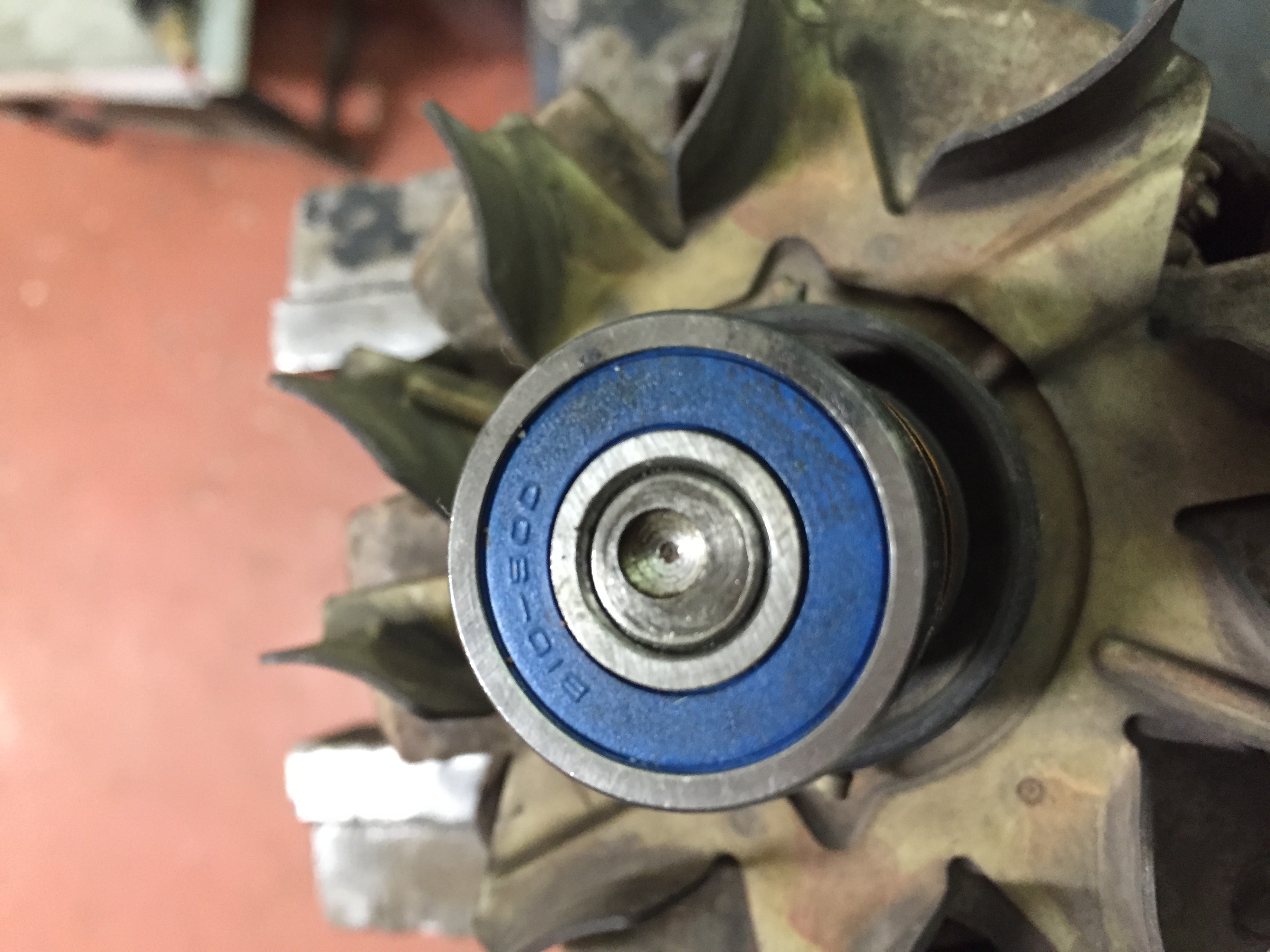

Here is the one picture of the front bearing of the bearing and the rear bearing is a 6306 rs bearing
hope it can help a patroller along the way

NISSAN MAXIMA V6 se aircon motor, alternator, en bearings pas op die ZD 30 motor .. ten minstye tot 2003 .. wetie offi niewes anner geite hettie
