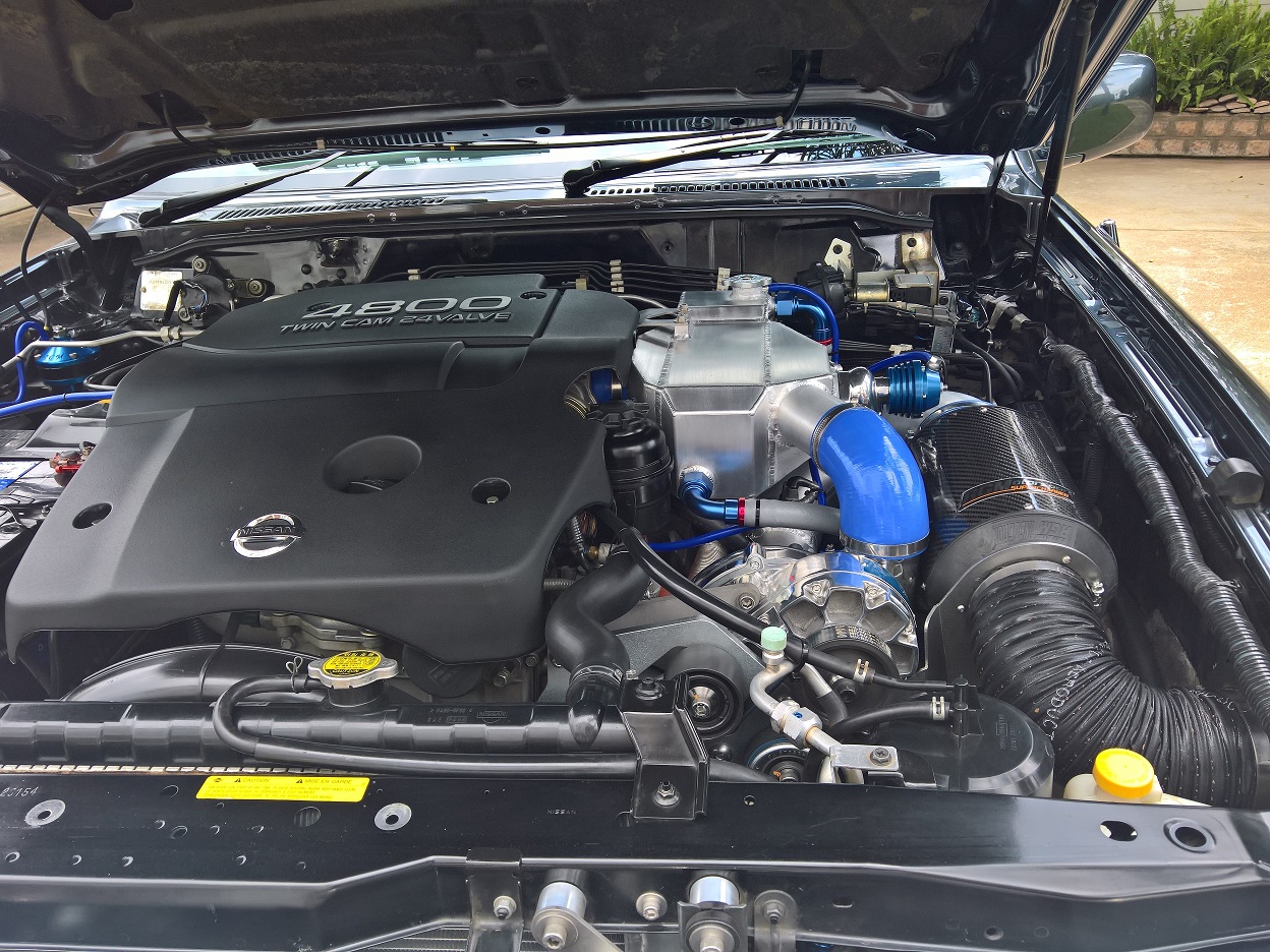

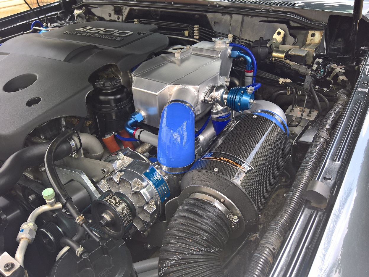

Well, I went with what I believe is the right option.
I maintain Turbo for Diesels and Super-chargers for Petrol.
I'm very happy, unfortunately with the wind and the rain over the weekend I couldn't test to see if I achieved a fuel consumption gain.
The Patrol is undeniably more drive-able, rather than being cumbersome and weighty.
I have a fairly conservative map just to let things settle and will remap in the new year.
Current figures are 685 NM of torque and 226 wheel kilowatts. That's a whole 100 more than I had before.
The beauty of the the super-charger is its linear power delivery so wherever you want to be, its happy.
I hit the speed limiter (200 indicated) in 4th and 5th a number of times, without wanting too, the limiter will be removed in the new year and I want to install some gauges for oil temp, oil pressure and water temp, so that I can monitor those as an indication of what is happening under the hood.
My experience is that the additional power available keeps the torque converter locker up at lower speeds, so for example at 120, up a hill, it will stay locked up which I prefer.
I kept the exhaust system I have to reduce costs, which I believe may be the reason I've lost around 8 kw at the top, but nothing you'd notice anyway.
The reality is the Patrol will take any hill you can throw at it and by the time you get to the top you'll be doing close to 200, alternatively will hold whatever speed you were doing to start with, irrespective.
In my opinion worth every cent.

My final take, is this, if one considers the relative low entry price into a second hand Patrol, 4.8 specifically, to spend a bit on this conversion gives you the ultimate SUV.
With the conversion you exceed the Y62 performance figures whilst retaining what’s good on the Y61.
And you are still within budget compared to similar Toyota.
Driven reasonably, I don’t believe reliability is compromised at all.
Obviously pushing it to the limit all the time will, but then it is no longer necessary.
I needed to drive the Patrol far harder before, its effortless now.
Love it.
