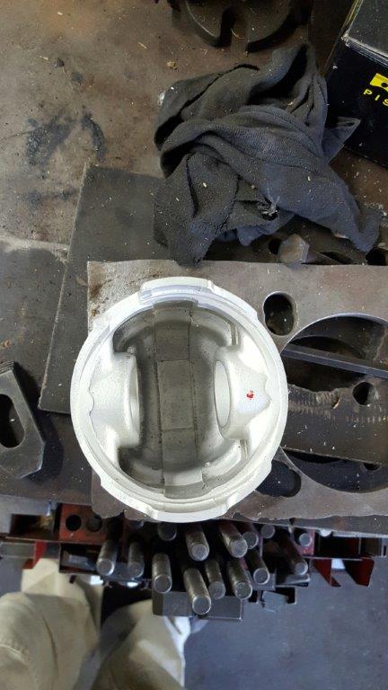

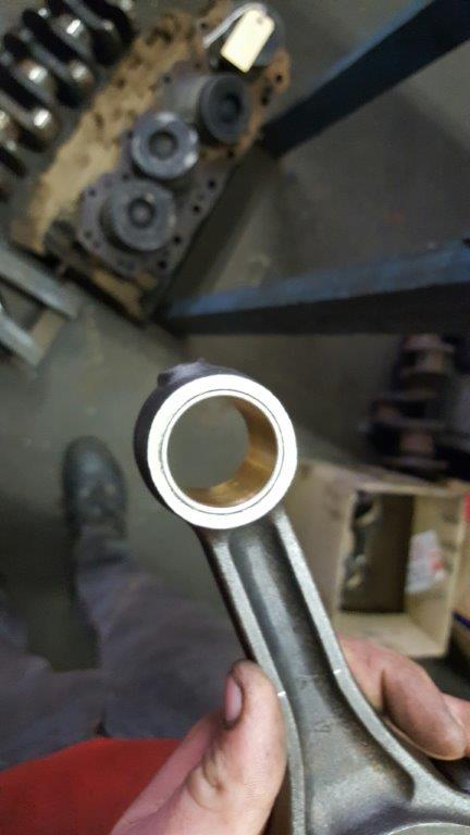

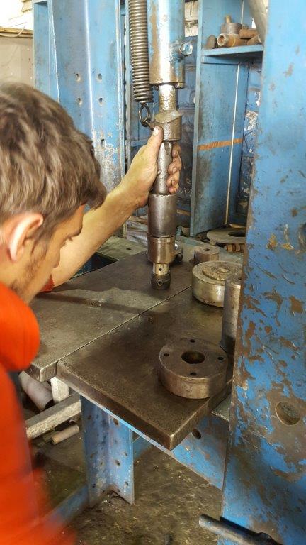

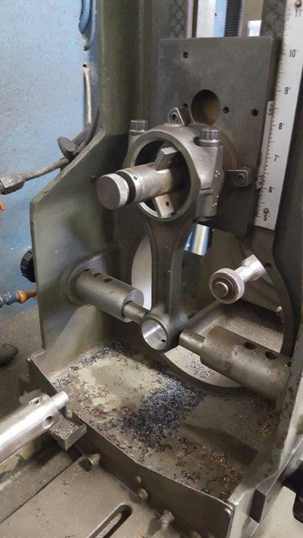

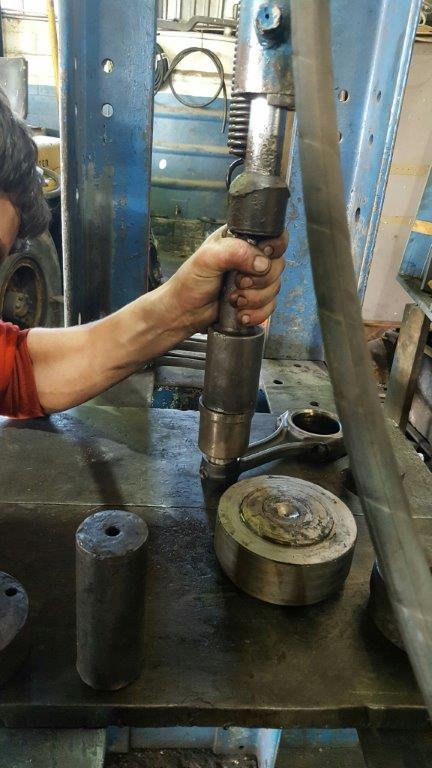

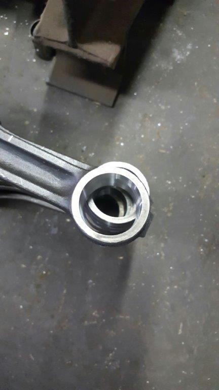

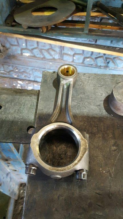

Below is a few pictures of the resizing of the conrod small ends to fit the new pistons. It is very interesting to see all the engineering work being done, for me that does not see this type of thing every day.
Hope it helps others as well. :thumbup:
New pistons top view
Resizing to 30mm
Resizing to 30mm
Resizing done on small ends
Filing any rough edges away
Pressing in bushes
Pressing in bushes
Pressing in bushes
Pressing in bushes
New bushes in
New bushes in
New bushes in
New bushes in

Thanks. Not often one gets to see these processes, as you say.
Re: TD42 Rebuild
Very cool to see this!
:thumbup:

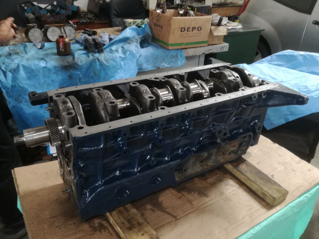

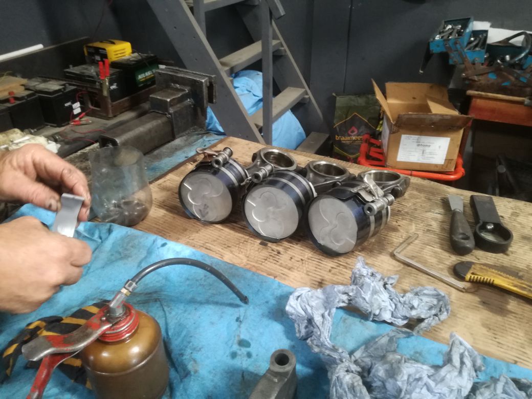

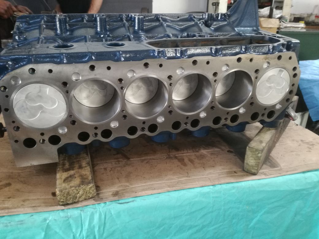

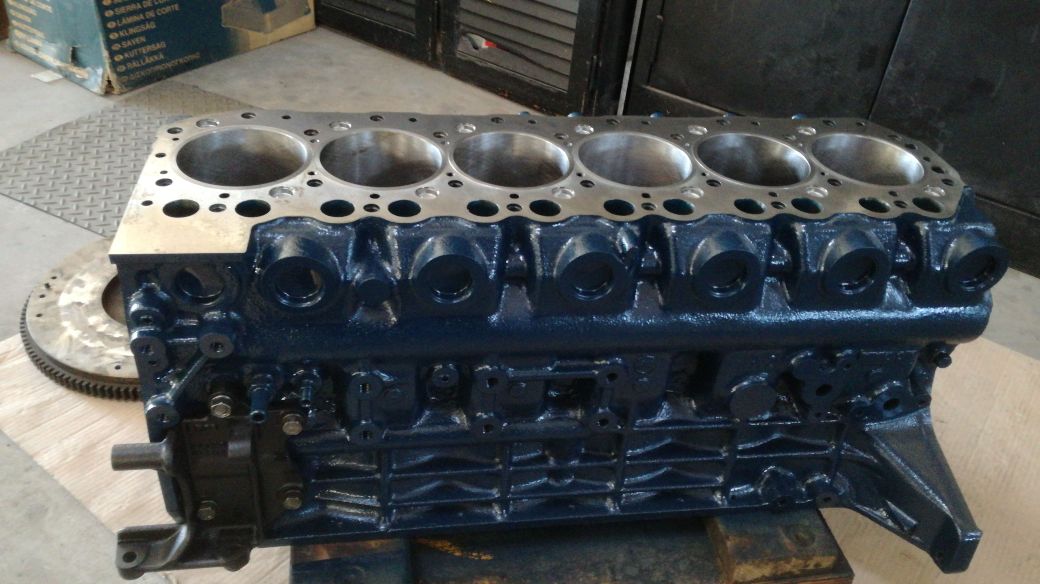

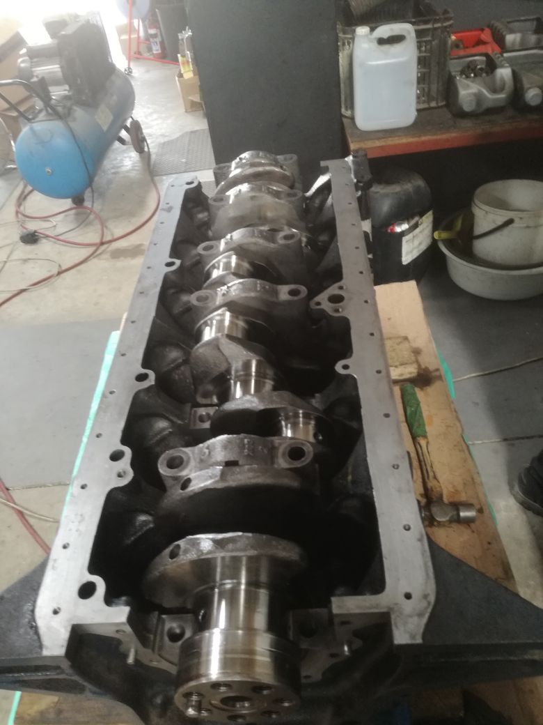

Progress! The block is cleaned up and painted, assembly finally started this morning, now just to check the piston protrusion :pray:
A clean start
A clean start
Piston, bearings install
Crank
Crank
Crank
Crank
New pistons in
New pistons in

Thats looking good !!
Re: TD42 Rebuild
So nice!!!
Been thanked: 430 times
Re: TD42 Rebuild
Baie mooi Rudolph!

Re: TD42 Rebuild
Post by Florian320 »
That looks great and as new!
Congrats!
