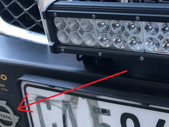

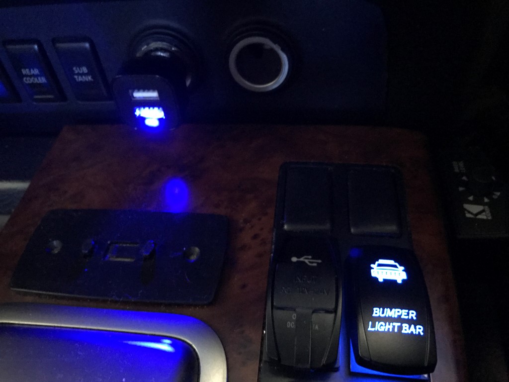

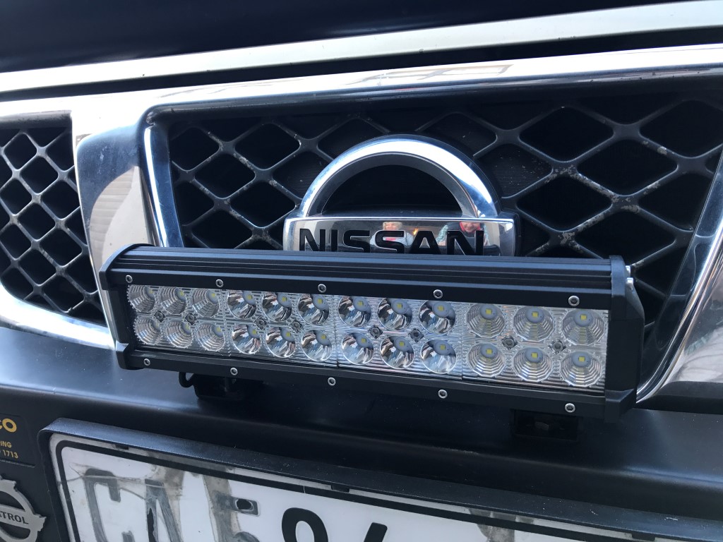

A simple mod, but hells bells, getting through the overfull, firewall grommets was challenging. I decided on a small, 12'', LED Light Bar Nilight because I was weary that it might interfere with the radiator airflow, BUT, in retrospect it is way too small and should've gone for a 24''+. Unfortunately, the mounting now hides the Nissan sign on the grill. But on the positive, the impressive white light makes up for the effort and I can highly recommend this mod. I also installed a dual USB charger ports. I had to file the openings slighly bigger to make the switches fit.

2. LED Light Bar Nilight 12 Inch 72W LED Work Light Spot Flood Combo LED Lights Led Bar Driving Fog Lights Jeep Off Road Lights Boat Lighting ,2 Years Warranty
$19.01
3. MicTuning LS081502JL Backlit Bumper Lights, Rocker Switch Kit, On/Off LED Light, 20A, 12V, Toggle, Blue
$9.99
4. MICTUNING Universal Rocker Style Car USB Charger - with Blue LED Light Dual USB Power Socket for Rocker Switch Panel
$10.99
