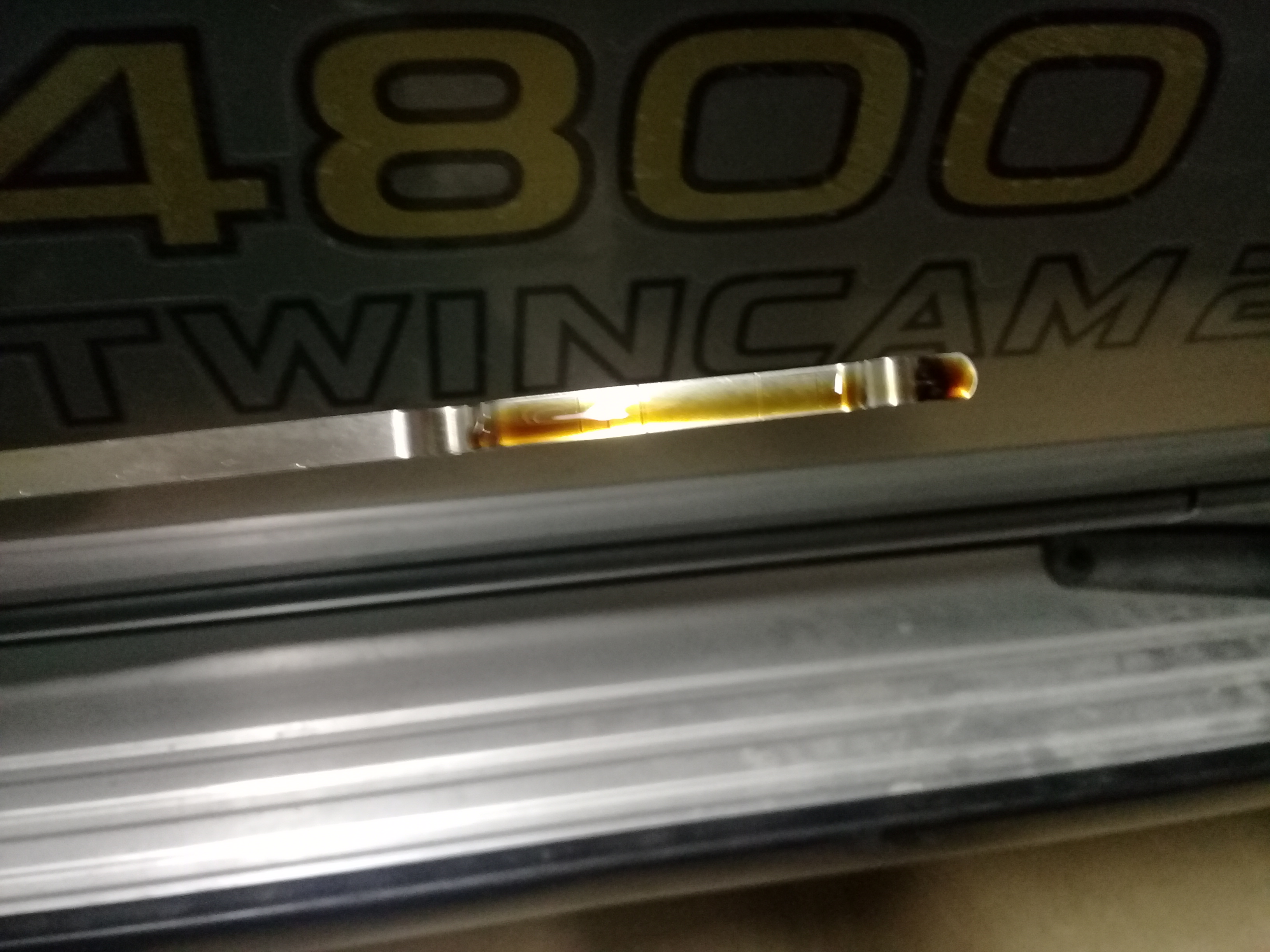

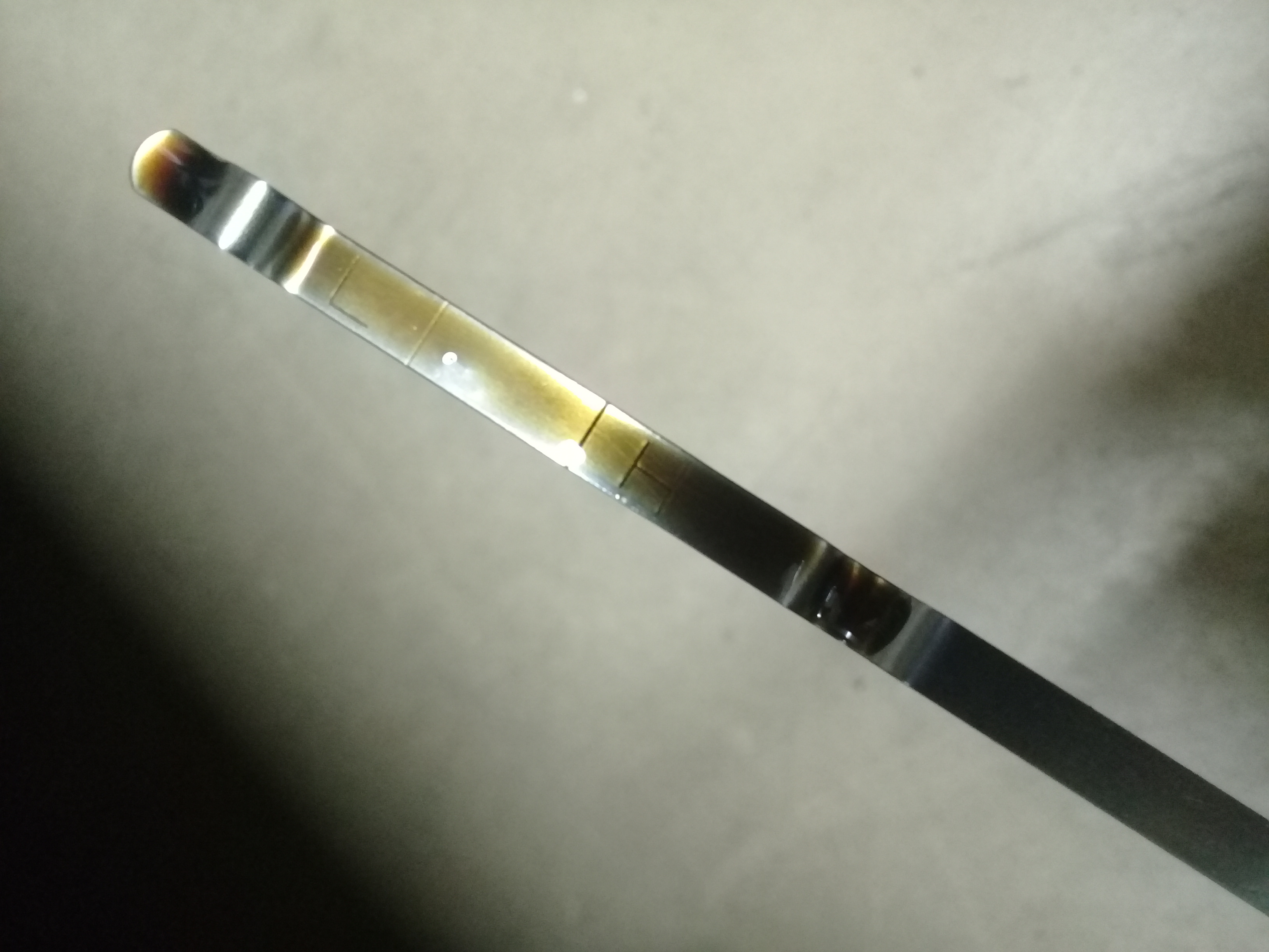

My advies moet wees, koop n petrol. Ek het my 4.8 vrydag gediens. Die naweek gery en die olie is skoon.

Ya, Josh, I also envy the colour of my 4.8 oil, even after 8 months, compared to my land cruiser after 1 week.JoshJ wrote:My advies moet wees, koop n petrol. Ek het my 4.8 vrydag gediens. Die naweek gery en die olie is skoon.![]()
