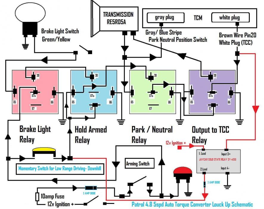

I must say the torque converter unlocking before the decision to accelerate has actually reached your foot is rather annoying. So if it is not too complicated to DIY I would definitely be keen

JP, any chance you have that picture on the thread? I can't remember my password for the auzzie site and before I go through the whole story....
But what could possibly go wrong with this mod? And I mean that genuinely, I want to know
before I even consider it.

Is this the pic you mean??
- TCC-03.jpg (93.09 KiB) Viewed 4648 times

That's it I suppose, thank you! Long weekend ahead, so I will look at it and contemplate...

Any large negatives that could result???

Rhett,
Were you able to try the mod?
What was your experience?

Hey RiaanBruin Beer wrote:Rhett,
Bruin Beer
Sorry I somehow thought I'd replied and now see I didn't.
I have not tried it yet, but not because I don't want to
I have to find out first why the beast can't keep a steady speed when setting it in cruise control. It keeps hunting gears when cruise control is set and can't seem to settle at a speed regardless of how fast and flat the road is. My final goal would be this mod, together with the manual mode mod so I can do longer trips without 'crampy ankle syndrome'.
Has anyone else tried it yet?
