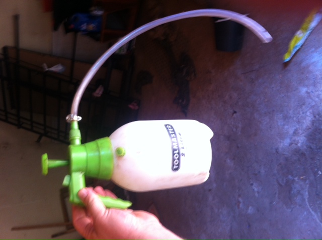

Thought the transfer cas only take 1.5liter?
I also need to change my 4.5's gearbox and transfer case oils.
I got one of those gardening spray bottles with the hand pump. Usually used for pesticides, weed killer, etc.
Attached a tube/pipe to it. Used this to change my bakkies diff oil. Works alright, but i have also wondered if there is not an easier way. (Faster way).
Have also seen someone using a container with a valve attached to it - the use a compressor to pump the oil in.

Mine:
