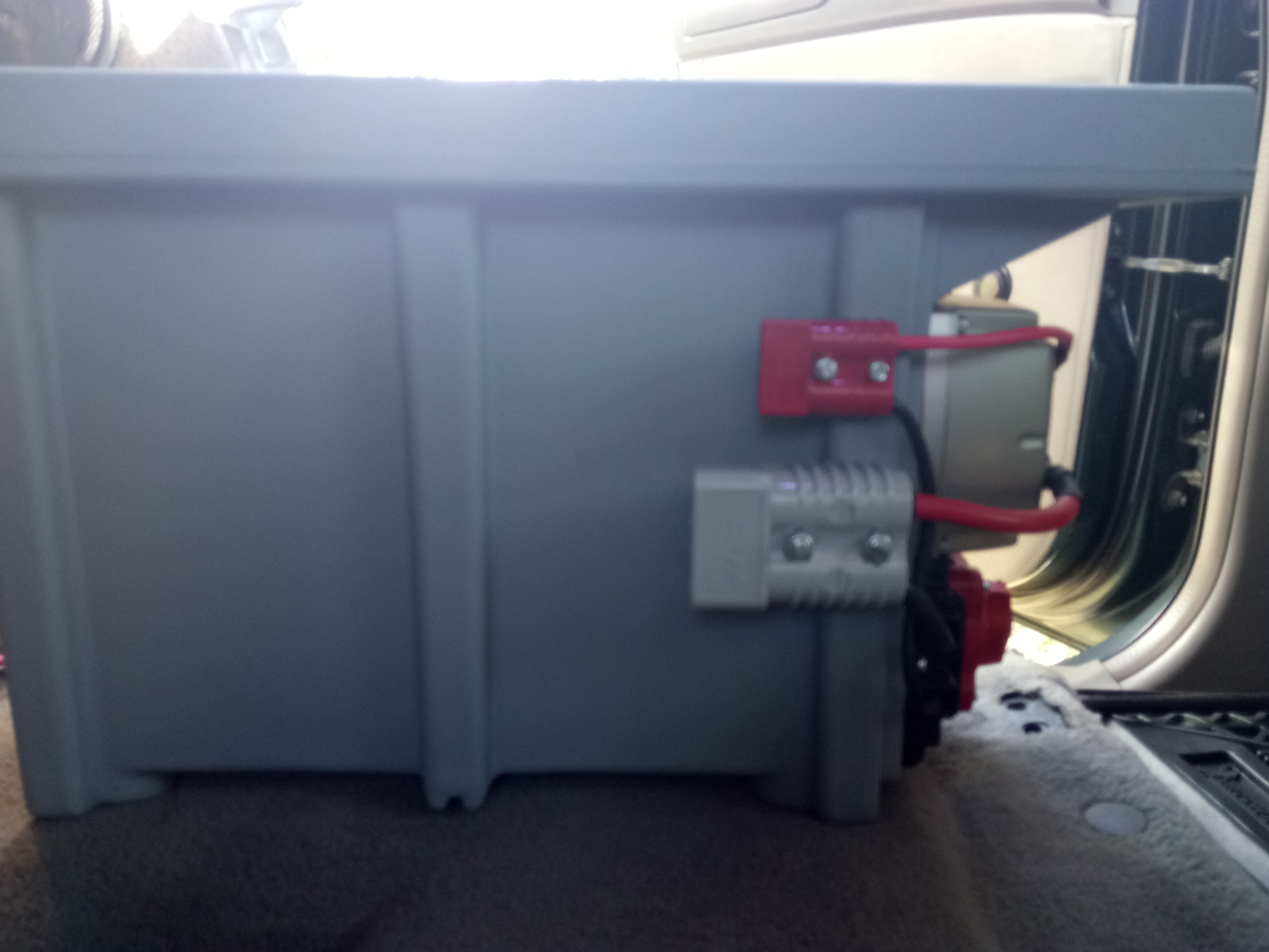

The idea behind the box is that I can leave it in the vehicle or remove and leave at a campsite with the fridge etc.....
If remaining in the vehicle I have a solar input plug and 12V input or output in the back bumper which can plug into the box inside.

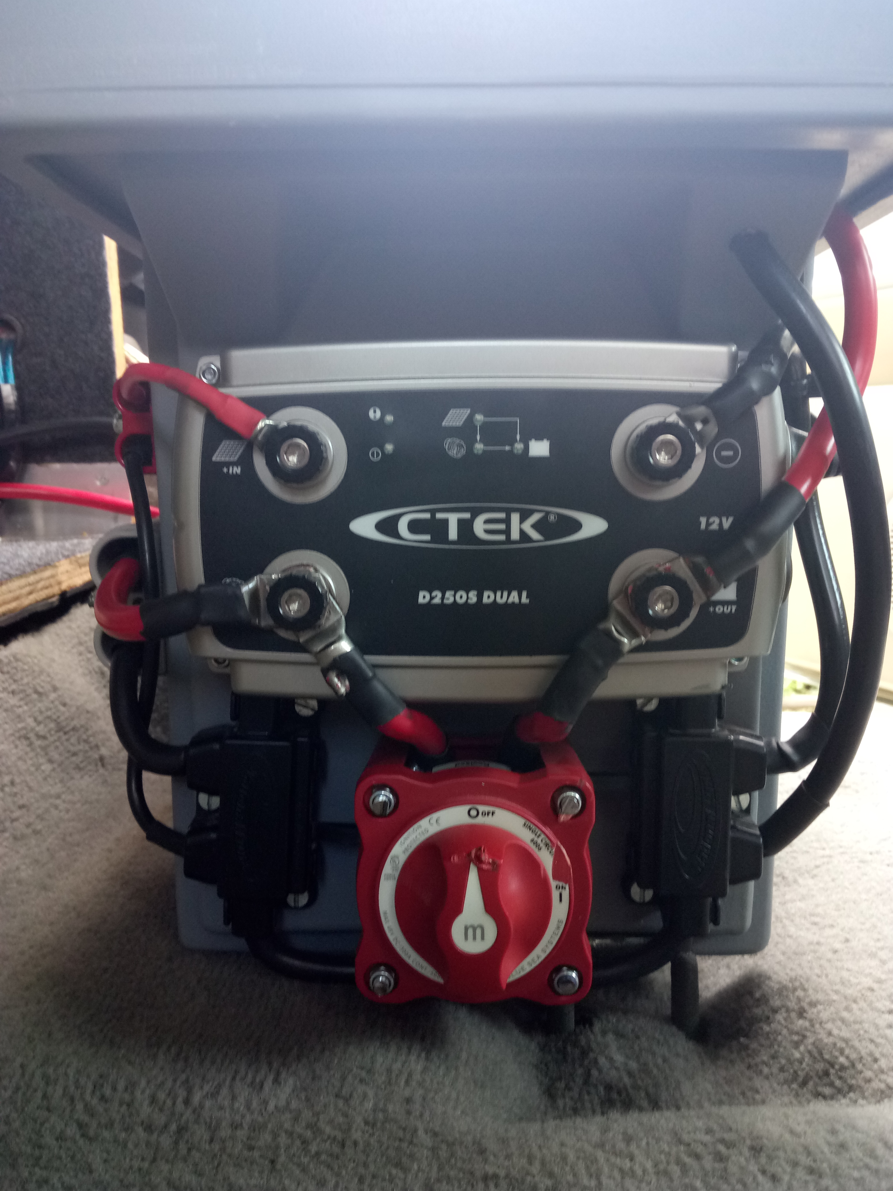

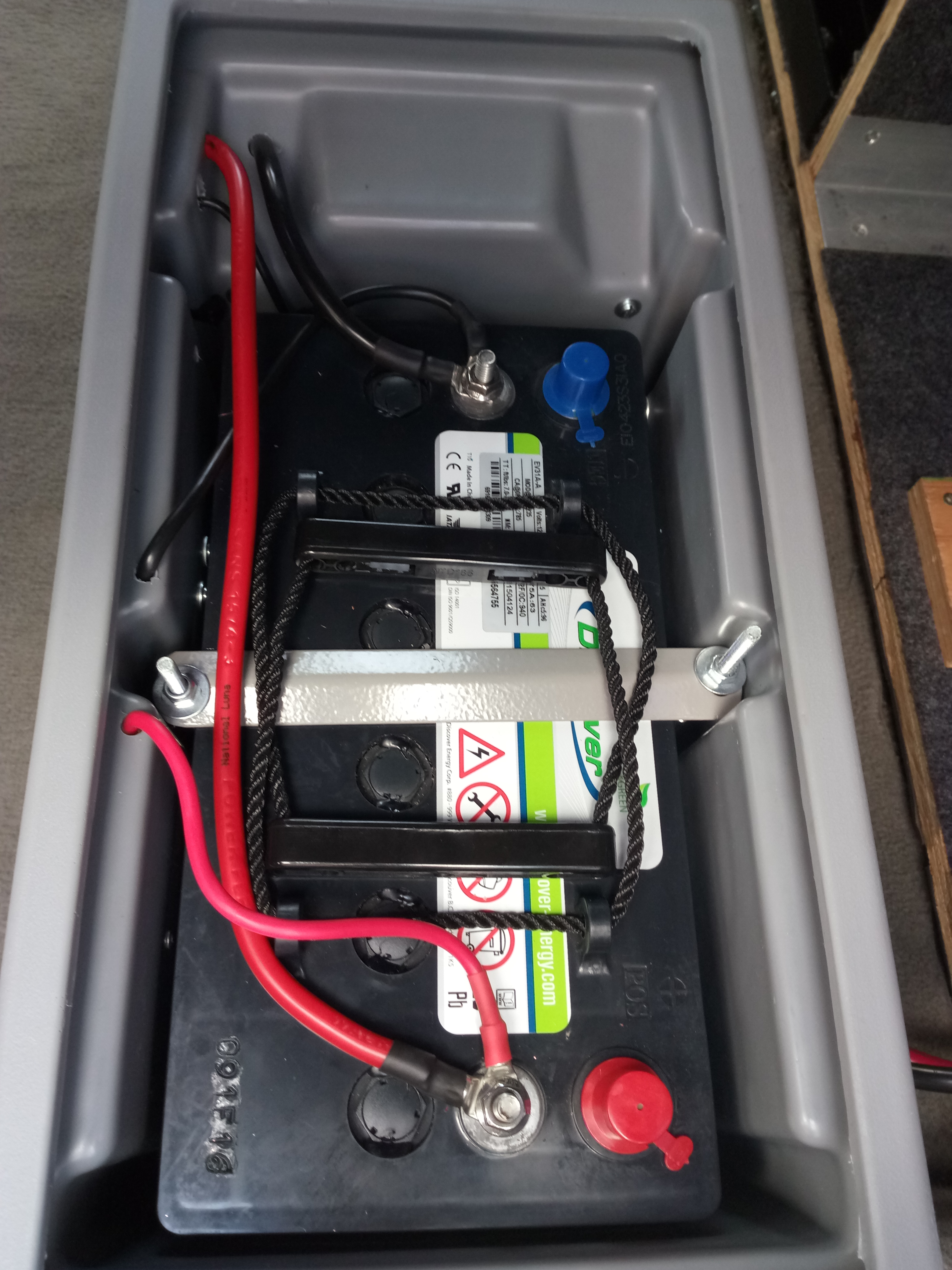

Inside is fairly basic with battery cable input from C Tek and decent wiring to the outputs as well as the C Tek's temperature sensor.
Power station input.jpg (2.46 MiB) Viewed 7792 times
The red is for solar in to the C Tek and the large grey is from the cranking battery with battery cabling.
Power station C Tek.jpg (2.86 MiB) Viewed 7792 times
The C Tek has a marine switch as a bypass for if I want power to the front battery for winching or starting if cranking battery packs up.

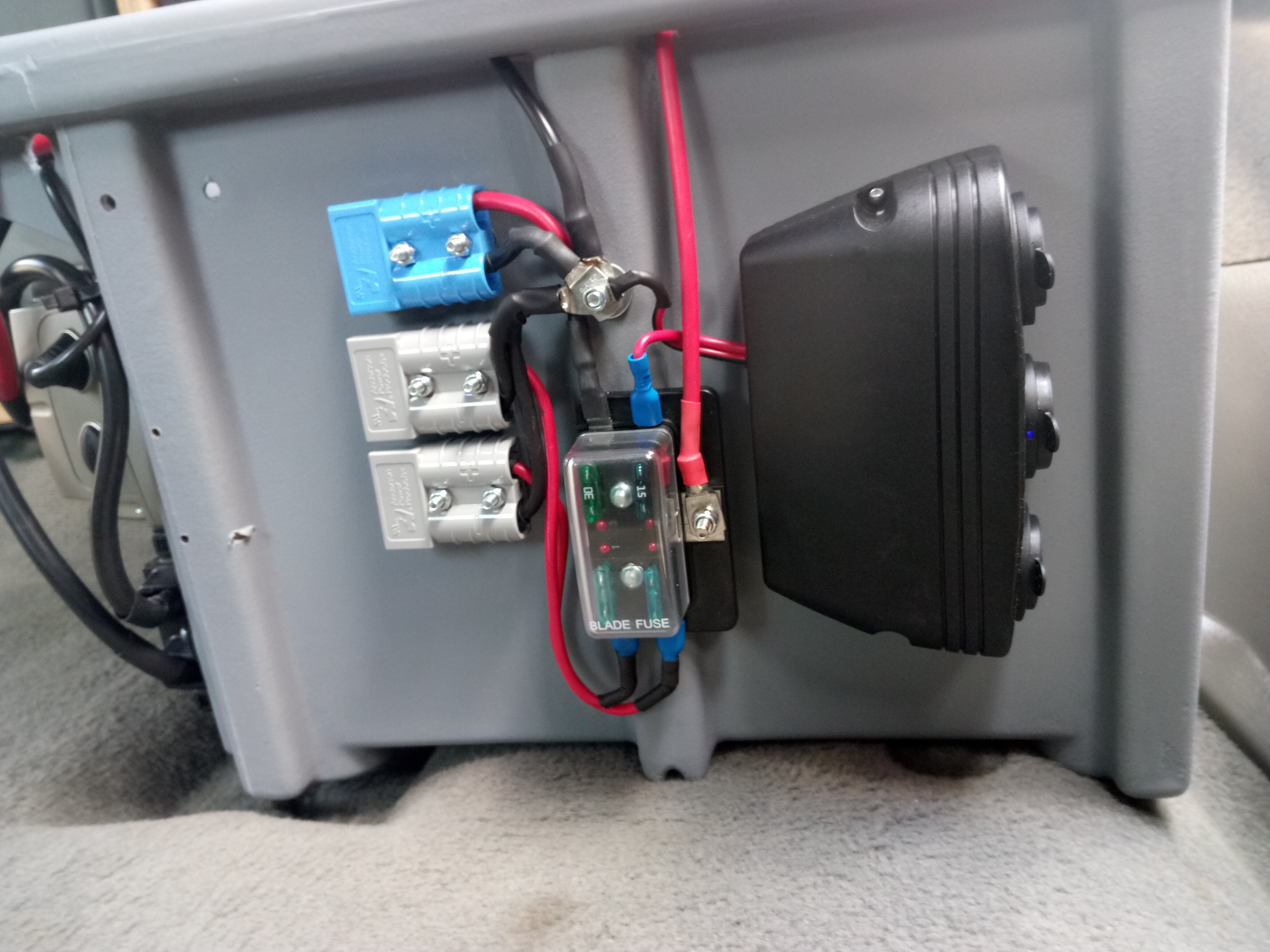

Power Station output.jpg (2.86 MiB) Viewed 7792 times
There are 2 grey inputs/outputs, a blue input/output for higher amperages (eg. inverter), double 2.1A USB, Hella and cigarette connections. As mentioned earlier one of the grey connectors connects to the back bumper if required so I can leave the car locked while for example charging the battery from 220V. Each of the inputs/outputs is separately fused and if a fuse blows a LED lights showing which one.
