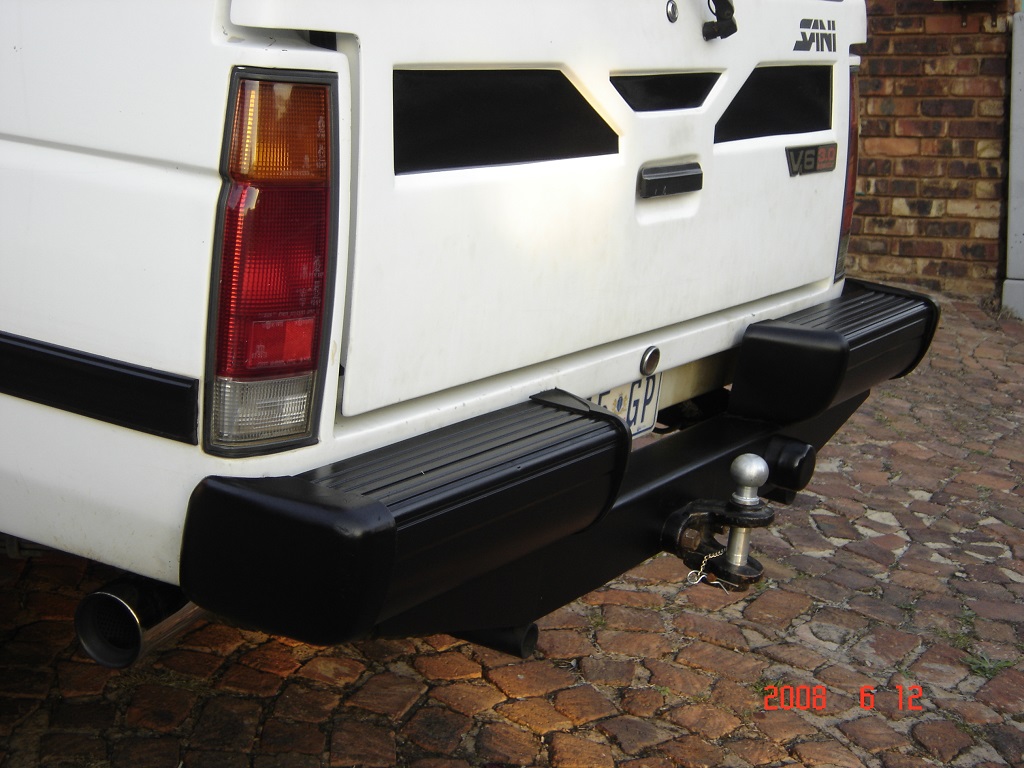

Does anyone know of someone who has a back bumper for a 1993 SANI lying around collecting dust? A pensioner mate of mine did a magic reverse trick with an epic fail rating...... :rolling: :rolling: :rolling: .... shame I shouldn't laugh, cause I did a similar thing with my SANI many years ago..... :redface:

I twice needed a Sani back bumper as I bought them already not great and could never find one for love or money. Take the pipe bumper from a Hardbody or Colt and modify the brackets. If I remember correctly the Colt's was actually easier to modify. They should be available cheap on Gumtree/OLX etc and if you need I have a connection for powder coating.

That bumper should be the same as most of the Hardbodies of the day, so scrapyards could be your best bet.
I had a 97 bumper (plastic section) that I was saving for just in case. But I landed on a rock with it and the lower section had shattered. I was glad to get it off the car, along with its steel carrier, that bumper weighs in at around 50kg. I can add a bunch of steel bits for 50kg, and I have already started by adding two 16mm plates to the carrier of the towbar onto the chassis that work as recovery points.

Yo Bro .. At one time somebody gifted me an ISUZU bakkie rear bumper .. one of the members of the then NISSAN 4x4 website took it off my hands and fitted it to the back of jis sani .. AND it fitted. Looked good too.
Wie ?? nee maskas, dit was 2004 .. kannie so fyn onthou nie

Kagiso II wrote:Yo Bro .. At one time somebody gifted me an ISUZU bakkie rear bumper .. one of the members of the then NISSAN 4x4 website took it off my hands and fitted it to the back of jis sani .. AND it fitted. Looked good too.
Oompie Mac, my Sani het so Isuzu bumper gehad, maar ek kan ook nie meer onthou waar ek dit gekry het nie :rolling:

Christo, was it a straight forward fit or did you have to modify anything?

YIPP Christo Slangman .. Dit was hy daai ..Nadat ek die vorige ge pos het, het ek onthou ek het hom aan jou gesmous. 2M gekry oppi koop toe en jy het my gebel toe hy opgesit was om te kom kyk .. Jou SANI se agterdeur het nie perfek gepas nie, as ek reg onthou??

Sorry bud, can't remember that far back! But if it did require modding, it could not have been much for me to forget about it completely?
Oompie Mac, ek glo daai bumper het baaaaie lekker gewerk. Beter departure angle en ook heelwat ligter as die Sani se standaard rubberige gedoente. Die deur het ek reggekry met baie verstel & daarna met skuimrubber goeters waar die verstel nie wou help nie...
