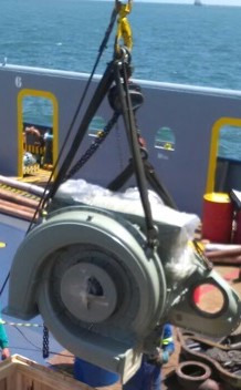

Allbilt wrote:
The attachment Conversion.jpg is no longer available
The first few measurements done...
And this is the turbo ordered to give it a bit of extra oemf
