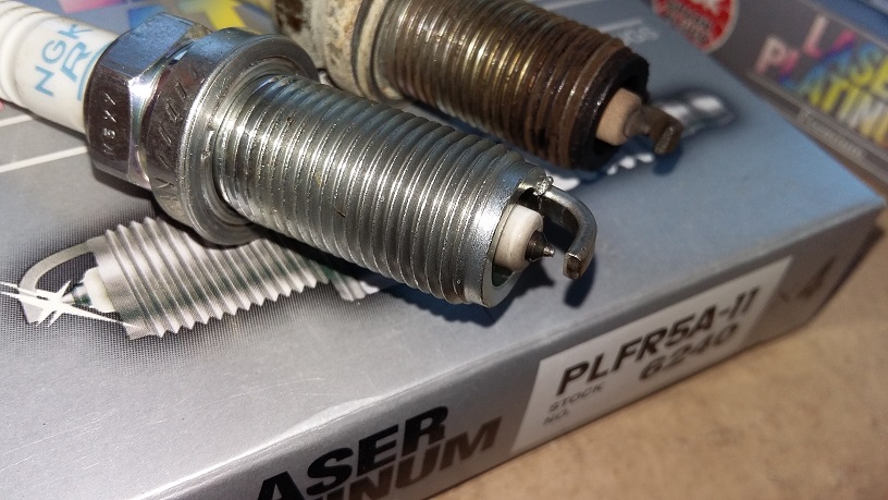

100k Km later...4.8 still purring like a kitten I decided to pull the plugs again
Here are the results: Gap grew by only 0.03 mm over this distance. I didn't replace any gaskets - just reused the old ones
