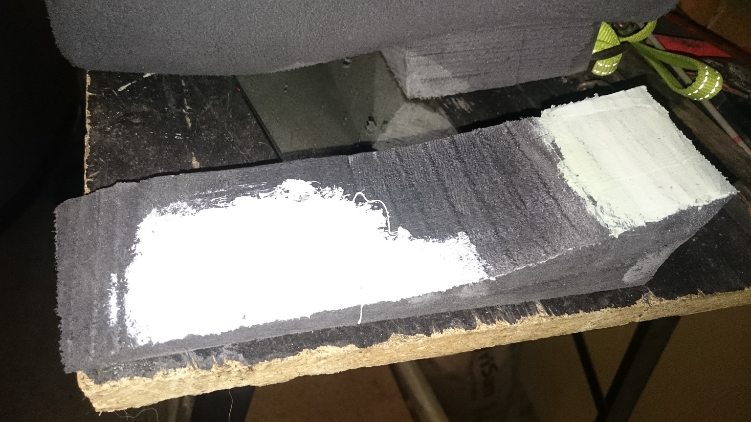

Ok... so I did a quick tester on an offcut piece of foam....very interesting results...
I coated a section with plain old cobra floor polish ( i know its not the best stuff but its all I have at the moment ) and it seems to settle well on the foam leaving a nice looking barrier. On another section ( unwaxed ) I put some body filler directly onto the foam. This seemed to adhere nicely to the foam. I then took some gelcoat and applied it to both treated (waxed) and the untreated section of the rubber and left it overnight to see the results.
After 14 hours the sample is in exactly the same condition as last night !! considering that the fibreglass resin will not be in direct contact with the foam I didn't put any on as the gelcoat will be the barrier ( and the PVC mold release ). Here is a pic of my test sample.....
