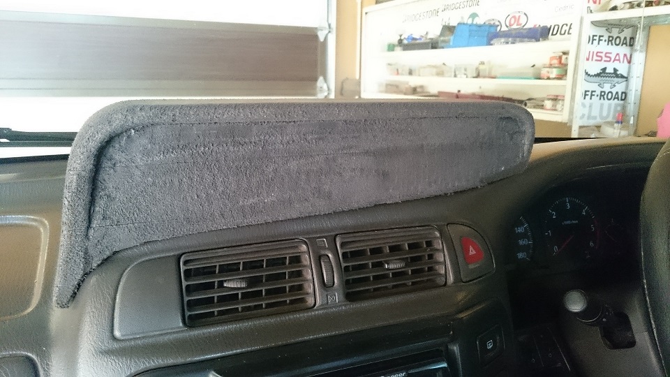

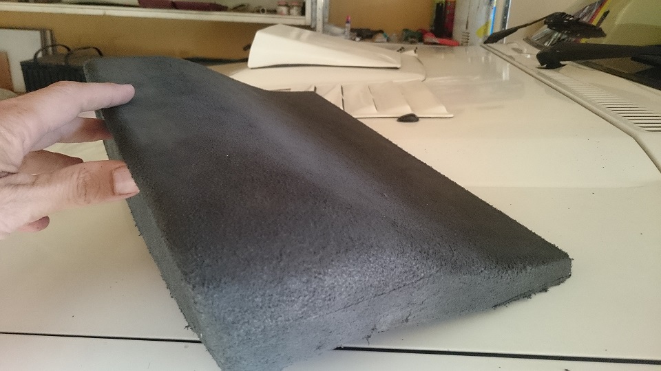

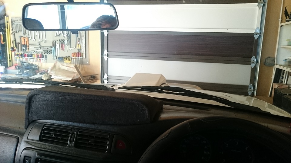

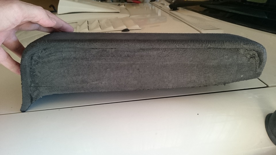

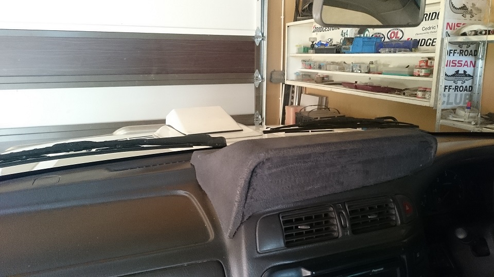

Here are a few pics of the foam plug.....
The first 2 were to try give an eye line view of how it will look ( to see over the bonnet ) from the driver side, and the back seat driver (aka - passenger side )
