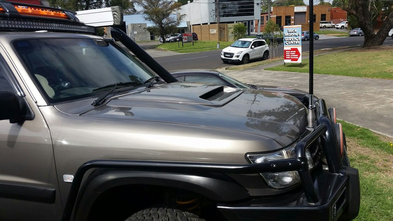

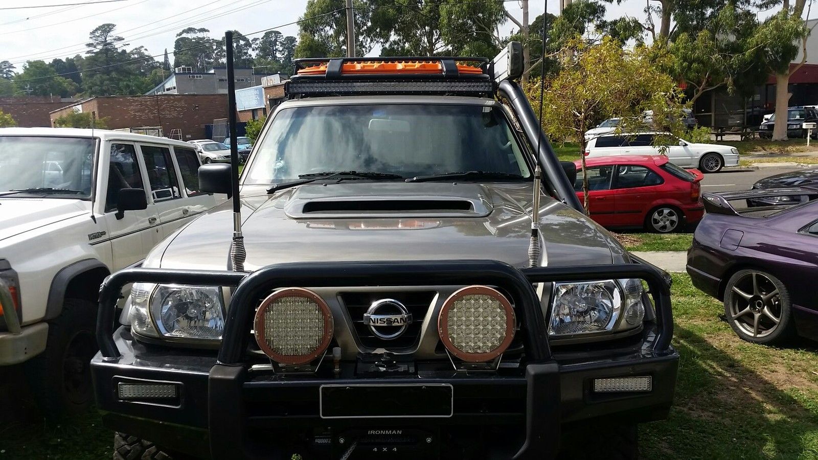

Starting to gather all of the parts for turbo my donkey cart.
So far I've got the manifold and turbo, now I'm busy sourcing the intercooler (90%), Madman, aneroid fitment & pump mods, making up a dump pipe with a small trick to it so hopefully better flow, exhaust system and all the little extras.
Going to do something a bit different for a bonnet scoop for the top mount.
Going to source a Land Cruiser 70/79 series scoop adapted for the Patrol, seen them on Ozzie trolls and it looks really wicked (even if I am soiling my troll with LC parts
Stripped the entire intake system yesterday and measured up to start planning everything for the build.
Came up with a cunning plan for the air box, hopefully it works.
Going to either source a K&N or BMC high flow cone filter that will have sufficient surface area that will hopefully fit into the existing pre-filter cyclone unit (with some mods), that way there's minimal fabrication work and the mating to the snorkel isn't disturbed.
Otherwise I will fabricate a larger diameter air box in the same position to house the filter.
I'd love to have it all done in time for Christmas (would be like choo choo the red nose Patrol
) but with plans to go out of town on holiday, it will most likely only happen Jan/Feb 2017.
The aim is to have it done before my birthday in April next year...sort of a "to me, with love from me" kind of deal
