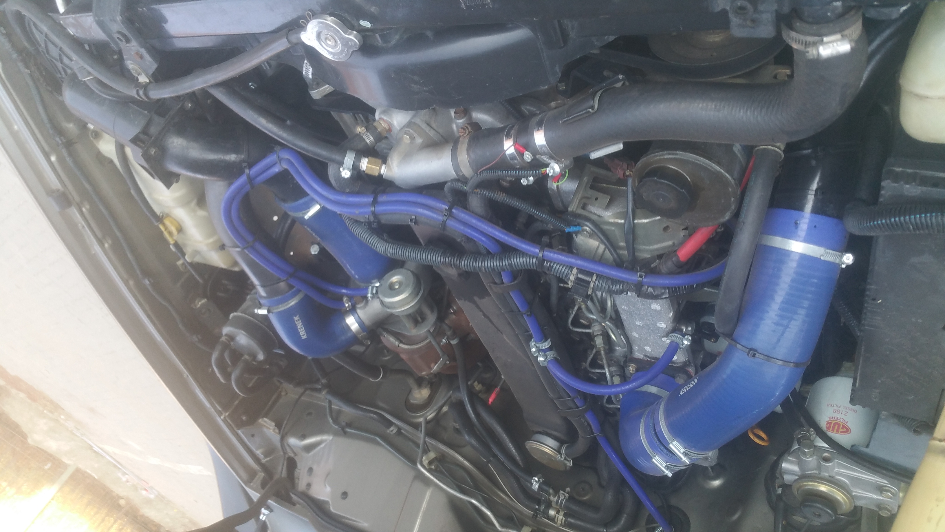

Cedic they want dik money for that and guys like andre steyn says his welded one is letting him down ....probably a reason why they make manifolds from cast iron in the factory. ....i will wait and here from Piet on that one ......i like the top mount turbo more ...UD does it that way ....let me put a pic .

Cedric, you talk about having a branch setup on the Maiden.
Is it something like this ?
I would imagine the welds or pipe seams would be the first to let go if something has to give.
But, if it ain't broke, don't fix it
The cast iron manifolds would take up a lot less space and have less of a fulcrum action with the turbo hanging off of the end.
