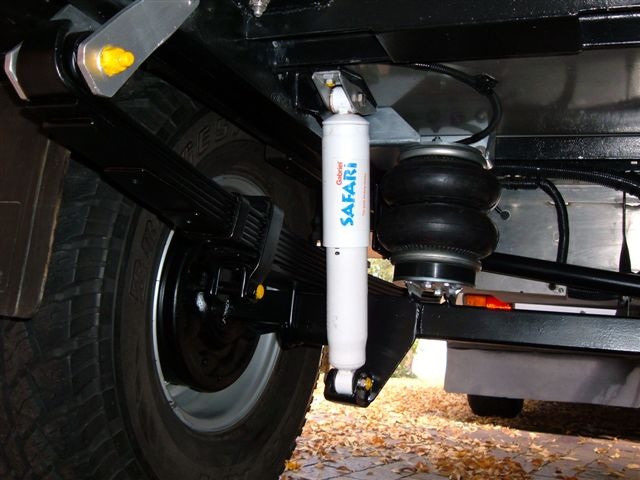

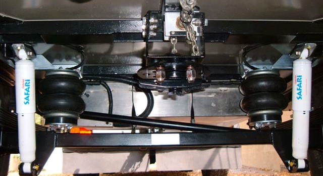

I agree with you that the manufactured trailers have very little wheel travel so also built my own trailer fitted with a braked axle rated at 2.5 tons, 1.2 meter leaf springs, panard rod, shocks and air-springs each rated at 1.5 tons...wheel travel is just under 200mm.....attaching a photo. I still bought the 5 Nissan steel rims from you for the trailer to match those fitted to my Patrol!!

So it's obvious that there are a few souls out there who have realized that the limited suspension travel on most camping trailers sold in SA is a problem for people used to driving real 4x4's.
As you have proven, it is possible to get good travel out of a leaf-spring setup, but the disadvantages of leaf springs is that the travel is at least partially a function of the length of the spring (there are two ways to gyppo this, but both have their own issues. The one is revolver shackles, but they only work on 4 or more wheels and even then only in low-speed situations, the other is parabolic springs, but they are eye-wateringly expensive), and longer springs become exponentially heavier. The other problem is not so much the fault of the springs but of the live axle, and that is that the chassis has to be mounted above the axle's highest point of movement.
In cars, they do this by putting curves in the chassis, but again in home-building this is difficult, heavy and expensive. The alternative is a much higher center of gravity, as the space below the chassis is difficult to use (at least mentally, as one could put tanks there, but because they need to fit fore and/or aft of the axle, they will have a far greater effect on weight distribution).
However, as mentioned before my primary objectives were light weight and good suspension travel, combined with good stability (and thus a low centre of gravity), all the other methods I could think up simply compromised one of my main targets more than I was comfortable with.
Daniel it would be interesting to know where you have been with that setup, and whether the air springs have given you any hassles?

Peter I keep a log book on the trailer and have to date towed it more than 30,000 kms and not a single problem to date.
The trailer has been to Namibia, Swaziland, Mozambique, Botswana and Lesotho.
Many trips to the Kgalagadi and on some occasions to Mabua Sehube via Nossop and the dune roads.
On one trip to Moz we did the Pafuri to Vilancoulis track road.
The trailer handles the bad and corrugated roads extremely well. My gas lights are in the nose cone and I have never replaced a mantel!!
