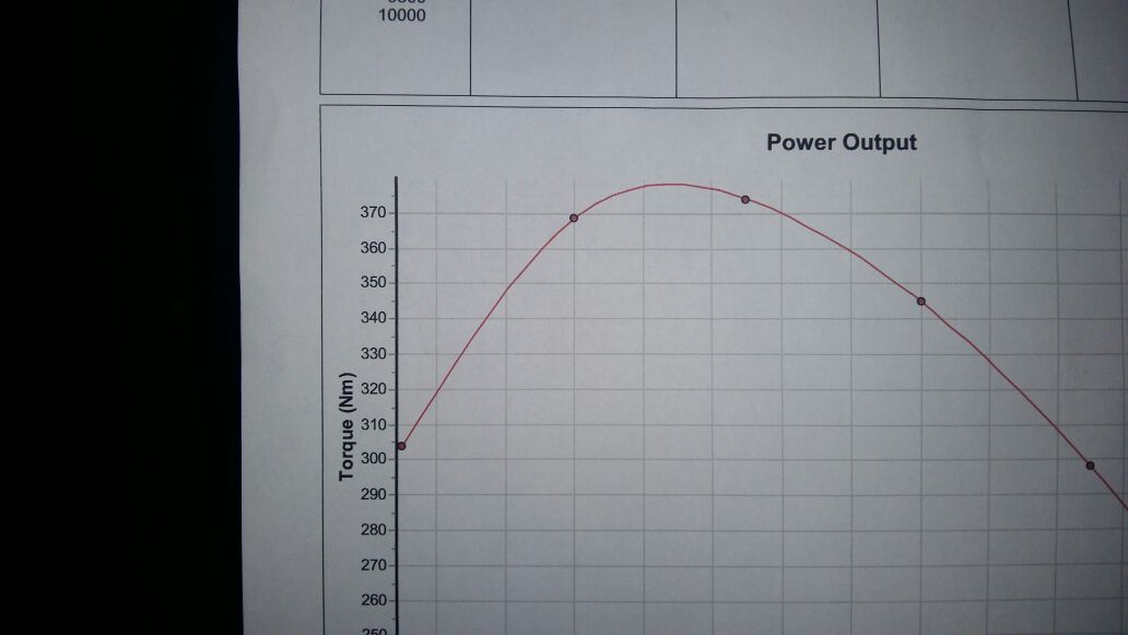

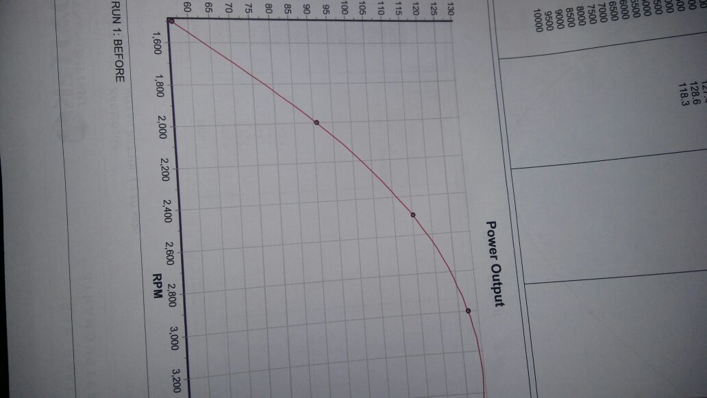

Nice Tinus !!
On the torque pic, at what revs do you hit max Nm. The pic doesn't show. I just want to see where your Nm starts and where it drops. Those are definitively neat numbers bud !!
Re: Hallo iNyathi
Cerdic i must say the thottle response without boost aneroid is slow or slower than iam use to . Also the power comes on later becouse of the lack of early more feul. This courses the turbo to spool up later at higher refs ...at the moment he is boosting 0.65 bar and looking good
I just look what Micheal does....and take notes ....give tools and some times help here and there .nice to be appy again :salute:
Been thanked: 430 times
Re: Hallo iNyathi
That engine can make good power if the oompie gets an intercooler, pump conversion and a 3" exhaust.
It is hard getting the fuel delivery optimal without the boost compensator, but those are good figures with the lowish boost and current setup :thumbup:
Been thanked: 473 times
Re: Hallo iNyathi
Nothing wrong with those figures !!
I was just curious with how the curve looks without the aneroid on the IP
