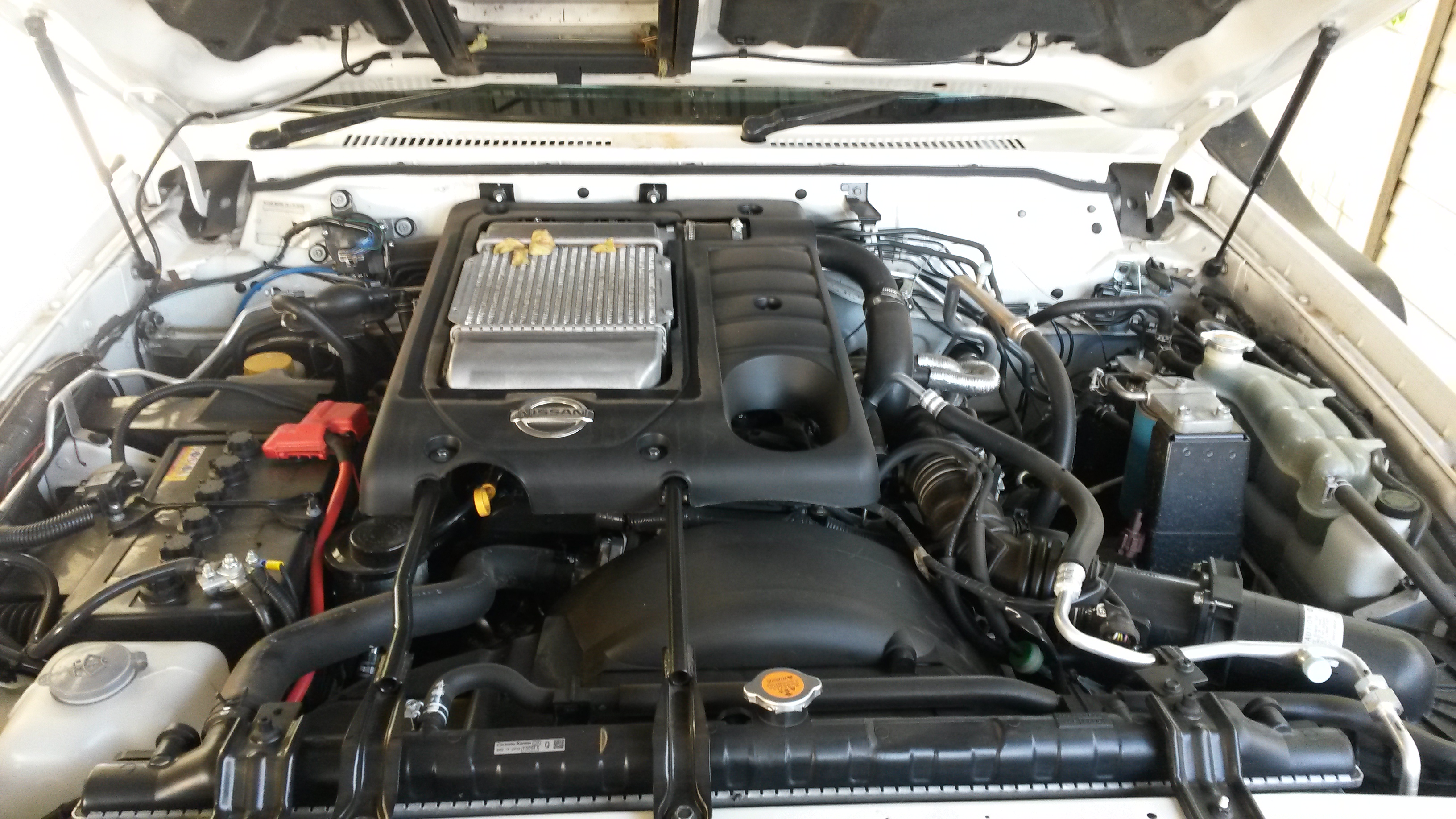

Hi Johann,
If you open your bonnet and it looks lik the picture below you have a common rail gen4. This is the good one. I have one. Only done 56 000km up to date. I will suggest removing the CAT's. I replaced my std exaust with 3 inch down pipe and freeflow. It reduced EGT's and increased torqeu by 60nm. I will stil suggest that you install a full madman system. This wil help you monitor everything on the car.

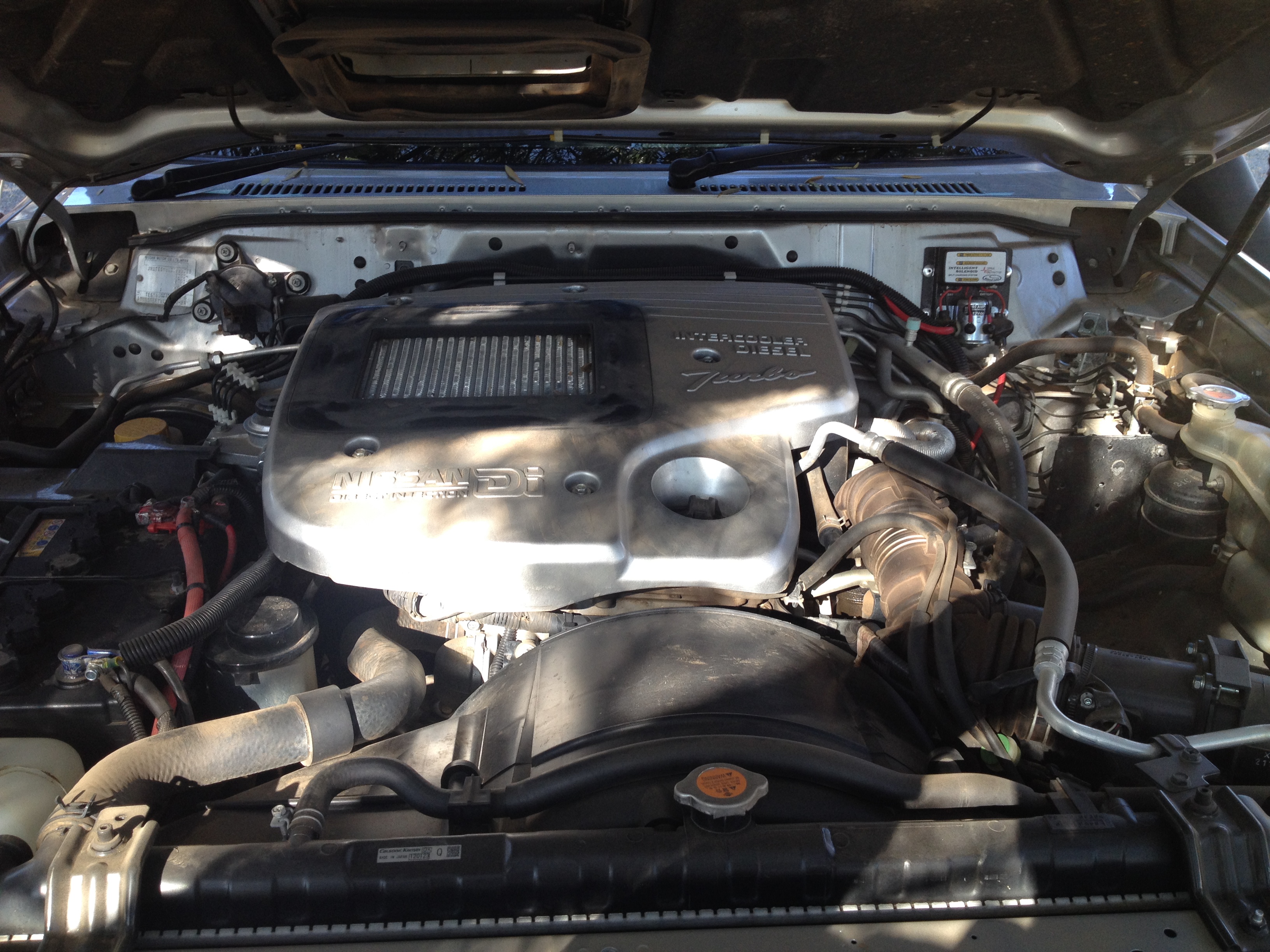

I am disturbed. My engine does not look similar to yours. I attach a photo of mine. It says Nissan Direct Injection Turbo Diesel Intercooler. I suppose it's a generation 3 engine then?
Johann
Johann

- Been thanked: 432 times
Re: The 3.0 GU Engine
Johann
You have a older gen 2 or 3 engine there and is not the CRD version. probably a gen 3 as you have a very late model
