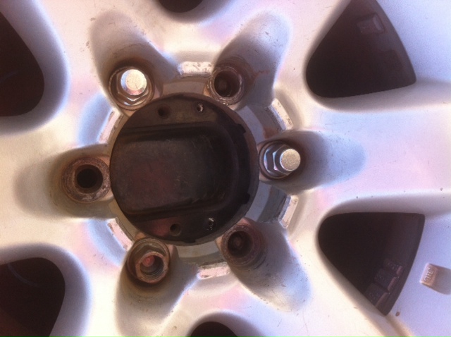

What my wheel looks like. it appears to have some sort of locking nut without the locking mechanism.
Midas got this, but I think it might be shorter than the nissan nuts/bolts.
Michael wrote:Ek het geen locknuts op my spaarwiel of die Patrol se wiele nie, hoopelik steel iemand dit dan kan ek nuwe rims en tyres by die versekering kry......... want dis al hoe wk nou nuwe bande sal kan bekostig :lol:
Klink na 'n plan. :thumbup: :lol:

Fanus myne lyk( amper) so maar myne werk nog met die kar sleutel daar waar joune oop is..joune se barrel is weg...
ek dink die vorige eienaar van my Patrol was baie heilig oor die kar gewees en was net deur die agente gediens gewees :thumbup: :thumbup:

I tried those exact Midas one's at the shop but they are short and although the thread did screw in it was not much and was not happy with the strength. Taking my system off on Monday and will give to you on river trip or post before.

Thought they look to short.
