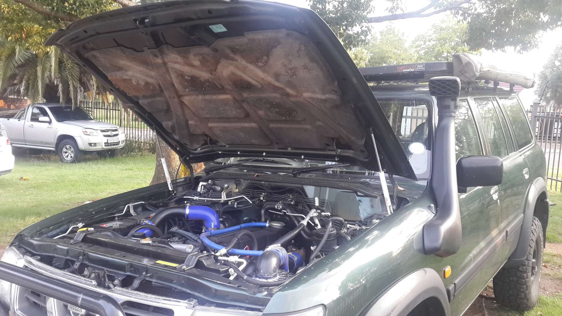

Bonnet Shocks
Shocks for Y61's seem to be very expensive and I got a part number for Gabriel's somewhere on the forum and they work great!
The open the bonnet even further than the originals and are very cheap. Pump them 400nm and Bobs your uncle
Gabriel 4141-210410

Michael wrote:Bonnet Shocks
Gabriel 4141-210410
Valuable info. I need to change mine.. :thumbup:

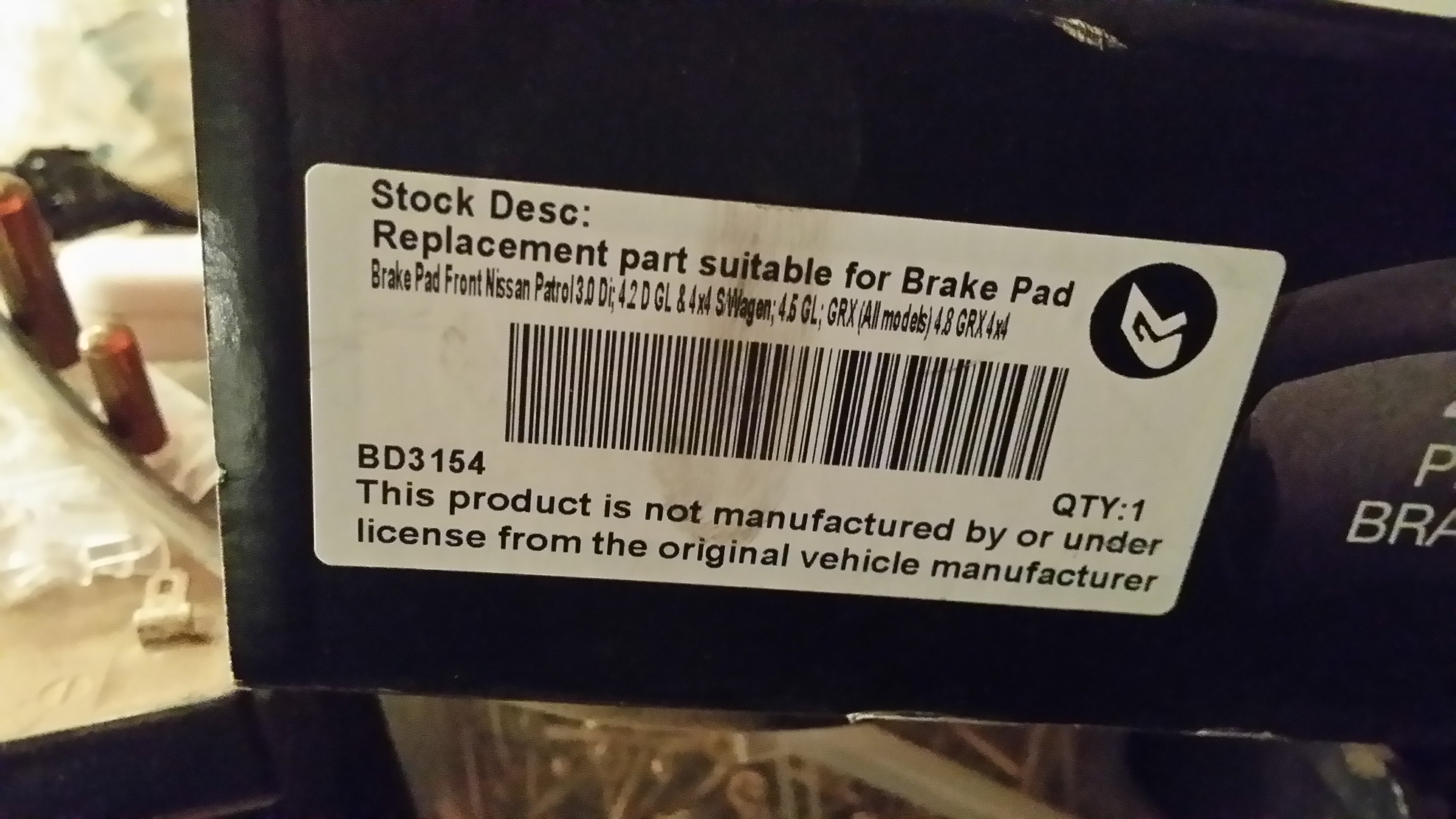

pdasilva
Posts: 123
Joined: 03 Jun 2011 14:07
Full Name: Paulo
Nickname: da Silva
Home Town: Kempton Park , Gauteng.
Current 4x4: Nissan Patrol 4.8grx
Suzuki Sidekick 1.6
Location: Kempton park
Been thanked: 4 times
Re: SERVICE ITEMS
Post by pdasilva »
Front brake pads for the Patrol from Star brake and clutch I paid R470.
