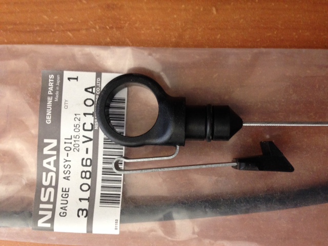

Its interesting as when I ordered the auto dipstick for the 5 speed box they sent me the older Patrol 4 speed auto dip stick and it has a locking mechanism on it so it can't accidentally come out of the filler pipe.
- IMG_8464 (1).JPG (101.65 KiB) Viewed 5142 times
