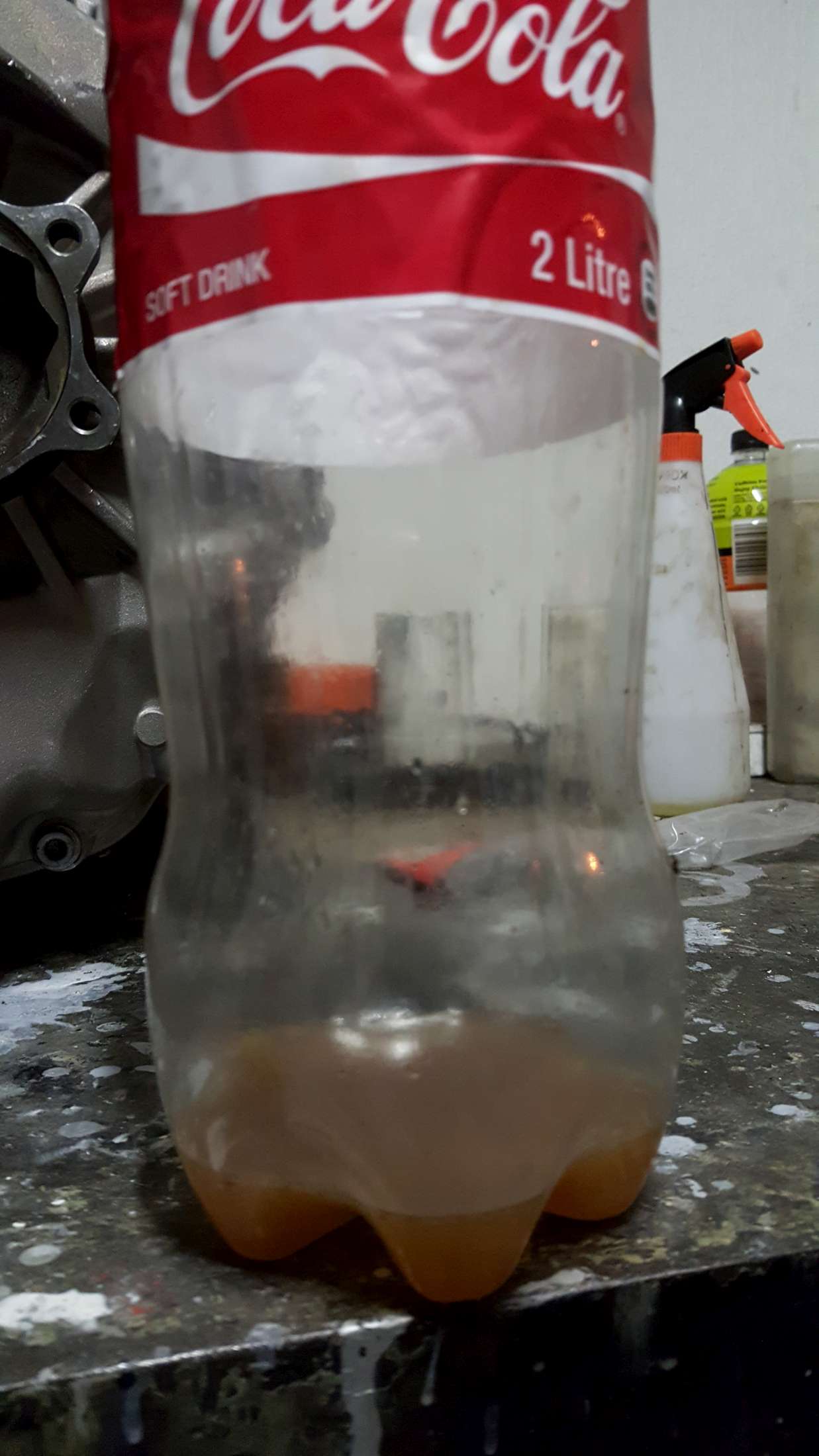

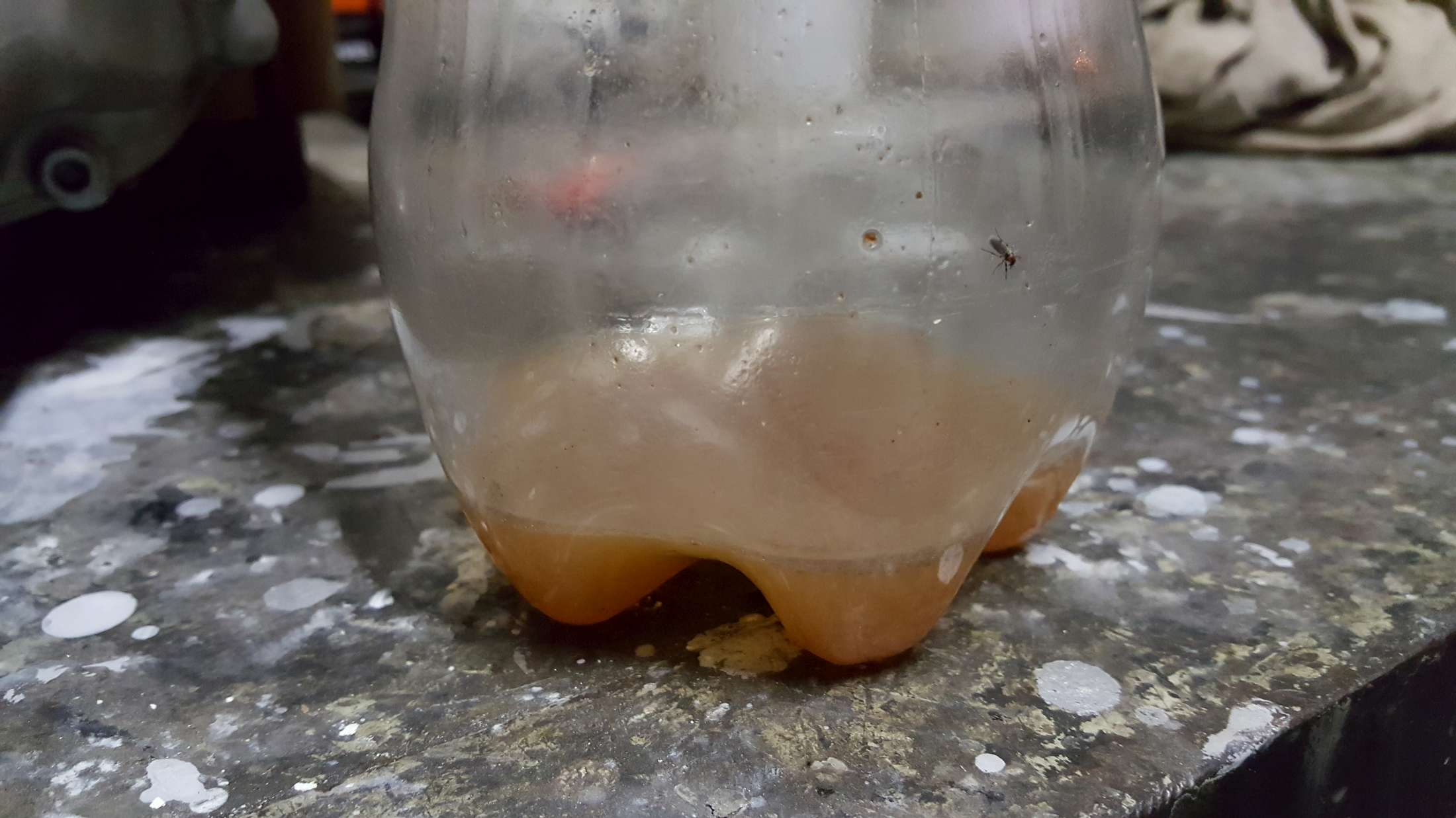

Ok so just to keep this thread updated, I removed my fuel filter and housing over the weekend and drained the content so see what was in it....... I was quite surprised to find 70ml of water inside the filter as well as allot of dirt. So I think I had allot of restriction in my fuel filter which wzs creating the problem I had.
While the bonnet was open I uped the fuel a bit and set the turbo actuator to 0.95bar boost.....it now pulls like a train!
- 20151031_201336-2200.jpg (140.97 KiB) Viewed 4314 times
- 20151031_201244-2200.jpg (171.11 KiB) Viewed 4314 times

Wow .....That's a fair bit of water !!
I suppose one just needs to fill up with one "bad" batch of diesel, from a supplier who's tanks are running low and there you have water in the system.
Do you think if there is a bit of water that gets forced through the system ( and through the injectors ) on our old school diesels, that it will cause any damage? Obviously a hydro-lock would cause major damage. Would it damage the injector nozzles to any degree, as I'm sure that some water would make it past the filter if it was that full.
- Been thanked: 432 times
Re: TD42 Lift Pump
Cedric, I dont think the water will cause any damage in the engine. Like you say the engines are old school and has nothing fancy.
Hydrolic lock will be very unlikely as it injects very small amounts of diesel at a time.
Worst case the injector tips might get some corrosion but even that is very unlikely on our engines unless it gets so much water in it that the pipes are filled with water right to the injector tip.
I know on the modern common rail injectors water can have an effect on the injectors
Re: TD42 Lift Pump
Forgot to mention, I changed the filter in Namibia in June when I had a similar hesitation and suspect the water must have come from there. I have also done the river trip with the same filter so it has been used well.....
