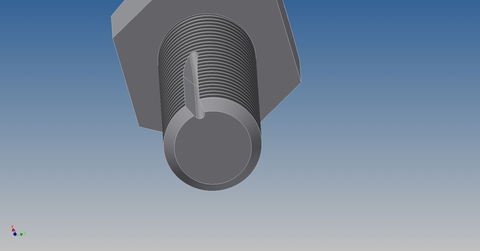

They are definately M14 x 1.5, unless somebody has somehow modified it.
But if there hasn't been anything in those holes for many years, then the thread can be very dirty, preventing a bolt from going in.
You can try two things:
1) see if you can hire a tap.
2) modify a bolt into a "temporary tap". Cut a groove into a bolt with a cutting blade on an angle grinder, going against the direction of turning, if possible harden it, and use it slowly and with lots of oil.

Peter - thanks again.
The bolt thing worked a treat. Gathered the threads in the nuts must have been fairly gungded up (they really didn't look so).
In any case, cleared threads with the "cut bolt" above, and plenty of oil. And fitted my right-hand recovery point last night. Nice to have the job completed...
