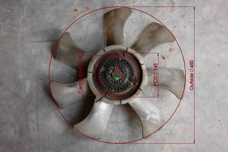

Would anyone know what replacement fan can be used for a TD42, only the fan part and not the viscous. The fan cracked next to the blades, its still working but want to replace it. Nissan dealers say they have to order it from Japan and not sure if how long it will take.

Try AutoFans down in Cape Town, if I remember correctly. They supply almost every thing needed for cooling.

Try these guys.
www.autofans.co.za/

They will need these measurements.
These are for the 4.5. Please measure yours.

Yip..... when I was down there in December I got the address from Frans ( tour de Frans ) and bought a new viscous and fan blade. It was a fraction of what Nissan charges. Take the old blade with to make sure its the same as there are a few different types apparently !!..... or measure as above pic
