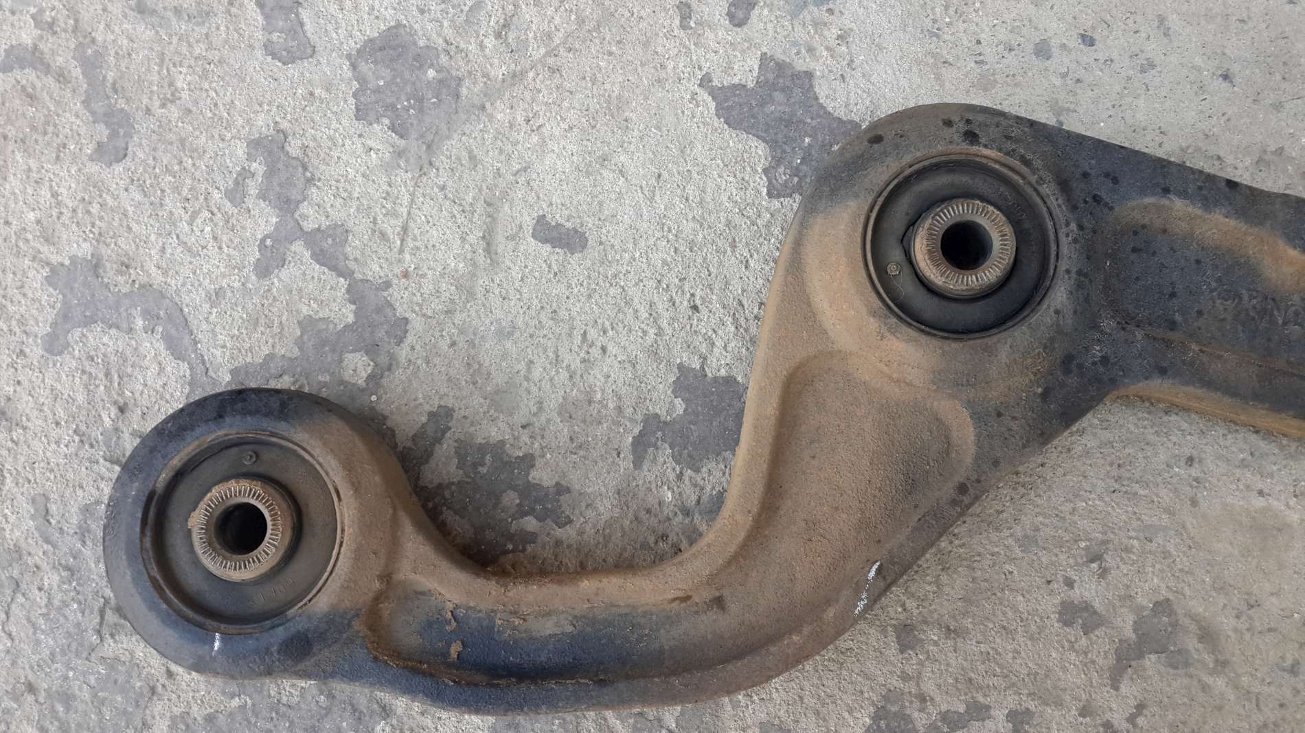

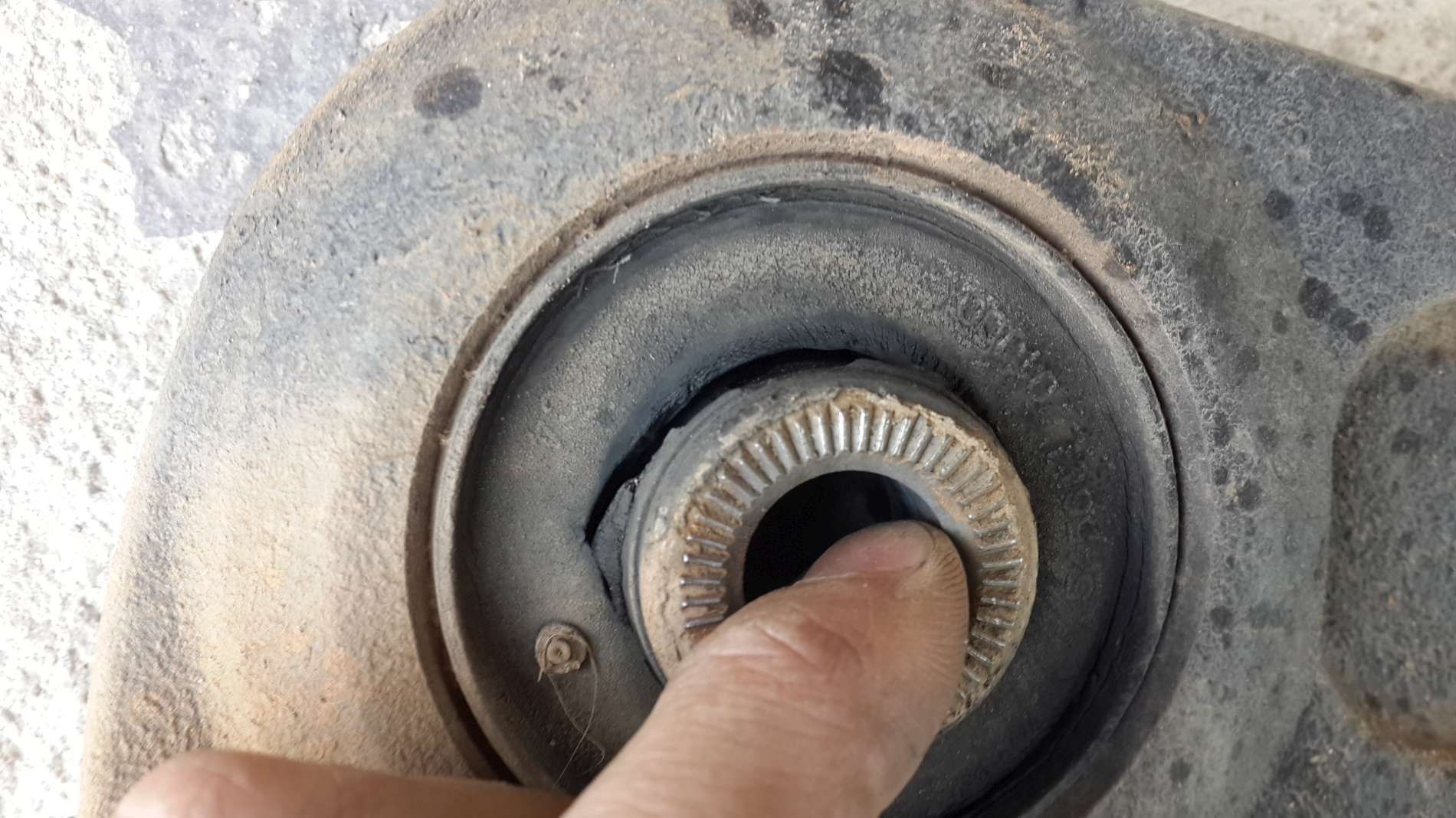

On closer inspection after removal you could clearly see the centre bush has completely broke loose from the rubber section.

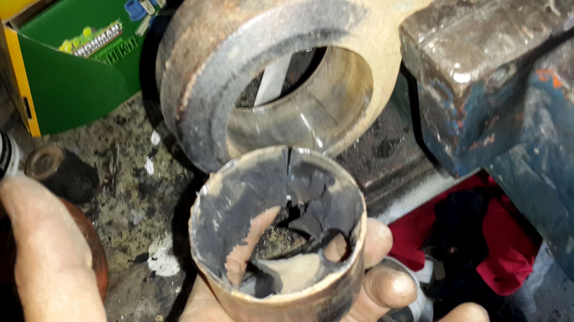

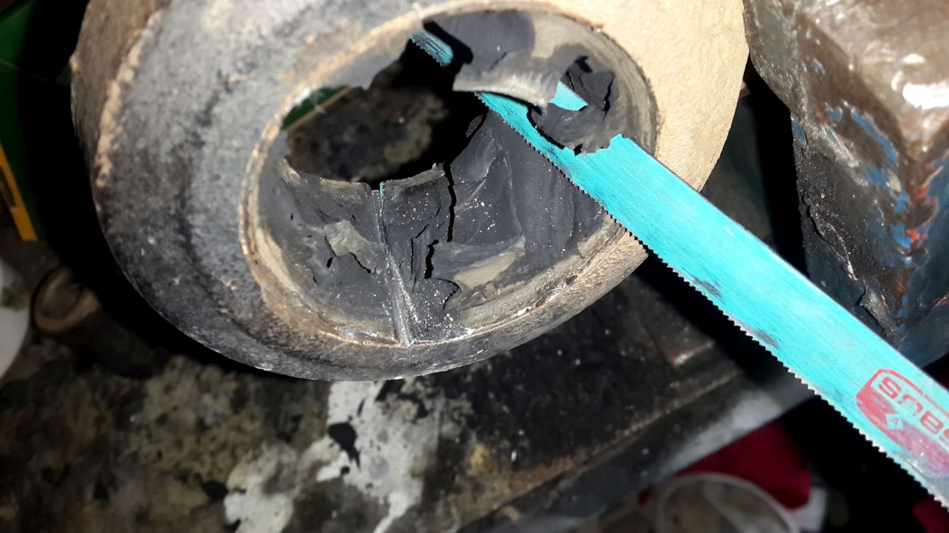

I don't have a press to get the old bushes out, but there is a old trick that is very easy to get them out. Just drill some holes in the rubber to brake the centre piece of the bush out and then use a normal hack saw to cut through the bush. It then comes out very easy using a chisel and hammer.
The bush removed

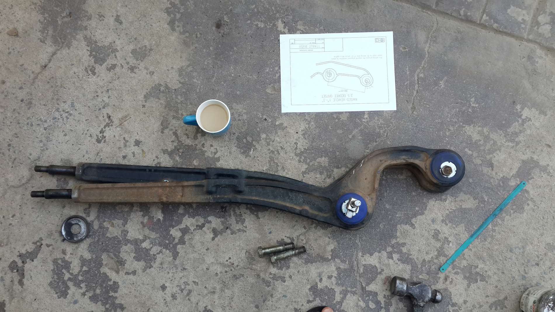

Once the bushes were removed I sanded and cleaned the holes and then simply installed the new ones as per instructions on the Ironman website.
here is how the new installed bushes comare with the old standard bushes.
The really hard part of this excersize is to mark the radius arm directly under the bolts 90deg with the ground. You use these marks to install the new bushes.
