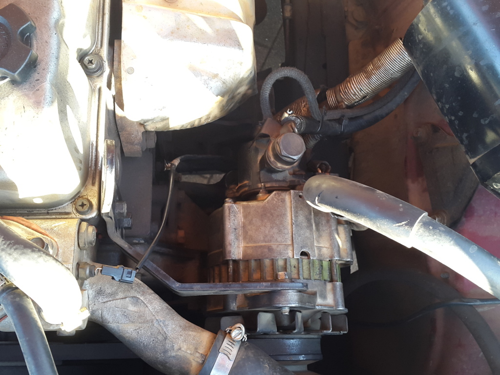

Re: Alternator - 4.2 diesel GQ
front view
- 20150320_072033 (FILEminimizer).jpg (314.46 KiB) Viewed 5136 times
