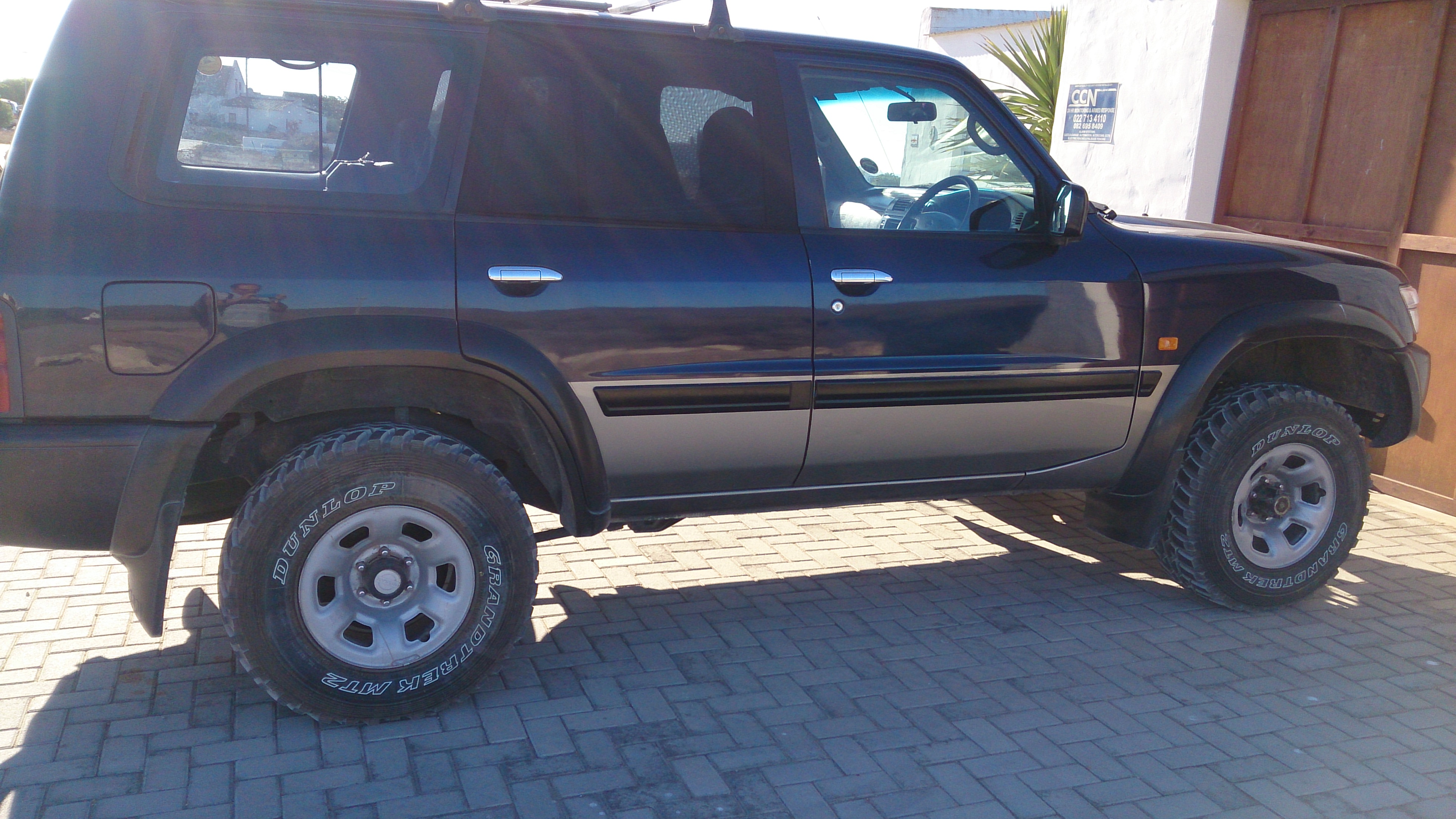

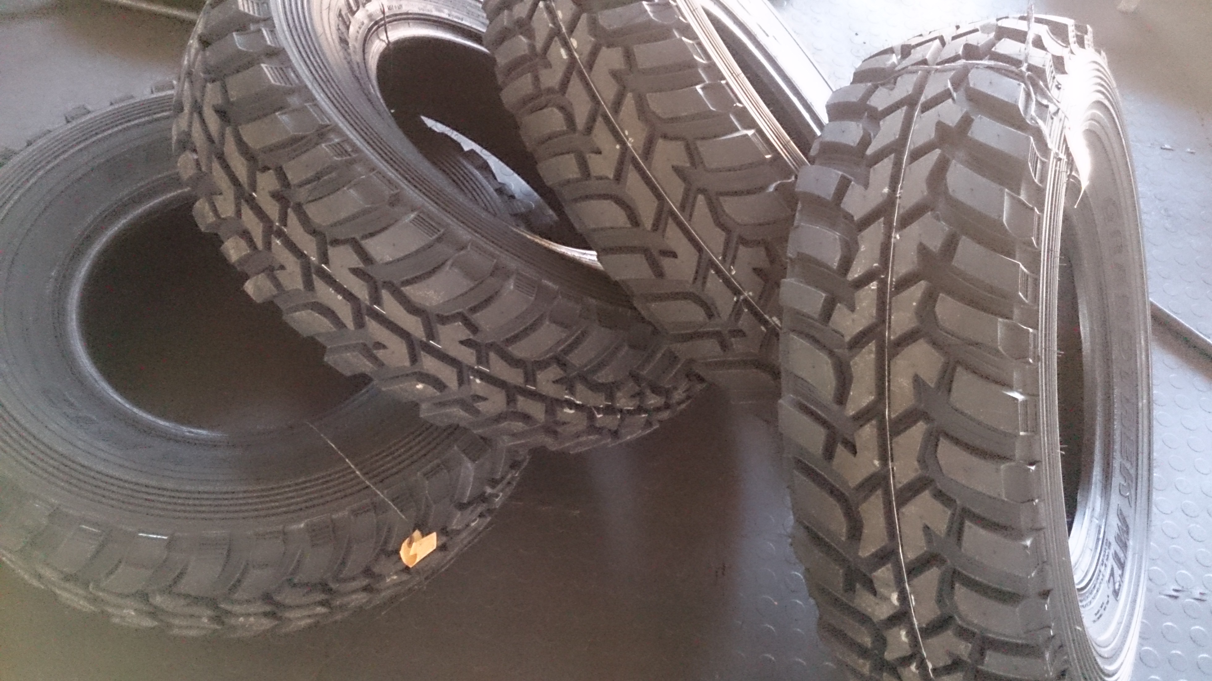

Cedric I was off the same opinion until recently, not sure if I have changed my mind just yet. In January I ruined a sidewall on my Khumo AT's. I bought my trol with them on so I had no idea of age or mileage etc, but they were also starting to perish. The spare was a BFG so I decided not to mess around and get new tyres.ricster wrote: The only tyre I really hope you DON'T put on is a Dunlop........![]()
.... want dunlop hy hier and dunlop hy daar.....
Since I'm still considering swapping the 4.5 for a 4.8 I didn't want to spend R3500 per tyre only to see them being driven off by someone else! So I found these Dunlop MT's. After going through a rollercoaster of emotions trying to decide I went for it. I have driven only a few hundred km's so far but - the wobble I experienced at 90-110km/h is gone, the vehicle pulling to the left permanently is also gone. Both symptoms I have given up trying to rectify after deciding they must just be a trol thing.
Like I said I have not yet changed my mind about Dunlops, but so far these have done pretty good trying to convince me!

Re: Patrol Pickup 4.2D Tyres......advice?!
Hmmm.... not bad looking tyres !!!
Let me be fair.... I did have a LOT of problems with Dunlop tyres that were fitted to a variety of vehicles I drove many years ago ( normal road cars and light delivery vehicles ). I hope that over the years their technology has changed and improved. I am just too apprehensive to try them again on a 3 ton vehicle. So please before you swap for the 4.8, give them a run on and in various conditions ( wet tar, dry tar, mud, gravel, sand and rock ). I think it would be very interesting to hear about the differences.
But I have another question, you said you had the Kumho AT's on your Patrol? I'm thinking of going the AT route on my next set and was thinking about trying the Kumho's as the Kumho muddies were for me fantastic. I am especially interested in their wet tar capabilities ( I understand that old worn tyres are not the best on any vehicle ) during the course if the tyres life?
Cedric apart from the ruined sidewall that I got while doing the Paradise 4x4 trail (where Fugly is) I got pretty good service out of them. Like I said there was a wobble and an urge to forever drive of the left hand shoulder, but that might be because of the age of the tyres. Physically the tread is not as aggressive as the BF AT's and the top edge of the sidewall that forms the bubble when deflated is also very mild. I am not sure if they would be my first choice in an AT.
Something else that I must mention about the Dunlops is that they are remarkably quiet for a muddy.
