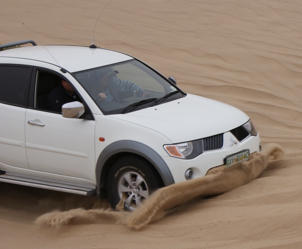

I've done the 4 day trip to Saddlehill with my brother in his standard Prado 4.0L V6. What a trip!! The vehicle was too low and the suspension didn't exist. We got 3km/L at best. The driving is very tricky, and you need to let go of your fear to "storm 'n duin". The guide will tell you to "PLANT HOM!!" Which translates to trap die kak uit die ding uit. We realized that the V6 performed best at 5500 rpm. And you drive like that dune after dune after dune. It is really hard on the engines, so make sure yours is properly serviced and that your fluid levels are in order.
Take some diesel engine oil with, because they work hard. We had 2 Tritons in the group, and they did well, but suffered from sand clogging the air filter. Take a set of fan belts with. And fuel. There is really nothing there. really. The Patrols do well in the sand, because they got power. They do not allow non turbo'd diesels and X5's BMW. Our guide had a grisly experience with a Disco 3 V8. One of those that they left behind to get out later. if you don't have a suspension upgrade, get one. It is the single most important upgrade you can do to a vehicle. .
This is what it looks like to "storm 'n duin". Okkie in the Triton making landfall in his Triton. Note the deceleration on the CB antenna...
