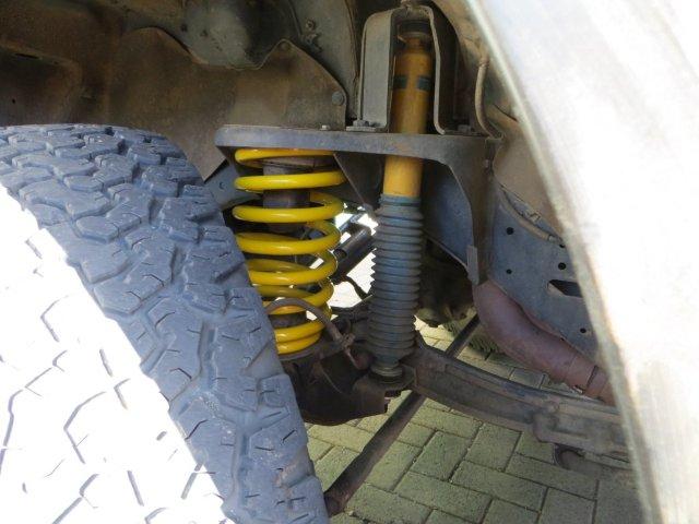

I have Bilsteins on my Patrol. The part number I got from the SA reseller is 24060431 (Front) and 24060448 (Back). These are the B6 model. They a mono tube shocks and I am very happy with them. Just make sure about the lift. I was told that we can only get shocks for 2" lift and less. I have a 1" lift on my car. You can see the shocks in the back of the picture.
