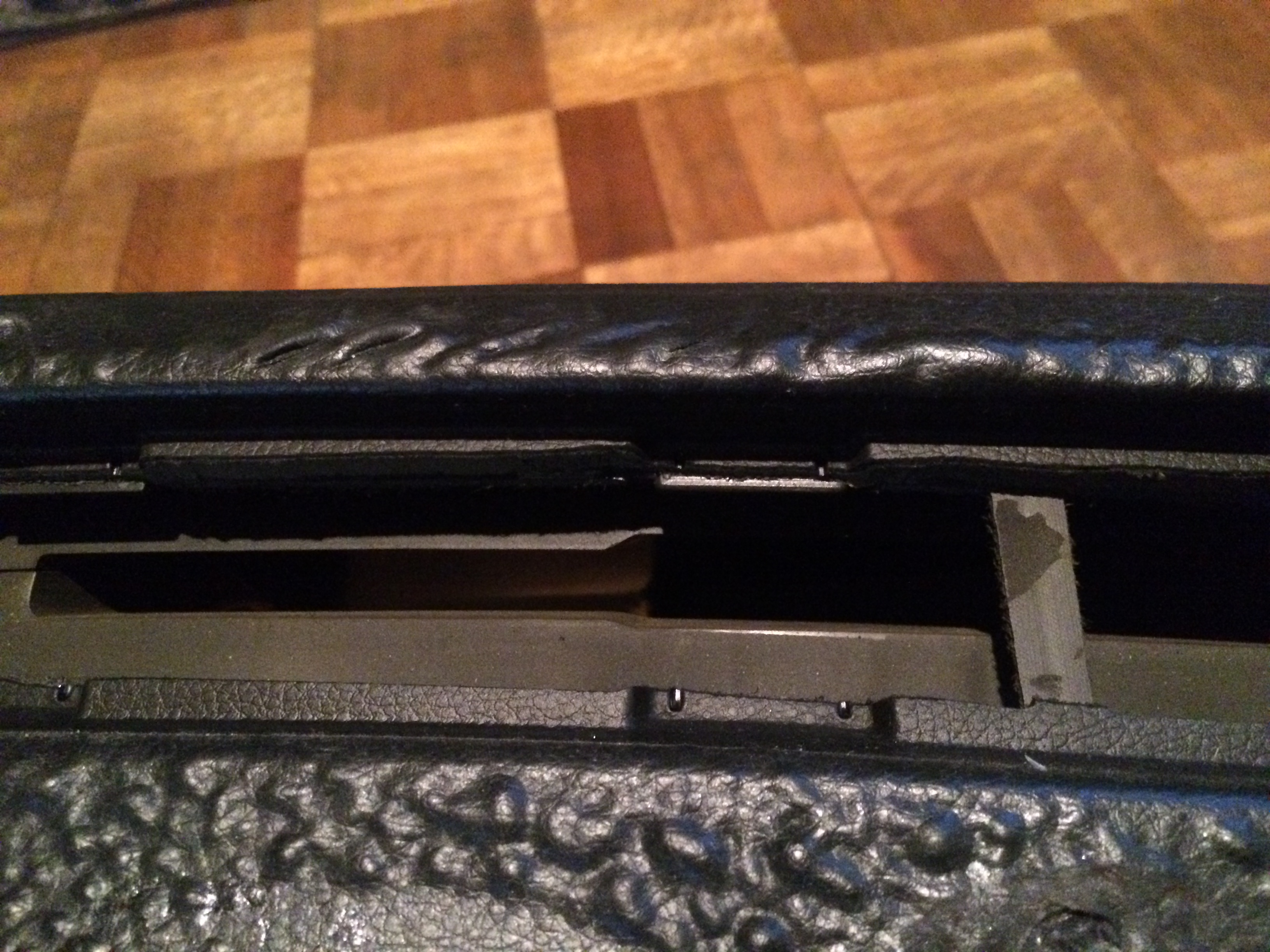

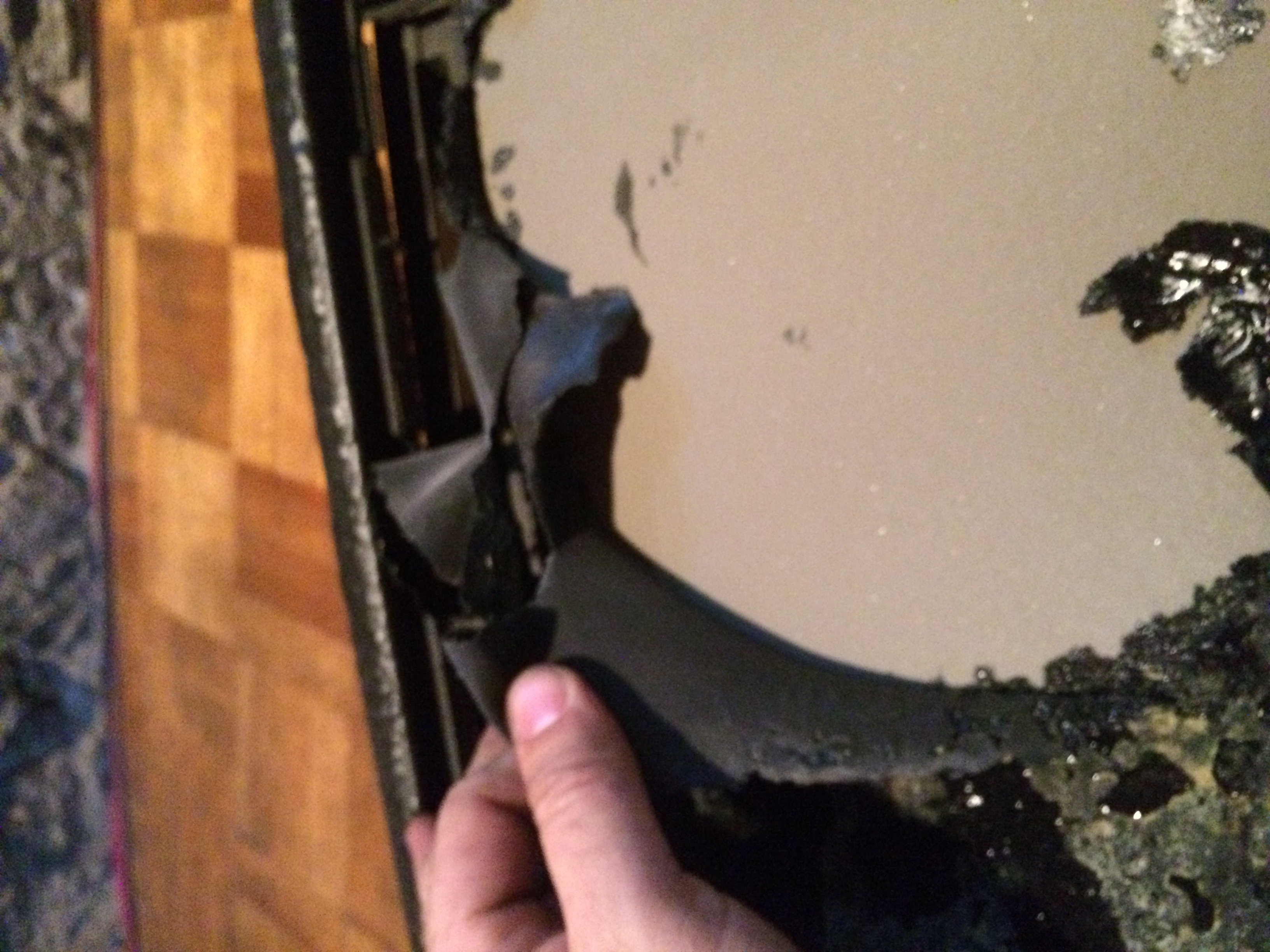

I recovered the dash, take time , materials into account i will most likely get it done next time. However I will still prefer to remove to get it done.
I was able to peel off all the fake leather material, there was 3 places where I filled tiny imperfections with some foam I had. I find it amazing that the original literally just peeled without any of the foam substrate sticking to it.
I've added 2 pics, one of the bubbles and one how I peeled the existing covering off
