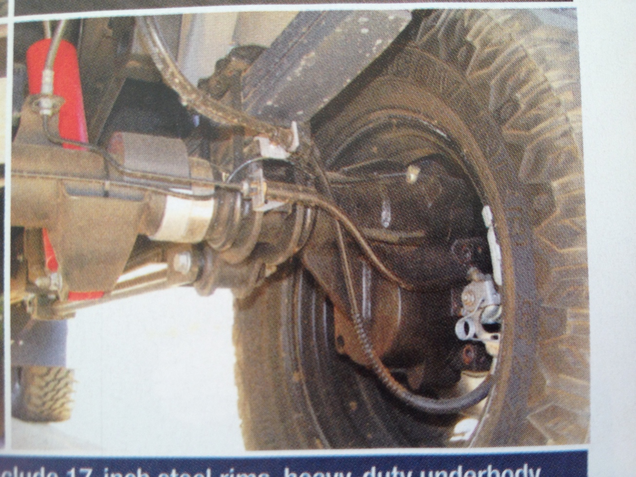

This one sports reduction gearboxes housed in the wheel hubs.
I must be ignorant, but I have not seen or heard of this before.
Below is a picture from the magazine
This is the first time that I know of, of a way to improve clearance of the solid axles, other than larger tyres of course.

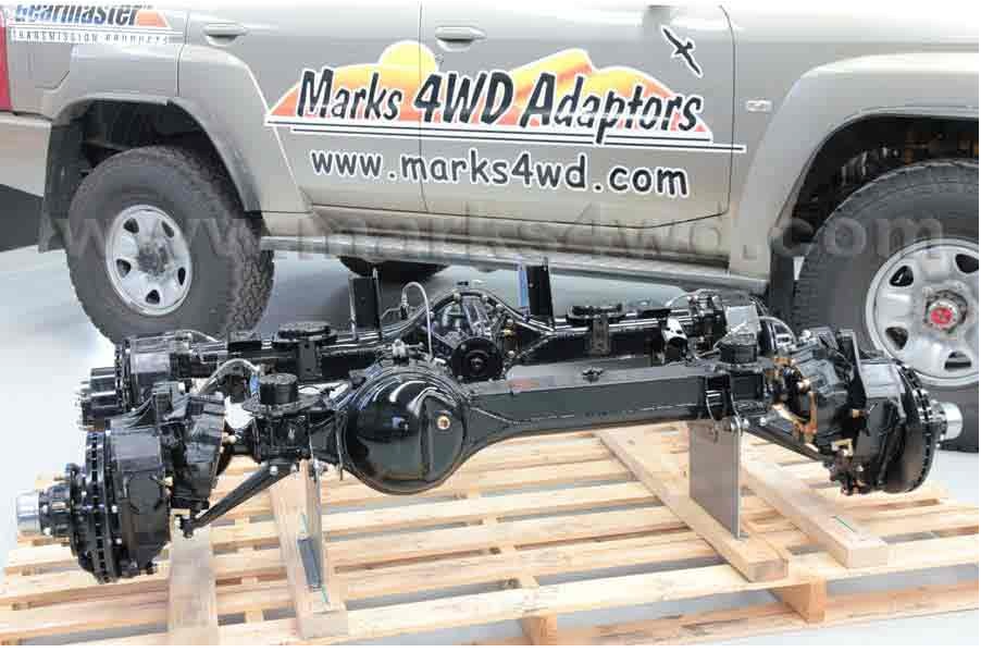

So after seeing this, I did some googling and found that Marks4wd in Australia seem to do this for Patrols!
http://www.marks4wd.com/mfk1750gq.html
Pity, I live in the wrong country and I do not have money either...
I have not found any commentary on this by users yet, such as the Patrol Oz Forum.
It inevitable makes the wheel track wider, but a big advantage must be the extra clearance of the solid axles, and no suspension complications from the lift either.

The MArks axles seem very good, and I wish I had the money to buy a set. As far as disadvantages go, there are a couple: firstly, it does raise the vehicle a bit, so clearance in low garages etc comes into play. I understand it's about 100mm. In terms of stability though, the lift is more than offset by the increase in track, but this increase in track means that you struggle more on tight tracks, particularly as our cars are already among the widest. The other drawbacks are that they are a bit noisier (apparently no more than a set of muddies), that you need to run 17" wheels to clear the hardware, and then the big one: price and shipping.
Advantages are a real increase in ground clearance and a gear ratio better suited to larger tires (giving even more ground clearance) without changing suspension geometry and driveshaft angles, and by all accounts improved strength. Probably therefore they are better suited to a serious trail machine than to a general overlander, and the cost in Rand is going to be very hard to justify (if you are one of those people who have to justify money spent on your toys).
